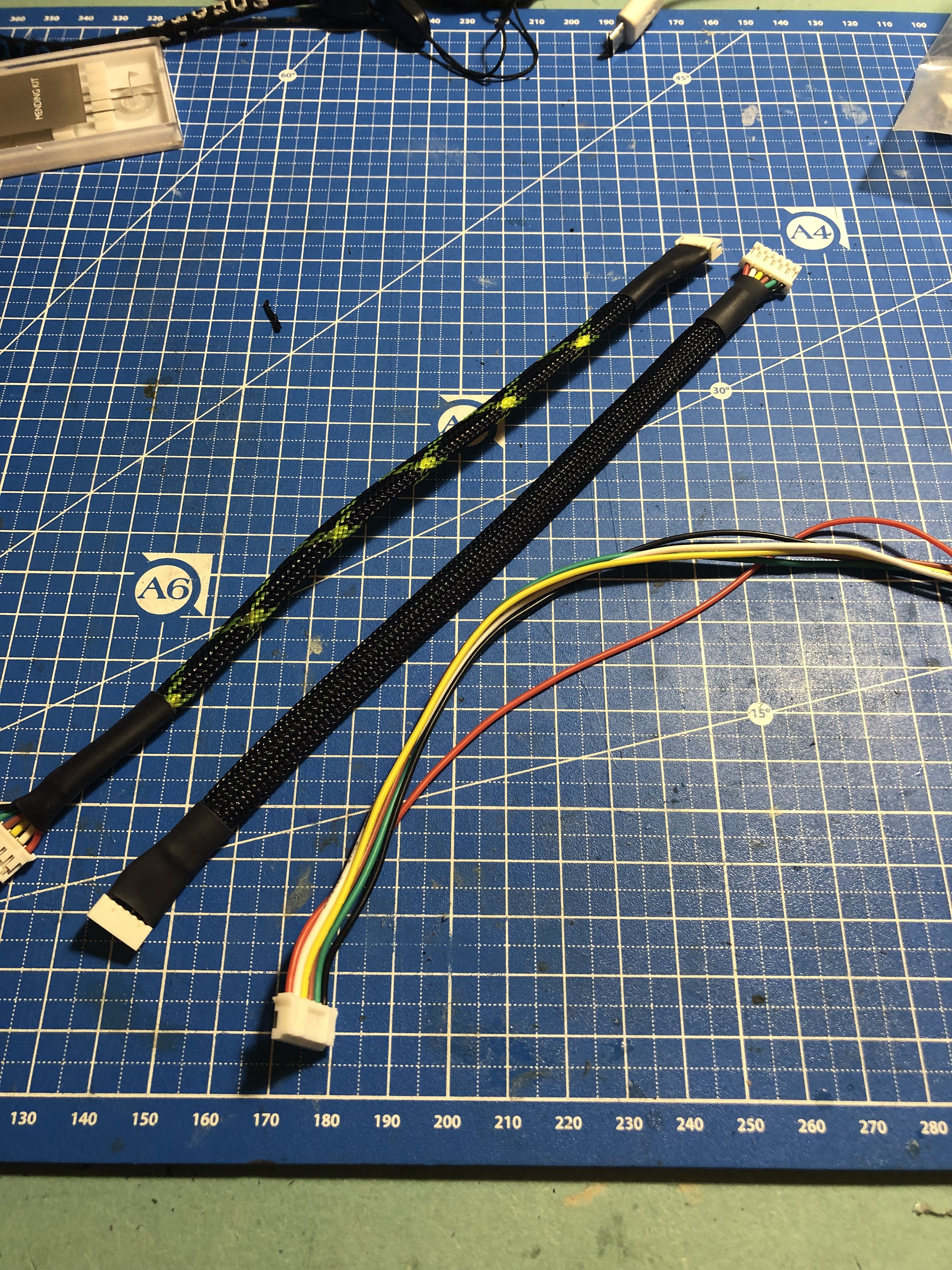

Also, id like to buy some of those JST plugs and wires you were selling a little while ago. Do you still have them for sale?

I‘m just about to make some for an other guy
20cm left over 10 maybe. The 60cm sold out.
Sent me a pm what you need than I can sent them out with the other packet

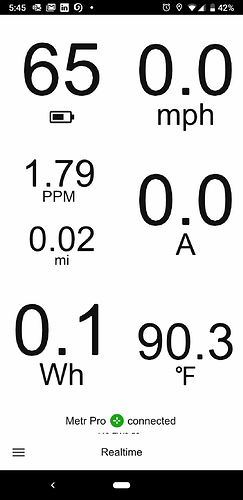

I got motor stutter from flipsky6.6 dual plus with dual tb6374 190kv. Does this metr record have anything unusual?

I don’t see anything but did just notice you can add ppm to the real-time view by editing the layout (I also upgraded my metr and VESC versions before data showed up in there but just updated both in app using the gear icon in the settings tab next to the module name). Maybe can add that and try to monitor while riding (doesn’t appear to be added to the logging yet but could imagine this is coming @rpasichnyk?)
