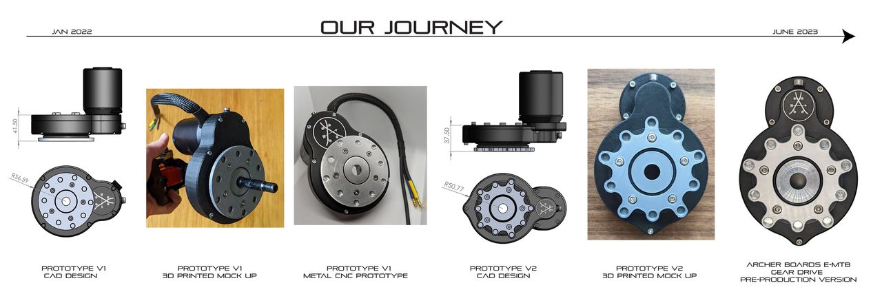

When I set out to design my own electric mountain board gears drives, I thought it would be a quick and easy job I have a PhD in Electronic Engineering, how hard could it be to design some helical gears to mesh together, right!
Sadly, I was wrong, I started designing my first gear drive prototype in in early 2022 and after going through multiple 3D printed and metal CNC machined prototypes, and 1000s of miles of testing in hard terrain and weather conditions, I have arrived at robust final design that I’m very proud of.
I have maintained a public build log of for the gear drive development, and the amazing electric skateboard building community at esk8 News has had a lot of input into every step of the design process based on shortcomings they have experienced with existing gear drives. If you’re interested, you can see the entire journey here on the esk8 News Forums.
I’m going to continue this development philosophy going forward, all Archer Boards products will continue to advance and improve with input from the community.

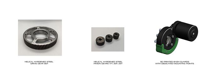

  • Hardened steel all metal gears with 15mm face width: never break a gear tooth again! We expect these gears to outlast your board.
  • All metal construction: The majority of the components are machined from 6061 aluminium.
  • Bash guards: all gear drives come with ABS plastic bash guards to protect the gearbox casing from hard impacts.

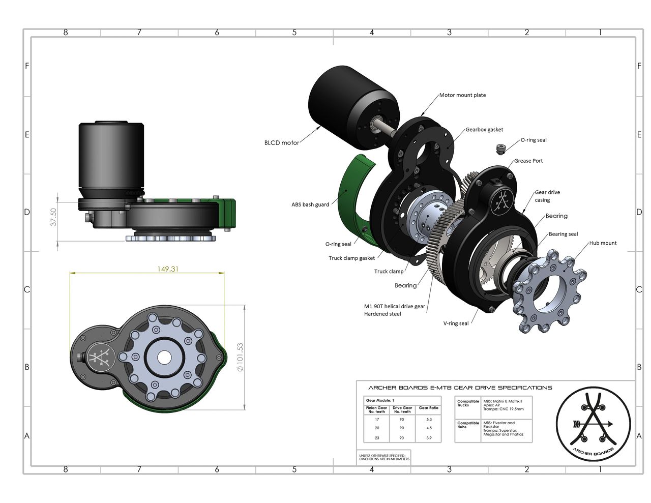

  • Compatible trucks: MBS Matrix III, MBS Matrix II, Apex Air, Trampa CNC 19.5mm
  • Compatible hubs: MBS Fivestar and Rockstar; and Trampa Superstar, Megastar and Phatlaz
  • Available gear ratios: 5.3, 4.5 and 3.9
  • Gears face width: 15mm
  • Gear material: Hardened steel
  • Compatible motors: Any motor with an 8mm shaft, 44mm diameter M4 hole pattern, up to 100mm long.
  • Weight: 683g (including everything even screws)
  • Dimensions: See drawing for details:

Could you explain why you feel that using thrust bearings on a helical gear setup is bullshit?

a thrust bearing on the pinion can be a good design, imo it is not needed
I have been taking a look at thrust bearings when i was working on a bevel gear drive but i found that most of them are only rated for about 3000rpm? (I cannot remember exactly) I could be wrong though but the ones i found that did spec higher were usually pretty expensive.
I’m glad your PhD has helped you. im struggling, to understand how you have dealt with the axial loads.
I guessing the hanger part could act as a bushing increases material were but simplified parts can increase life span have you got the material coefficient calculations to show this?
What about the particles and extra heat that will accumulate in the grease how did you compensate for that?
What motors do you recommended that are suitable to taking the axial load your design will impose on the pinion gear and thus motor bearings?
Are you clocking the helical gears in opasit directions or are the unit interchangeable from left to right?
Are both your gears the same grade of hardened steel? Same hardness?
It’s not as simple as that as the slave gears are much smaller than the pinion gear reducing the mech. this in turn increases where in tear so it’s giving and taking just not sure how much by. Also requiring the mesh at a higher tolerance is critical for the load to be shared equally it will increasing where in tear defeating the objectives if not perfect.

Thanks, mate a lot of work went into designing and testing these drives, and I’m proud of the result.
If you’re looking for cost effective and robust gear drives for mountainboarding, then I would say if your based in the US, it probably makes more sense to go with Boardnamics due to import tax and shipping reasons, but if you’re based in the UK/Europe I would hope people would consider purchasing my E-MTB gear drives.
There are a lot of differences between my drives and Boardnamics drives, I think mine are bit more refined, but I don’t want to turn this into a pissing contest, compared the specs and make your own decisions.
If you have large budget for your E-MTB build and you want to save all the weight and width you can then go with Apex Jump drives, they look like a quality product. There not a little bit more expensive though, there £100 more which is significant.
Thanks mate :grinning: I’m a qualified as EE, but I work on lots of electro-mechanical products for my day job involving electric motors and drivetrains. I have lots of ideas for other esk8 related products, stay tuned for updates.
