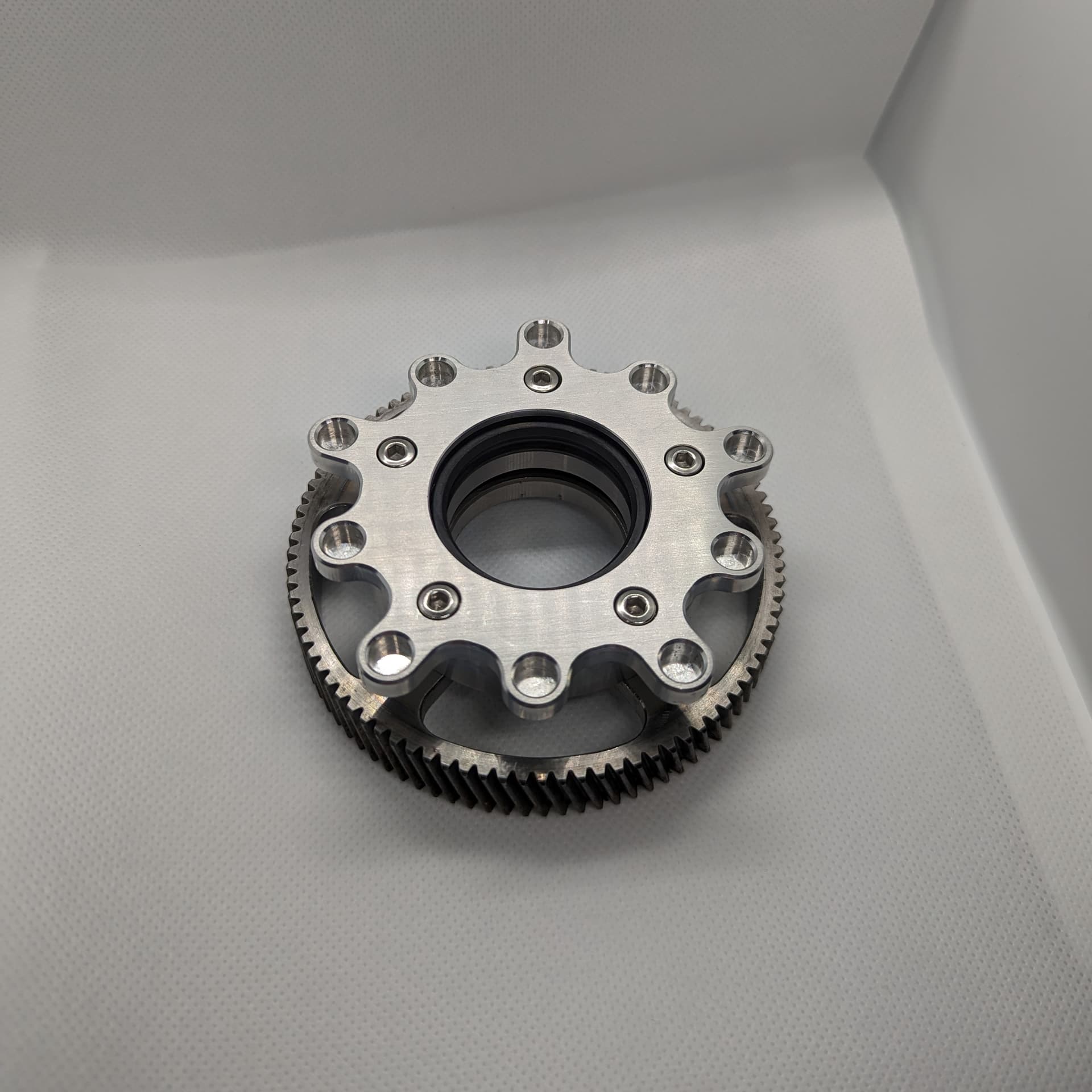

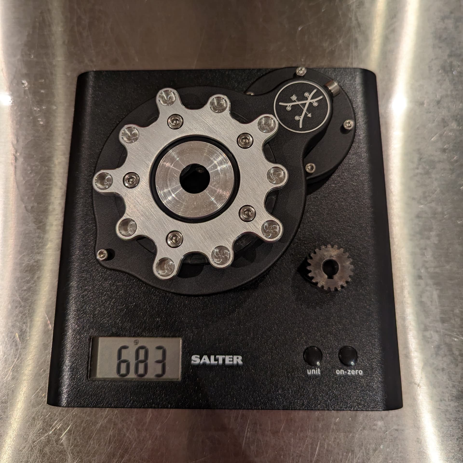

My primary design goal was to produce a gear drive that was robust enough for mountain boarding, an RRP of ~£300, light weight, and have steel helical gears that you don’t need to periodically replace.
I did actually build a version of “Prototype V1” with annular contact bearings and thrust bearings to cancel out the axial force from the gears, but it turned out to be expensive, heavy and noisy. My solution to this problem was to use 15mm face widths and a modest helix angle, this results in axial force that can be handled by deep groove ball bearings and a Loctite 648 retained pinion.
Having 15mm of face widths provide enough surface area for the Loctite 648 to effectively retain the pinon, if you used thinner gear face widths then you would have be inventive and use thrust bearings or other methods to deal with your axical forces.
So, I’m not saying thrust bearings are bullshit, they have their place in some situations, but I think they are unnecessary for this design.

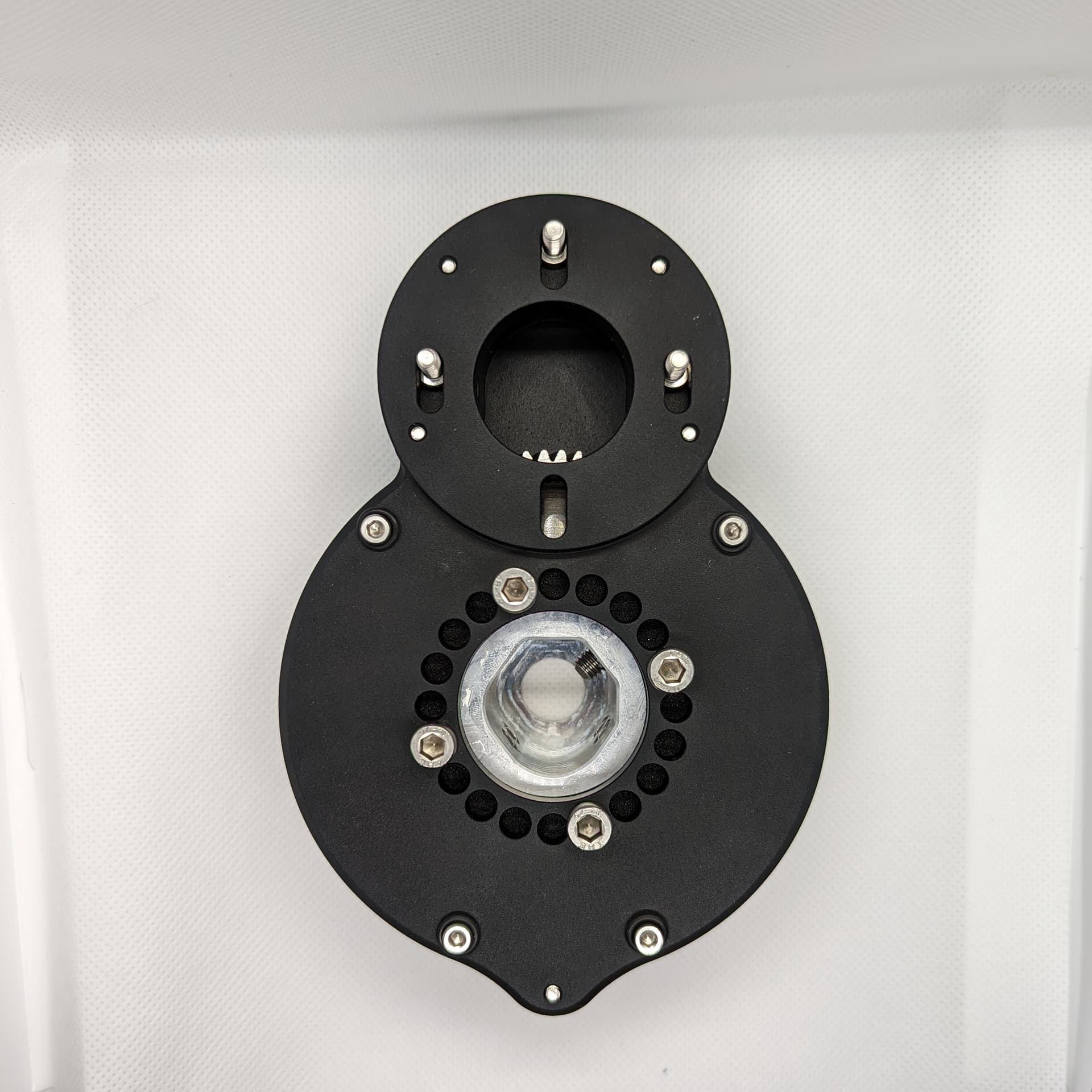

There are a lot of differences between my drives and Boardnamics drives, maybe look a bit closer at the drawings and specifications. Here are some key differences:
  • 15mm face widths
  • Two support bearings
  • Integrated bash guard mounting points
  • Grease port
  • Sealed from water and dirt ingress
  • Novel hub mounting approach
Exactly! yes, it helps, with pinion bonding massively. There is also better tooth engagement for handing high torques and helping with wear.
My drives have steel gears with 15mm face widths, this provides enough surface area for the Loctite 648 to effectively retain the pinon, I don’t know what the face width of Boardnamics drives are, but they look thinner than 15mm from the product photos.

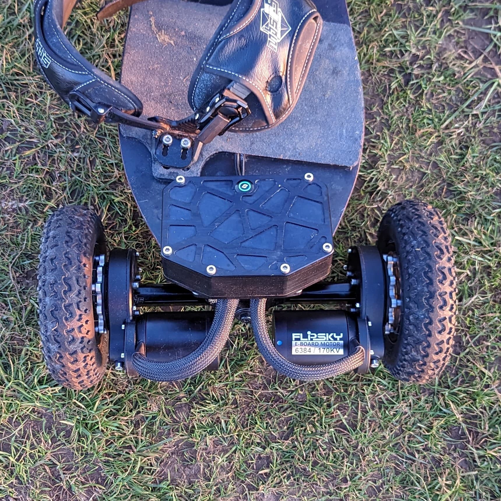

I been using the “Prototype 2” drives on my mountain board a while now, and I’ve had zero issues and I’ve thoroughly abused them. A lot of the time I’ve seen people have issues with retaining compound is when they have tried to use an alternative to Loctite 648, or not applied it properly.

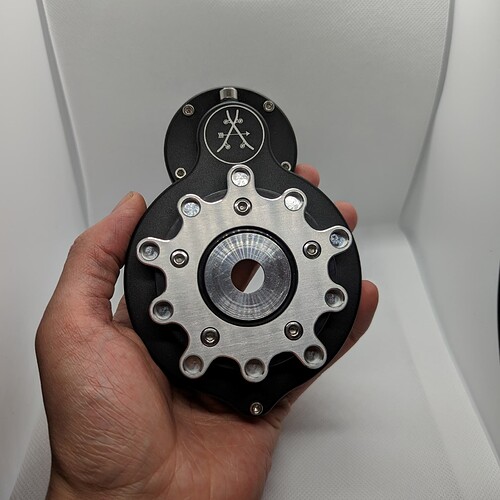

It definitely a real product, not just a 3D render. “Prototype 2” is the latest design and I have been testing it on my mountain board for over 6 months now, I’ve had zero problems with it and thus I feel it’s ready for pre-ordering. Here are some pictures of the final iteration:

But using thrust bearings isn’t inherently bad or “bullshit”; it’s just a solution to the axial load. I understand that your solution was to use two opposing angular contact bearings instead to deal with both directions of the axial load while throttling and braking, but it is merely another solution, not a better one. Properly designed, both of these bearings will be able to handle the axial load these helical gears bring. No need to shame the other solution just because it’s more common/different than your own.
And also, it seems like your pinion gear doesn’t have a solution for the axial load. Breaking the motor will be an issue that’s bound to happen sooner or later, depending on the rider’s aggressiveness and the motor construction quality. The pinion gear not secured along its axis in the same way as the driven gear also makes it more compromised when it comes to gear meshing and wearing.

from my quick maths a flipsky 63xx should be able to handle 145kg-290kg axial load.
thrust bearings were also considered by Etoxx, he also stated the motors are designed for axial loads
