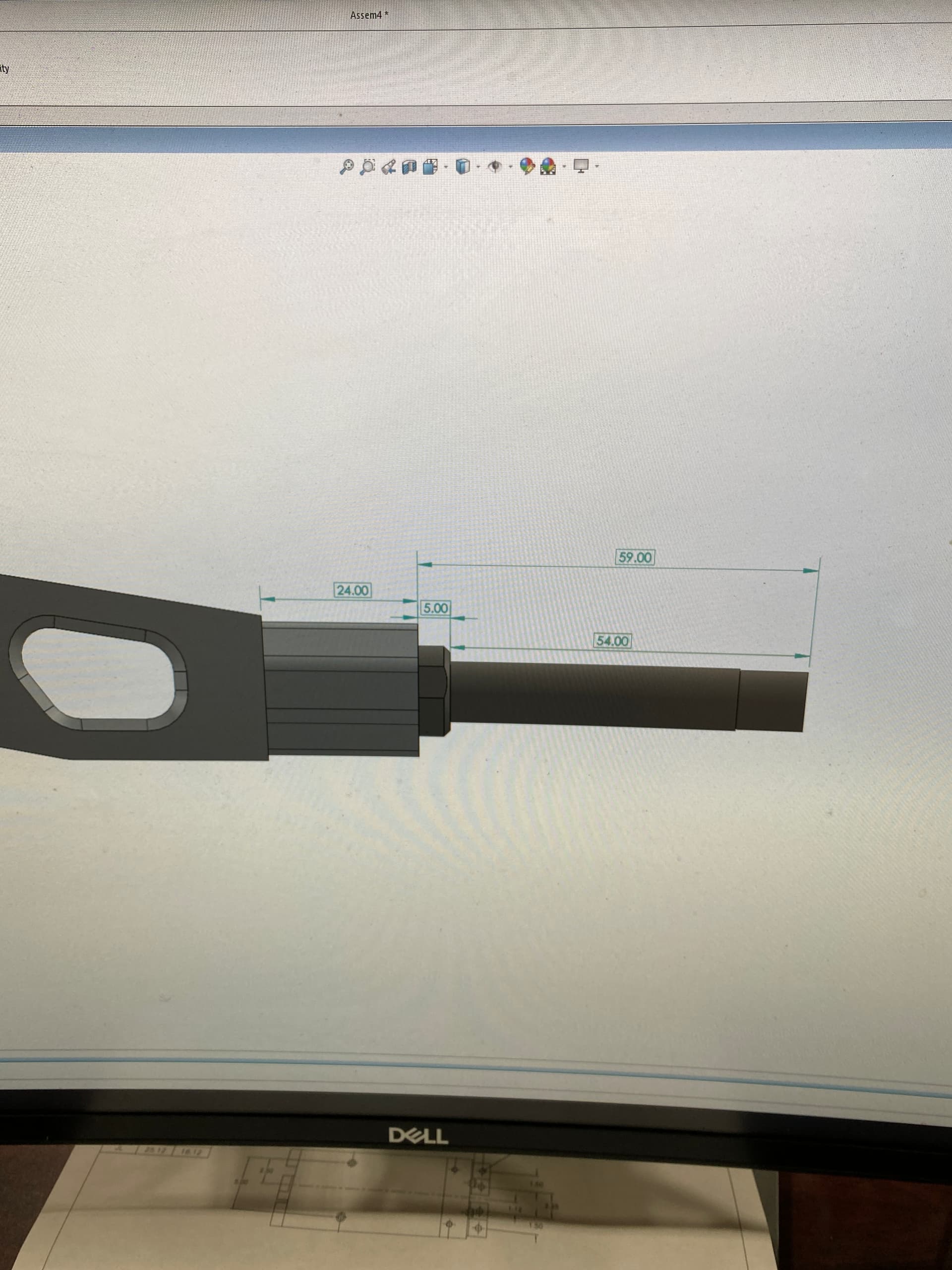

Because Apex Jump Drives are so thin they actually only need 24mm of hanger length on that profile to work so they should fit with the approporiate clamp without any modification to the hanger!
The only question would be on the length of the axles, that would determine if its feasible or not

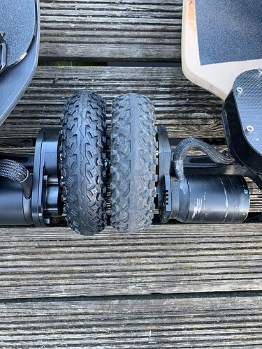

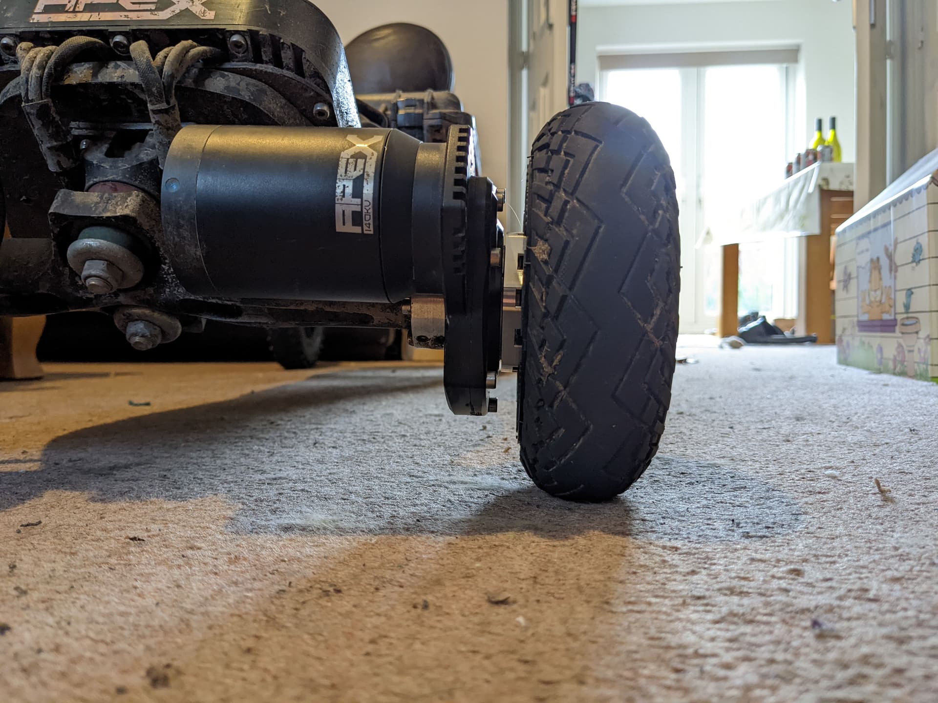

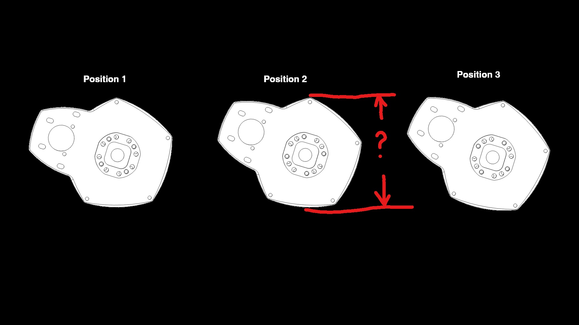

What is this dimension? Basically wondering if 6 in tires will work with these.
Not sure what position it exactly is, but here with 6". Credit Queron
Thanks, that kinda answers my question then. I didn’t see that photo.
yeah it works man. obviously not amazing clearance but useable! Are you thinking about putting these on your TKP? that would be awesome
Yes.
You can see the axel dimensions. The axel flange that tightens to the hanger is 15mm diameter. If the through hole for the adapter is to small, I can open it up like I’ve done for a few BN’s.
I wouldn’t be using mbs or trampa hubs, but I’m sure I could make a wheel adapter to suit whatever hub.

Urban Treads are 6.5", but yeah close enough; clearance looks surprisingly good! I wonder if we will get a larger version in the future for 1:8 reduction or something :sweat_smile:

Can confirm. This is with offset Phatlads hubs, with rockstar II or fivestar the tyre would sit much closer into the drive.

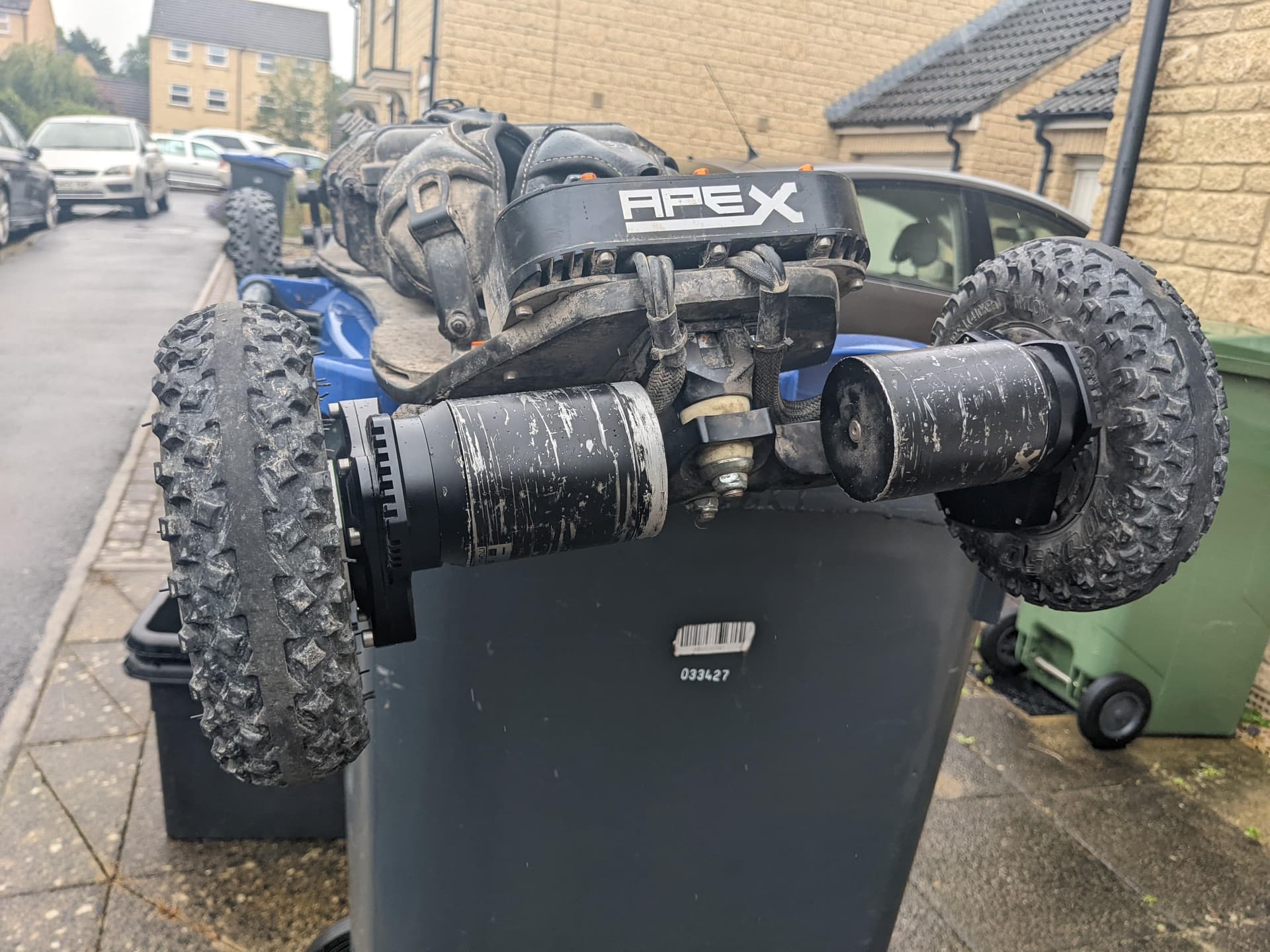

Been on a bit of an upgrade spree today but i think its interesting so ill post some pictures.
First up on the operating table was a customers early 2021 Predator.
Unfortunately it suffered a drive failure whilst he was abusing it on a pump track yesterday.
Hes been through a fair few of these gears now so decided rather than replacing them again it might be better to upgrade.

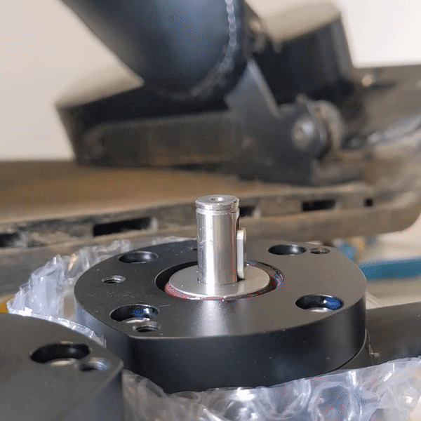

One thing to note is that his older motors dont have the circlip slots, so were fitting the gears with a good application of green LOCTITE as you would with any other drive. Shaft is cut at 24mm, this is the same length that his old drives required so nothing needed re-cutting to complete the swap.
All done, happy customer. He was keen to ride but i told him hes gotta give it 24 hour for the LOCTITE to cure.

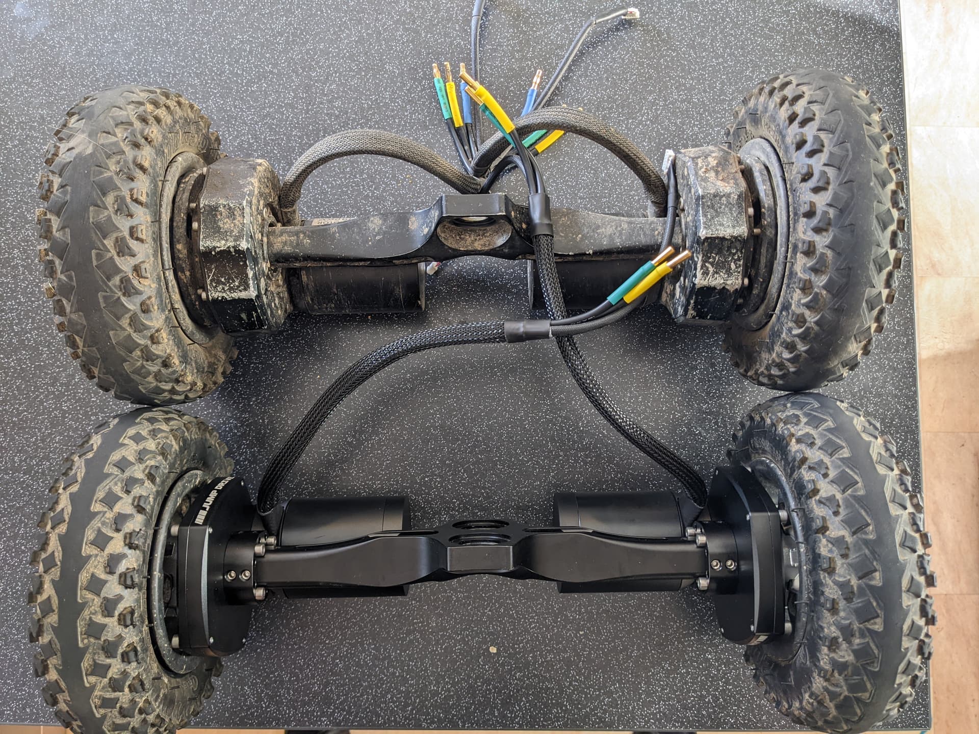

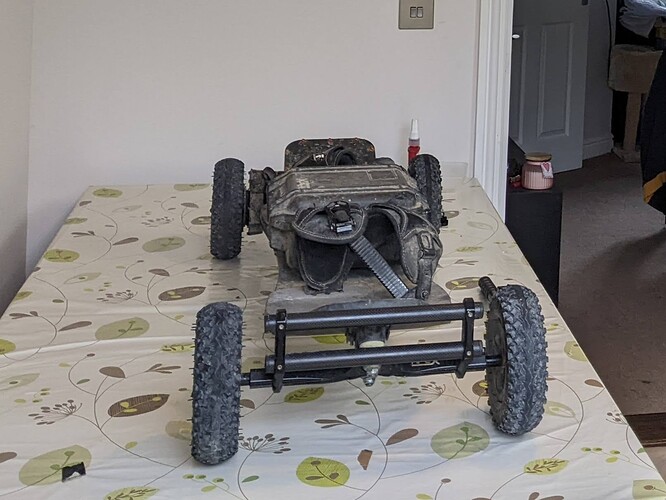

Next up on the chopping block was my early 2021 Demo Predator (I take to uk events and group rides for people to try). This also needs Updating to 2022 spec ready a few events over the next 2 months. gotta let people test drive the goods.
This one was a little easier as new motors allow for use of the circlips.
ezgif-1-73e1148f92
On this one i ended up building the drives up on a spare hanger then just swapping it out as it was much easier than working directly on the board.

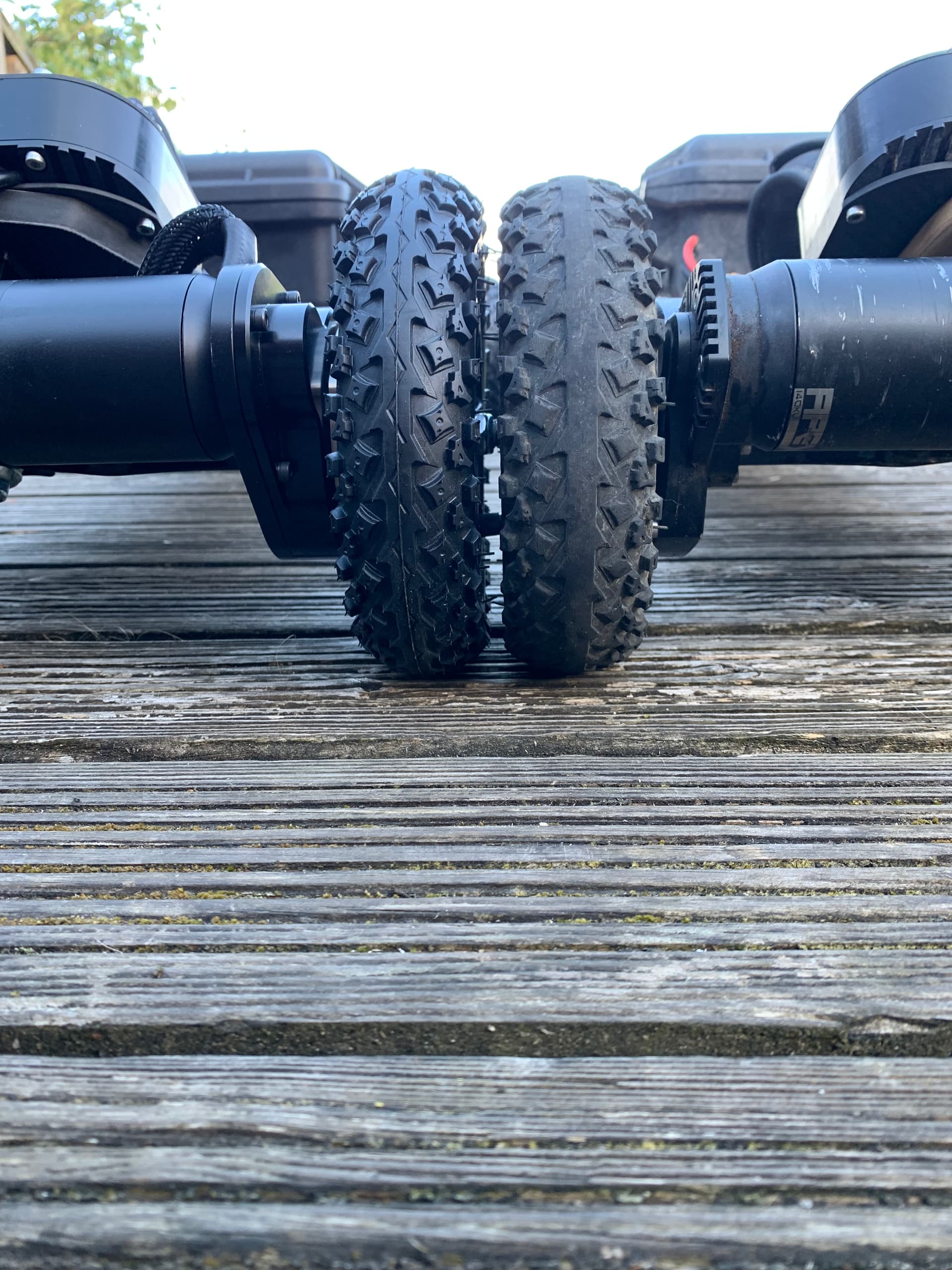

This ended up being really useful as i was able to to put the early 2021 and 2022 predator drivetrains side by side for some comparison shots.

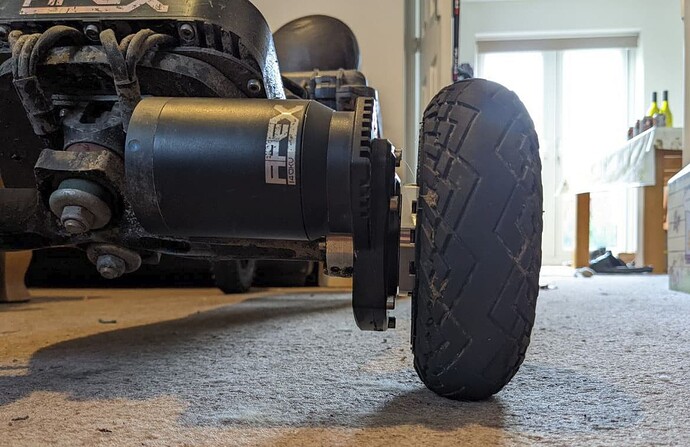

This shows the decent increase in clearance.

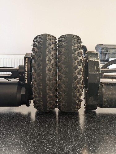

And a good reduction in width, as well as how tightly the Jump drives sit towards the wheel compared to last years drivetrain.
Finally you can see that the Jump Drives were designed to sit a couple mm within the wheel diameter on 8" tyres. This means you wont catch the drives or motors whist you drag your board around.

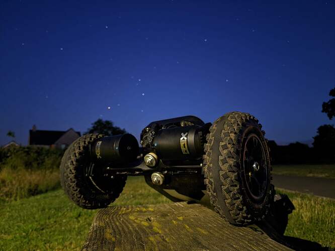

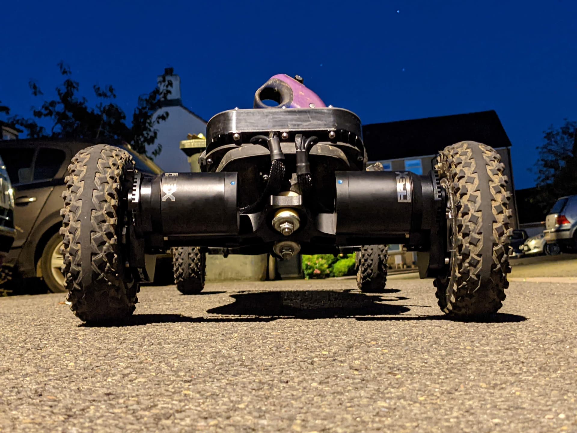

Got the hanger back on and wiring sorted then went out for a quick test ride. This board is now up to date other than the new deck graphics.
As you can see, overall clearance is amazing on this new setup. had to go take some nice photos :grin:
i see a lot of comparison to moon drives, would be interesting to some pics of boardnamics against the jump drive as they were both designed around steel gears and those were the standard option on apex boards up till recently
super dig the circlip useage.
Here you go.
As I see the motor shaft which is cut to 24mm still stands out over the pinion end, it would be possible to cut a slot for a circle clip with a dremel. :face_with_monocle: I‘m thinking about giving it a try when I have my gears in hand.
