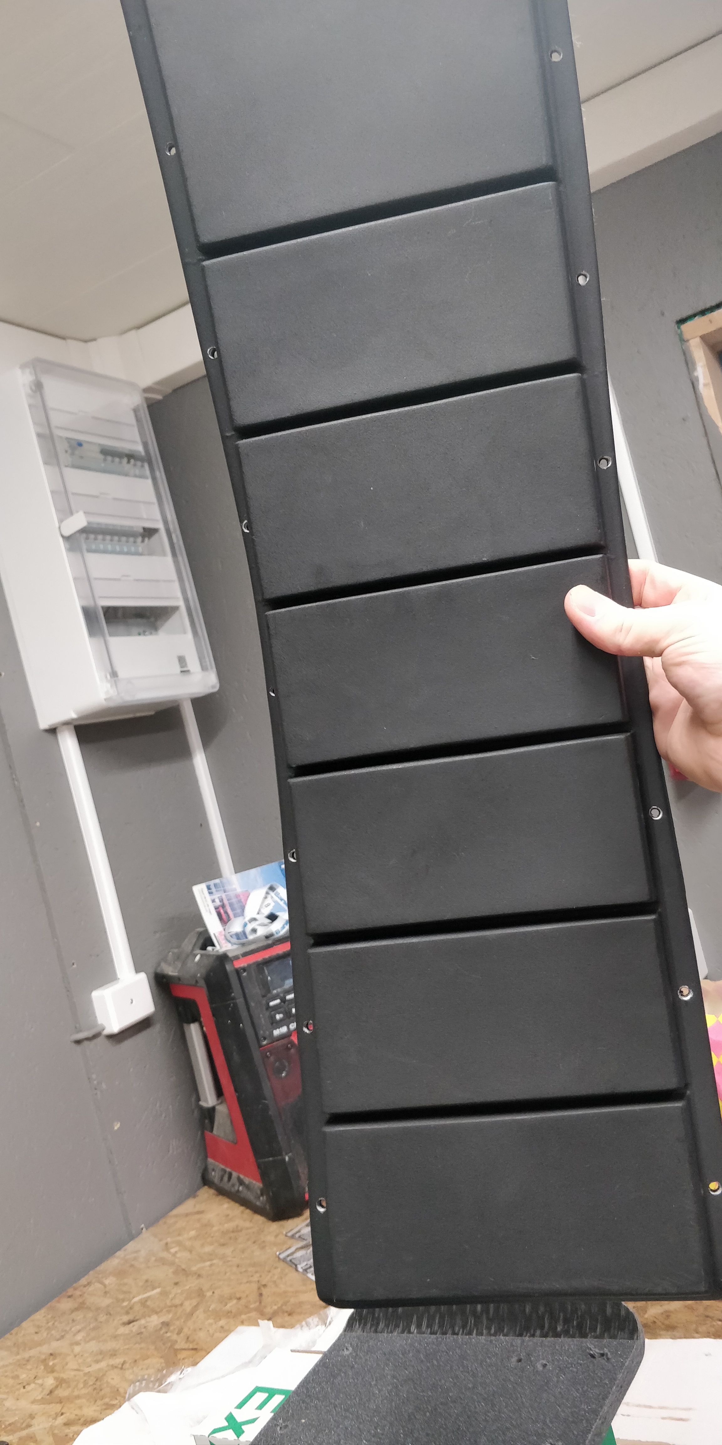

Enclosure/deck measured and drilled
Electronics ready to get glued in place will use a type of silicone so if I want to get it off I can just slip a wire underneath.
Its all done!! :smiley: Hope the weather is decent so I can try it when I get home. Will post some pics on the final board later

All electronics are done and ready to get sealed up
All done its a monster :heart_eyes: Crazy torque with a 12/72 gearing and a bit over 40km/h top speed just perfect. Can throw on a 14 or 15T to get more top speed in the city. I love it and cant wait for better weather!
