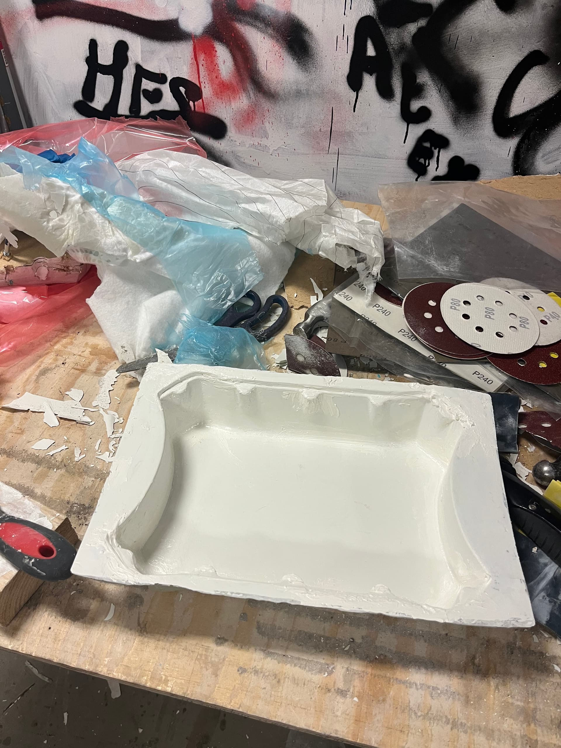

New shape, new mold and my first vacuum bag.
Looks textbook, nice work :+1:
Is that mold release or a gelcoat on your mold?
Thanks man! I’m trying with a gelcoat/glass fiber mold. I’ll be surprised if the first try goes well, but so far so good.
Vacuum bagging went well but the mold was too weak and broke when I tried to separate the gelcoat/glassfiber from the MDF mold.
Had to come up with a way to get that thing out.
One hour later I got the release but some dents in the mold. Tried to fix them with some gelcoat putty but hard to get back the original shape. I have to make a decision to remake the whole thing with a better mold or fix the dents again.
Decided. I’m going to try some reckless sanding and some more putty and perhaps some top coat to get it back into shape. To eager to ride this thing to start over.
I’ve found that putting peel ply over a mass of filler material lets you get the surface very consistent. You can shape the filler underneath and the fabric gives you a ‘preview’ of the finished surface
I might have to do that! Thanks!
