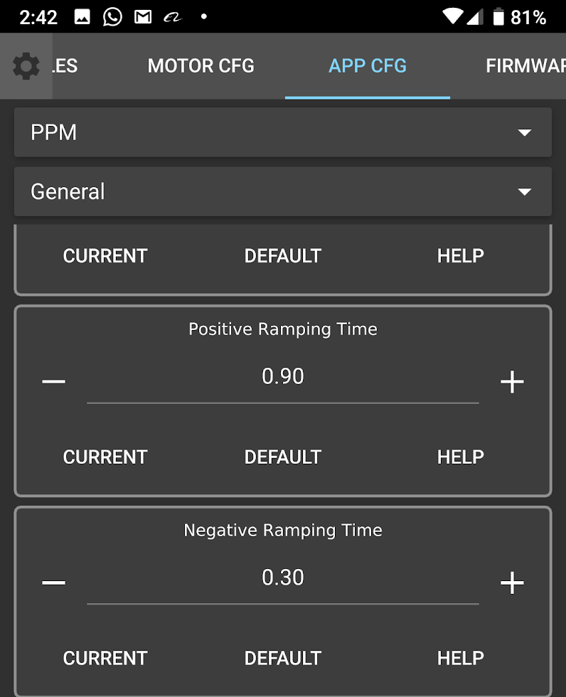

  1. Assuming dual setup, how do you have the ESCs connected? CAN or split ppm? I ask, because I am not sure if the battery current is for individual esc or total battery current when connected with CAN.
  2. Do you have metr pro or vesc_nrf51 connected? They would be helpful in debugging if you can record a session where you go from full +ve throttle to full -ve throttle.

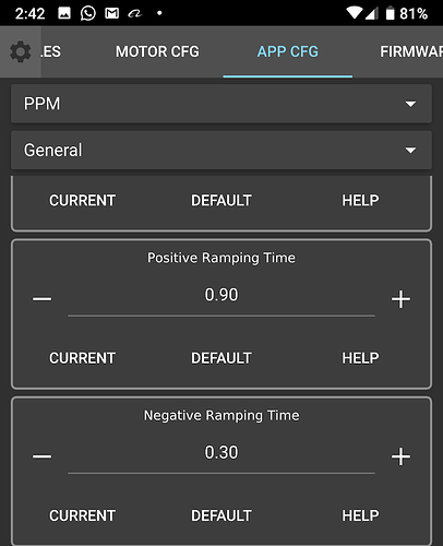

  3. If you are using ppm, can you tell me the positive ramping time and negative ramping time. This setting is under app config. My default settings are 0.9 and 0.3 respectively. I am suspicious
    that these numbers are the culprits.

I left them stock but I have tried those suggested by trampa earlier on the other forum whete I asked the same question. I’ll check what I have now when I get back home.

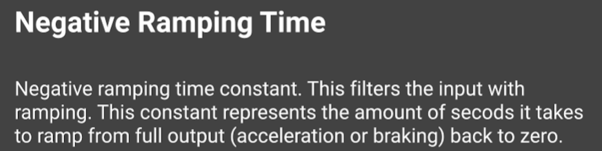

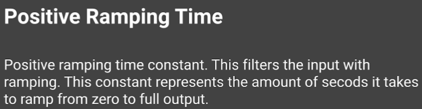

I’ve had had the delay problem, but from my tests it’s due to the ramping times being too high by default, if you go full throttle to full brake to full throttle really quickly, it can feel like the remote is dropping out
What causes this is asymmetrical current values between motor and current, so even if the throttle after the ramping times is decreasing the board is still accelerating due to it being limited by the battery current, the same old talk of just a part of the throttle being usable on flat ground and all.
What would be be really good is that the ramping to be made smarter, probably with a PID loop, so it can smooth the input but also provide a quickly change for brake to throttle, or simply disable the throttle ramp down when you are braking
If I’m not mistaken the default times are 0.3s for throttle and brake, so 0.6s to go from one side to the other, that’s too much for any medium power build, I’ve been using 0.1 in both and no more feeling of loosing control of the board

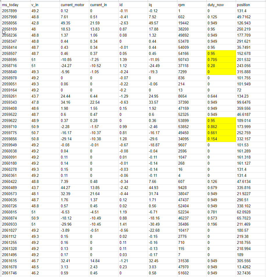

The default settings was 0.3 and 0.1 (atleast that’s what I had set now) and with 70/-70 on the motor and 40/-12 on the battery it gave the feeling described above. I just tested this on the street now but it’s pouring down and the log didn’t work… Will try to test with a proper log tomorrow. I did however log a few bursts to full throttle with no load on the wheels now and it shows signs of the rampdown but to bad it doesn’t log the PPM/PWM input. It’s kinda worthless tho since I’m not reaching the amp limits when doing it in free air. Is there anywhere I can enable/disable parameters to be dumped to the CSV file?
Okay, so my suspicion was right. Well, maybe. We can confirm once @minim does the tests outdoors. Please tell us what your ramping values are.
@minim Do you know if we can we have both the filtered and unfiltered PWM/PPM values on the logs?
