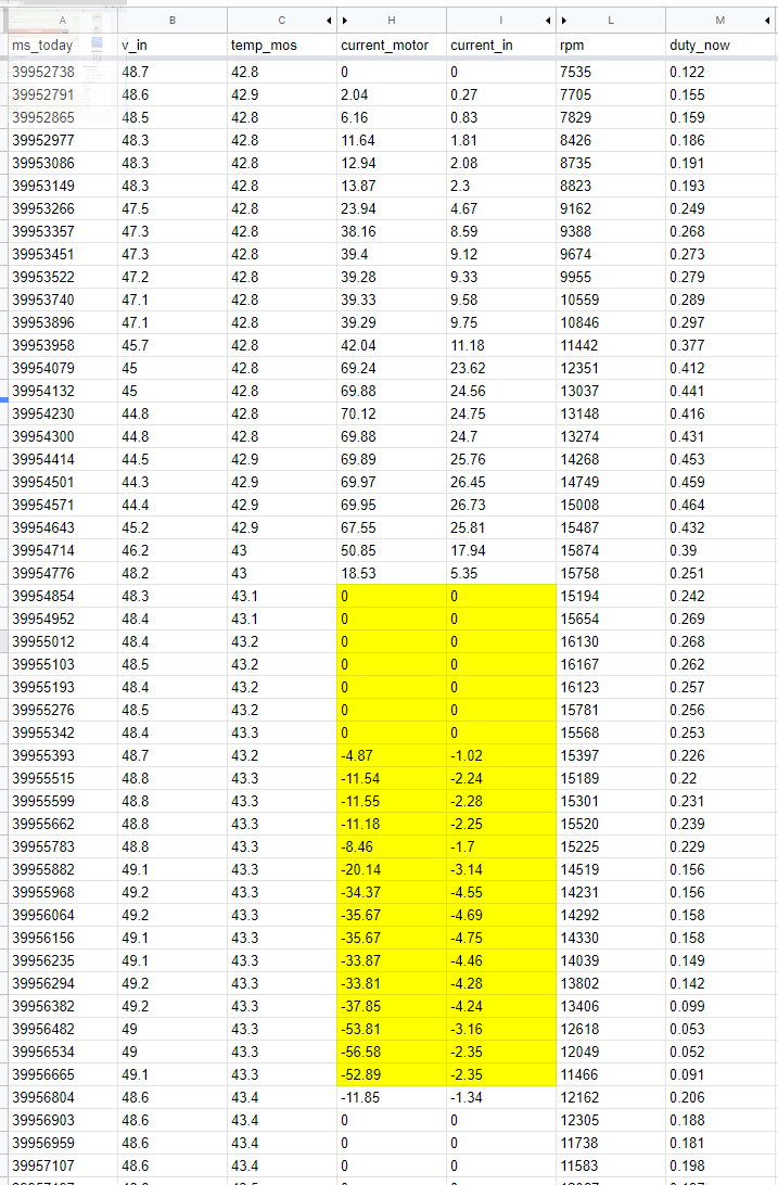

I wonder if the value you had (0.9/0.3) was somehow what the vescs had stored. When I used read button in the app screen it said 0.3/0.1 for ramping stock. I then changed to 0.1 and 0.1 and it feels a lot better. Now when I changed back to 0.3/0.1 it’s noticeable again but not as bad as when I first startes playing with this issue. I never thought ramping times could cause this kind of lag issue when using asymmetrical values. Have you looked in the code how it’s handled?
I’m only basing this conclusion on my subjective street test. I can’t log the pwm/ppm input at all so there really isn’t any way to log the issue as I see it. I’ll poke more into the logging but with the vesc tool the log I included a screenshot from is the best I can get. I removed some columns that wasn’t fit for this but there is nothing related to input.
I tried to log my test session now as well but it didn’t log… Same thing as yesterday. Piece of sh*** android Buggy feeling :stuck_out_tongue: wish they made a iPhone app instead so I didn’t have to use my P30 pro for Esk8…
Yeah, with the latest firmware, I got those values too. So before it was 0.9 and 0.3, by default, which was much worse. So that explains why the effect was strong before.

I did a new short session. It’s much less of a problem than what it was before but I still think it’s around. It’s not very scientific without having the input but have a look at this. I accelerated to about 10km/h (15200rpm/28 poles = 543. 10.1 × 543 × 0.001885 = 10.3km/h) and here you can see that I have 70 motor amps and it’s falling off to zero for 488ms (0.5sec) before it ramps braking. It takes a while before it applies full brakes but this might be due to it slipping. The braking force is quite strong so my weight shifts to the front and then it’s slipping on the rear… Wish I had more parameters so It would be easier to see what’s really going on.
Btw this log shows why I like having higher motor amps for acc/regen. It’s clear to see that I can pull 70 motor amps with only 26 battery amps. If I limited the motor to 40Amps since that is my battery max it would basically perform only 60% ish of what I got now when accelerating from a dead stop. Same with braking. I think it’s healthy to set the batt max to what the battery can handle continues. As an example in case you are bombing a hill and don’t consider that you shouldn’t be pulling 140Amps through the battery that can only handle 80A for such a long time. Most are not picking up their phone and looking if they are above/below their batt amp when doing such things so it would be better to set a limit that is somewhat within the specs of the battery.
erpm/pole_pairs = rpm. I think 28 is #poles and 14 is pole pairs.
Yeah, the motor and battery amps being 0 over 0.539 seconds is suspicious. PWM values would be super helpful here. The Metr Pro can plot ppm, so that information is available from vesc. I am surprised vesc_app doesn’t log it. It could be in 1000-2000ms format. 1000ms being max negative throttle and 2000ms being max positive throttle.

When VESC Tool creates a csv file it only uses GET_VALUES command. The response does not include PPM.
Metr Pro also sends GET_DECODED_PPM command to request PPM value.
Will that separate command get a synced reply so we can trust that it’s in sync with the rest of the data? Gotta try that. Does your app work with nrf51 regular modules?
