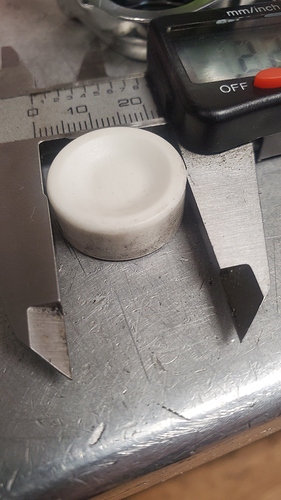

what about this as a master (its a slave here)
Generally speaking this cylinders work both ways, its just about making the area ratios work ?
