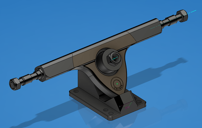

I was thinking about this concept for a while, and Ive been meaning to make a 3d concept model but I’ve never gotten around to it. I thought I’d make a post about this and get your opinion on if it’s a good or bad idea, or if you have any suggestions before I spend time on it.
Basically my idea is to have 2 small motors on the front and the back of a drop through deck, and an Arduino to control them and sense the speed. Obviously I would also need some gearing to give these motors the necessary torque. The concept is to have these motors change the angle of the entire truck (including the kingpin) based on your speed to make it more stable at high speeds, or better turn radius at slower speeds.
I understand this concept has issues, like speeding up and slowing constantly would drain the battery. Also it’s just something else that can break on your board. Although I would like to hear your comments to see if this is a concept worth looking into, or if it’s a waste of time.

One set of bushings at high angles feel hard while those same bushings at low angles will feel really soft. Gotta address this.
I was going to draw something up for this as well, i’d love if someone else would get off their ass and do it for me cause i’m lazy and determined that I will not be designing this. too busy.
But, I love the idea… i’ve been pondering this idea for a while. I don’t know what to do about bushing softness.
Since you posted this idea, maybe an easier solution would be mechanical alteration of the trucks rake. Keep the same angle, but go from neutral (or positive) to negative rake on the rear truck and positive to neutral rake on the front truck as you go from cruising to high speed and keep the same angles.
This way you could setup your truck with one set of bushings you like, have hard carving responsive trucks at low speeds and much more stable and consistent trucks at high speed, and there would be no guesswork trying to find the best angles for certain speeds for both trucks and adjusting bushing hardness simultaneously, just a ride that goes from extremely responsive to very consistent and dampened… that’s the idea right?
Only issue here is the height changes, which would be true of changing angles unless you centered the axis of rotation about the axle (most adjustable plates don’t do this… because if you do it looks funky and isn’t nearly as functional)

Now that I think about it, having the height lower when rake decreases probably isn’t such a bad thing… lower tends to be more stable and positive rake for turning responsiveness and increased height for better leverage for better turning, this goes hand in hand :slight_smile:
and (off topic a bit but…) adjustable baseplates with the axis of rotation centered about the axle so height doesn’t change:
And whoever made these caliber models, credit to you. It’s been so long since i’ve downloaded, forgot where I got them so if these are your models take credit here. thanks!
Hight change would be an issue, although I’m not sure if it’s an issue that necessarily needs to be fixed
