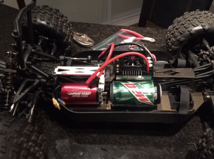

I was thinking about this. All of the 5th scale electric R/C’s I built had hobbywing max5 ESC’s (8s). When they go on sale you could get them for $150. Infinite adjustability and dead reliable. I wonder why more don’t use them in an 8s format for each motor, feels like a pretty great option.
you’d need a battery + wires + connectors etc capable of pushing 150a+? amps.
Less voltage, more amps sadly
If Max5 is anything like Max6 in operation and adjustability, I wouldn’t touch it with a barge pole.
I had Max6 and it was a nightmare to modulate throttle and brake (on road) within humanly controllable parameters.
Max5 has more power than Max6, so I wouldn’t recommend it.
Castle Creations Mamba XLX on the other hand, equal power to Max5 (or better) AFAIK, and…
Quite doable actually, and that startup torque! :heart_eyes:
So I’m not much for having a strong stance on something, but the max5 is dead reliable based on my personal and forum experience (I’ve purchased 6 units with no problems). Max6 might be garbage. But the 5 is 200a capable, simple to setup and I’ve had no issues in multiple heavy weight 1/5 and 1/4 scale RC’s. Side note I see more issues with castle large scale products (xlx) when compared to the max5.
Lots of options in the RC world for 200a.
Don’t get me wrong, Max6 was solid too, just the way it puts power down and brakes is more suited to RC racing than esk8s with people on. Max5 is even more powerful and that may exacerbate the problem.
Ok. Maybe it’s preference. I’ve grown up using hobby grade RC’s/TX modulation. My wife can’t handle the 10s6p eBay esc board I built, but I on the other hand love the on/off aggressive acceleration (for what it is). I actually prefer it over my other boards.
So you run uncensored BLDC on Max5? Maybe it depends on the motors used? @NoWind reported Leopard 8072 motors to have smooth startup on Max6.
Personally after that many falls on road with Max6 and a hospital visit with some memory loss, I just can’t be bothered with tech trying to kill me.
FWIW I’ve driven racing RC cars before, and what I’d deem as good response and power modulation there, doesn’t translate well to human reaction time when you’re on the vehicle.
