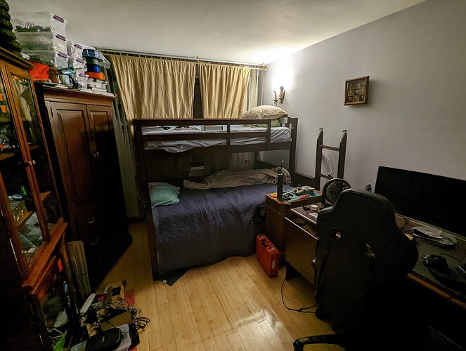

For reference, here’s my room. That small table with shit on it is my workbench.
I feel like you, me, and several others here, would benefit massively from one of those boxes with gloves built in that tv doctors always use.

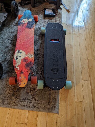

22lb, sexy as fuck, and almost done. Still have like 0 ground clearance from the motor mount screws. But apart from that it’s almost rideable.

It’d be too high off the ground tbh. I’m happy with this.
Yeah id just be worried about popping a mount loose :rofl:
Big Z up there had the best idea, honestly. Drill out the topside of the mount wider and rethread the bottom side, and use a wider bolt. Voila!

its too powerful at 80 motor/50 battery per side. duhhh. Lowered it to 60/30 and its still fast and fun :sunglasses:
Problems:
-one of the motor mount clamps got loose. Oops. Fixed it mid ride and kept going
-that dumb ass screw that sticks out from the clamp kept getting caught on shit and is extra broken. lol
-MY FEEEEET. I think I’m gonna have some 90mm wheels soon, so we’ll see what that does for comfort. you win @Kai
-I live in NYC. NYC streets hate shortboards

^loose motor mount
You could always use foam grip. Or if you wanna do some science for me, sorbothane is top notch at vibration dampening. Cags ain’t too bad with foam grip. You should try riding cags on an aluminum deck. Fuckin hurts, bro.
