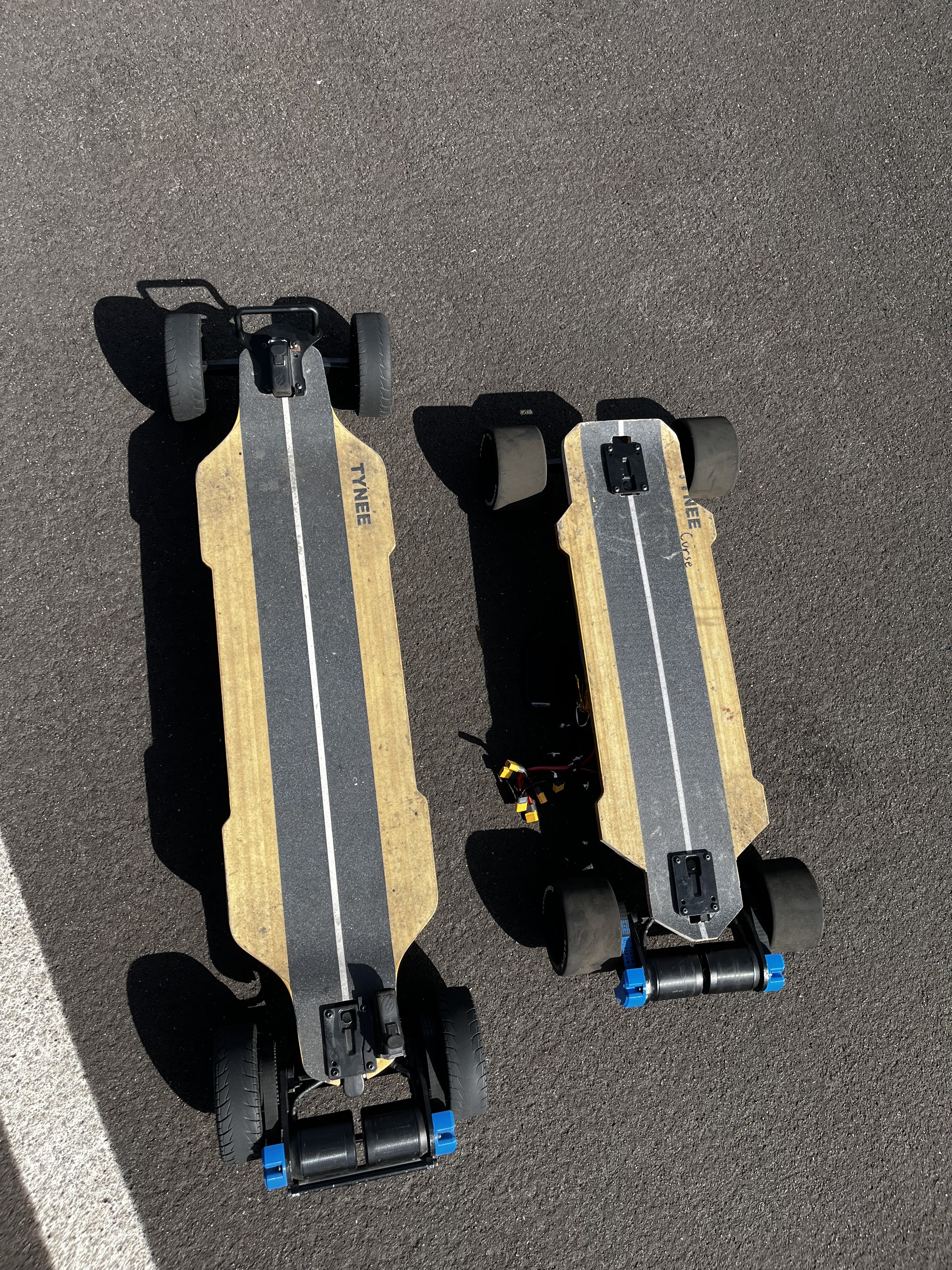

What if I just made the Tynee explorer… fit the 34" requirement?
It begins
After some quick brainstorming,
I drilled some holes.
And it actually felt pretty damn good.
the deck was sliced apart with a jigsaw later to cut off the delaminated bits and add some wheel clearance,
Added holes for drop-through mounting, hoping to lower the standing platform and make this half-decent to race.
Notably i forgot about the now curved front when I sized the holes, so the truck doesn’t sit flat on top. Cursed.

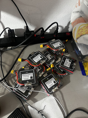

Building the battery back together
Another pack construction deficiency I noticed was that the cells didn’t have fish paper on the positive cell terminals. I had a bunch of 21700 4p rings left over from the build of Nothing Fancy’s battery,
so I spent the time to cut slots and insert them below the welded nickel.
Oh, also, this pack uses NCR20700B cells. There are an uncommon 20mm diameter (instead of the more common 21mm), so the fish paper rings were actually to far spaced apart to be put under all as one. I had to cut each one out and insert individually
Cursed solution, but definitely better then nothing :upside_down_face:
Also added hot glue to directly attach the cells to the PCB to hopefully avoid vibration stressing the nickel
With the 12 modules in hand, I started to mess around with where/how to actually mount them to the deck, making sure that this plan would actually work
Mentioned above as Issue A, I had to cut the nickel in a bunch of places. I cut some nickel strip and spot welded new connections.
Spot welder tanget
I bought a kWeld from @BenjaminF, this was my first time using it! Worked great, except I had a lot of trouble getting the fancy 60A power supply to work.
Only needed to do a couple welds, so I ended up just using my chinesium adjustable power supply.
Felt…wrong.
Ain’t pretty, but it’ll work
Soldering on XT60 leads
Printed up some nice professional-looking labels, added protection for wires that wrap around the PCB, and secured them with kapton tape.
Clear heat shrink
x12
Modules done!

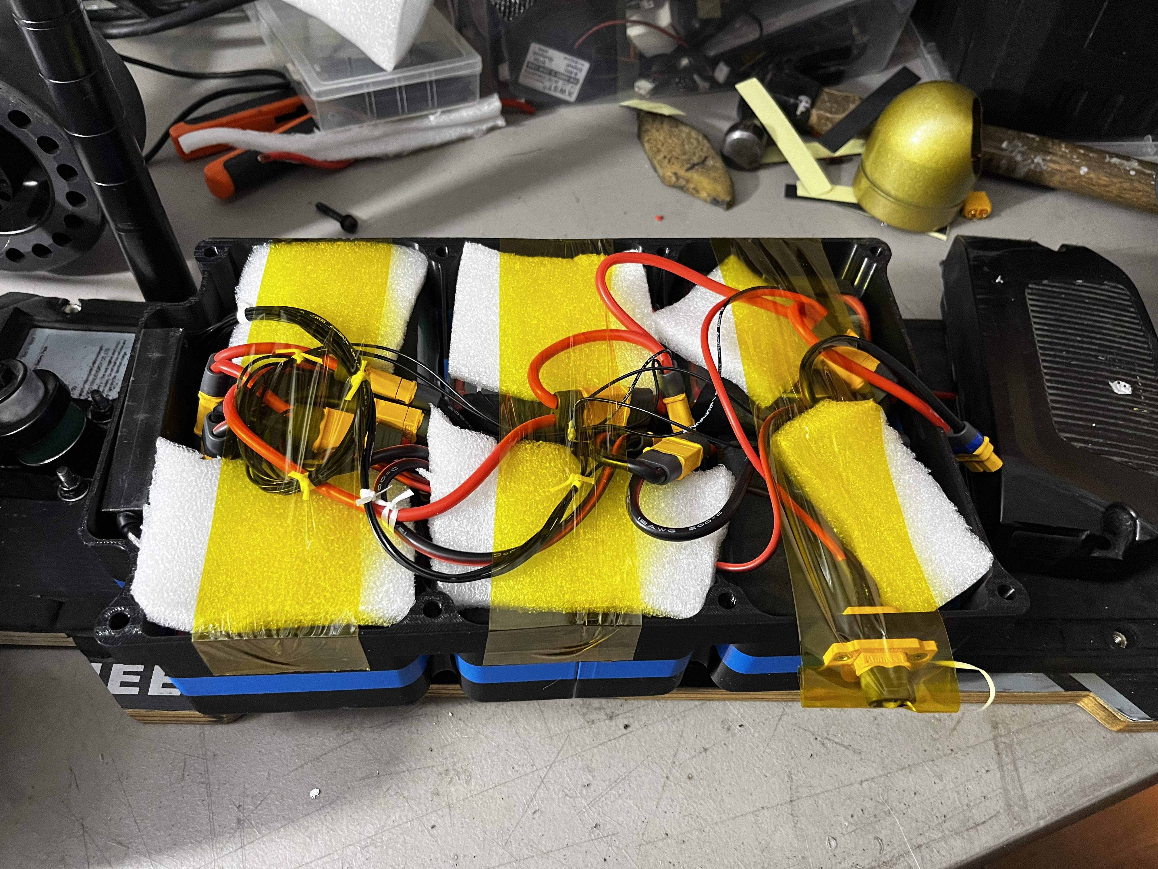

Wiring Harness
Aaaand this is where the project sat for like 10 days because this is the part that was going to suck.
Started to prototype the 3D printed enclosure, and I have very little room for the interconnects.
So I distracted myself by putting adhesive foam onto the packs to increase the friction between them and try and protect them, at least a little bit.
Finally got around to building the harness.
It needs to have 12x battery connectors (XT60s), BMS connector, charge port(XT60), and ESC connector(XT60). No way to do it neatly.
Some of the XT60s were pretty complicated, like the negative-most battery connector. It got BMS wires(2x 22awg), charger negative(16awg), and the main current path wire (2x 12 awg)
Basically done, just missing the charger port and esc connector
Louie was an instrumental part of motivation
After multiple printed prototypes, I printed the final enclosure out of PC. It’s a two piece print. I attached together with epoxy (I was feeling too fancy for hot glue)
Yuck
Some misc foam to fill the voids, and 2" Kapton to hold it all together.
yuck
Plug it in…
No fire! :checkered_flag:

Enclosure buttoned up, Look how clean, perfect and innocent she looks.
Almost looks like a normal build.

Also, totally forgot to include a measurement. <34”
:checkered_flag:
