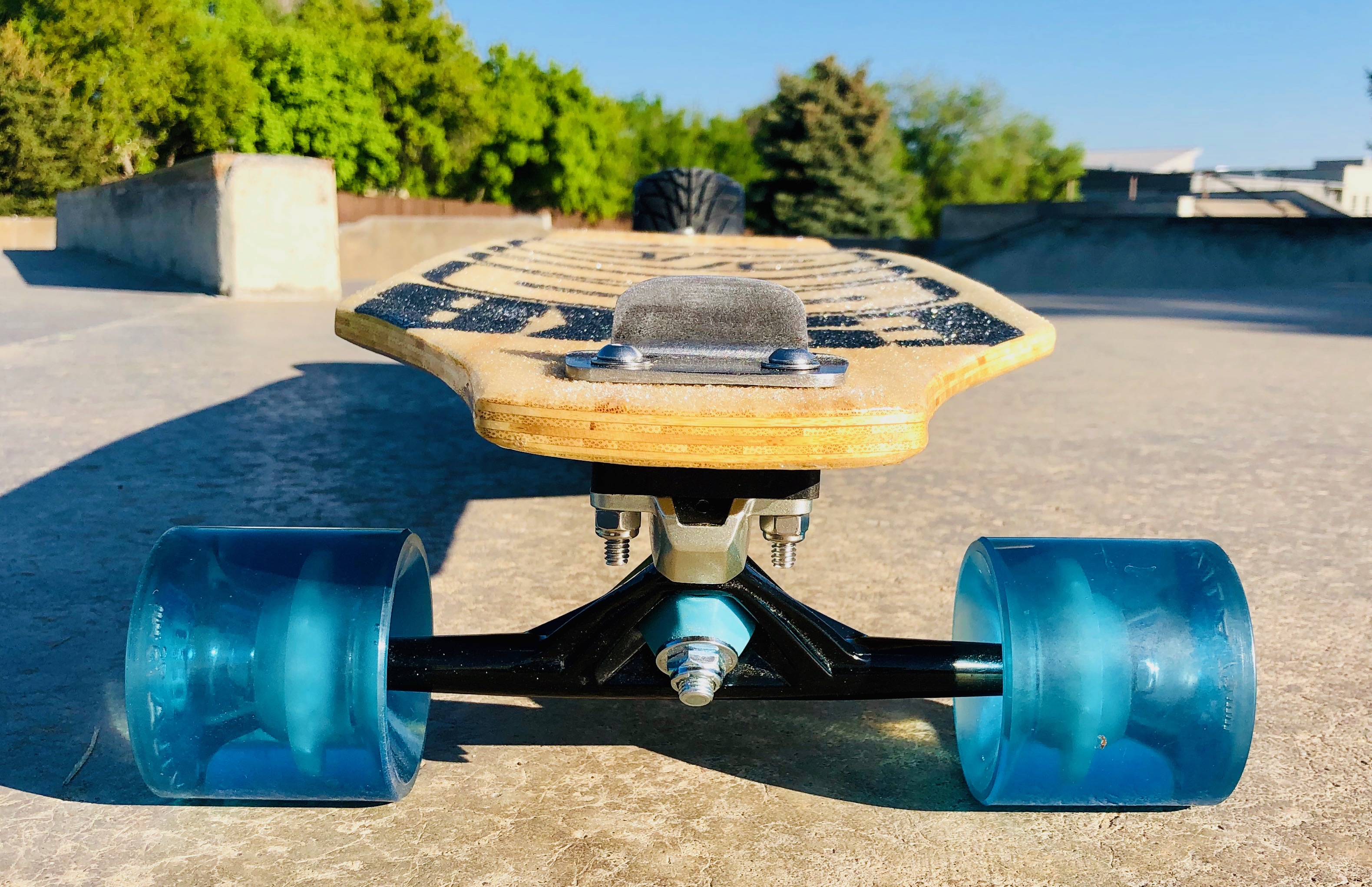

To make one, the biggest barrier, as far as I’m concerned, is getting a deck for the build. You may be able to rig a metal frame to a regular board, or you can do what I did and make your own skateboard. Believe it or not that isn’t too hard. You can buy a kit and learn everything you need to know about it at www.roarockit.com . There is also a wealth of info about this subject on the web. Once you know how to make your own decks… the sky is the limit:) This big upgrade that I do with all of my esk8s and, especially for the three-wheel design (to reinforce the forks), is that I do fiberglass reinforcement. Again, that technique is all over the web and YouTube.
Once you have a deck, you need axle brackets. This one isn’t covered on the web, but it isn’t difficult. I used 1 1/4 inch angle-iron that I found at the local hardware store. With a grinder, metal drill-bits and some creativity anyone can do it. Most wheels that you might use for this type of design come with lock washer that keep the axle from spinning. I MIG welded mine onto the bracket. This isn’t necessary but I highly recommend it. Either powder-coat these or spray them with some kind of rust protection. I used some extra angle iron to fashion a foot-stop/hood-ornament/bottle-opener for the front.
The board in the pictures is outfitted with a 48 volt 1000 watt motor. I like this wheel specifically because it is compact and rolls from side to side really smoothly. Also, the tire is molded rubber so it can’t blow out. I used a 13s4p battery pack that could run a golf-cart. I weigh 175 pounds, and I have reached 29 mph on flat ground. 25 mph up hill and it climbs like a champ. I outfitted it with VESC 6 hardware and a custom-made race remote that is based off of projects found on electric-skateboard.builders… with a little of my own special sauce. Refer to “A Race-Remote Project” for more about my remotes. Also, I made a custom enclosure by heat-molding 1/4 inch ABS. It makes a super-durable yet flexible enclosure. It can be done in your home oven with a wood mold. That’s project that I will post more about.

Follow the link to see some video of last year’s proto-build. The turning all depends on the front-end. In the video I’m riding with 218mm Tracker Dart standard king-pin trucks and Seismic speed-vents, so turning is meh. With Carver CX surf-skate trucks you can do little loops. The Seismic Aeon RKP Trucks pictured here a favorite of mine. They provide a good balance of various performance aspects.

In theory, because it only turns from the front, you have only half the turning radius of a 4 wheeled skate. But I guess it can be compensated with a super turny front truck like the SideWinders/Evolve.

Your ride is pretty sick, but it certainly doesn’t look like it can turn at all.Have you evolved your design? I made this one several years back from parts that I scavenged from a weird Chinese toy. It’s actually what got me started with esk8s. As far as adapting to vesc is concerned, It’s just a single-drive hub-motor system. Also, I think there is plenty of room for competition in the world of 3sk8. I welcome it and can’t wait to see the innovations of others.
As the fat back-wheel begins to rock over to one side during turning it does create a turning radius. Infact, a skilled rider (not me) could do perfect donuts with this design. Turning isn’t a problem here. Certain trucks don’t work well with it, but it actually turns as good as, or better than any esk8 that I’ve ever ridden. You’d have to ride it to believe it.

I have ridden in a bowl with this thing, but it isn’t easy. The skatepark is by my house. It made a nice place for a photo shoot.
