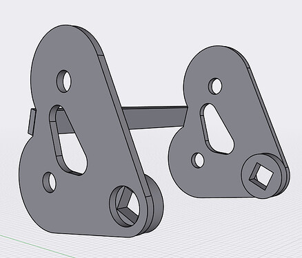

That is pretty pricey. The bigger the more expensive… Now that I look at it the dimensions are the same for both. Is it trying to cut the canvas as well haha? And are you trying to make your own clamp also, would be easier to use an existing clamp if possible.
I saw the part builder just today. That’s usable for the clamp.

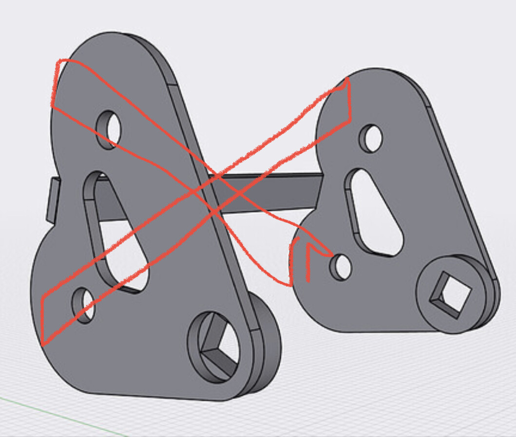

I might not do the open “c” design and just use a closed “o” with grub screws.
Resisting exotic materials in favor of working build.

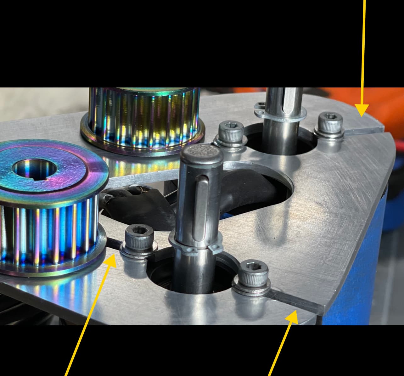

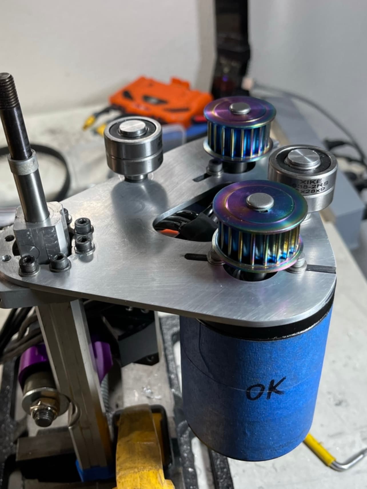

Some pretty decent vibrations on there, even on the bench. Planning some cross bracing between motor mounts?
Yeah that’s gonna address side to side vibrations and movement of each plate but with two motors on each plate, that brace isn’t going to restrain possible twisting of the plates.
@Arzamenable (as inelegant as it looks on my crappy sketch) something like this would probably provide more effective support?

yes, but plate was 0.125 in, 6061 aluminum, there was no cross bar stabilizer, and most significantly, bc I stubbornly shaped this myself on a band saw, I just cut straight through the motor bolt pattern for ease. (Arrows)
Also only used two fasteners that were not terribly tight.
Thanks for pointing this out. That gif was a proof of spacing and ability to spin.
But yeah,
@Titoxd1000 and anyone else, that link for the step file is up and open for anyone to edit.
