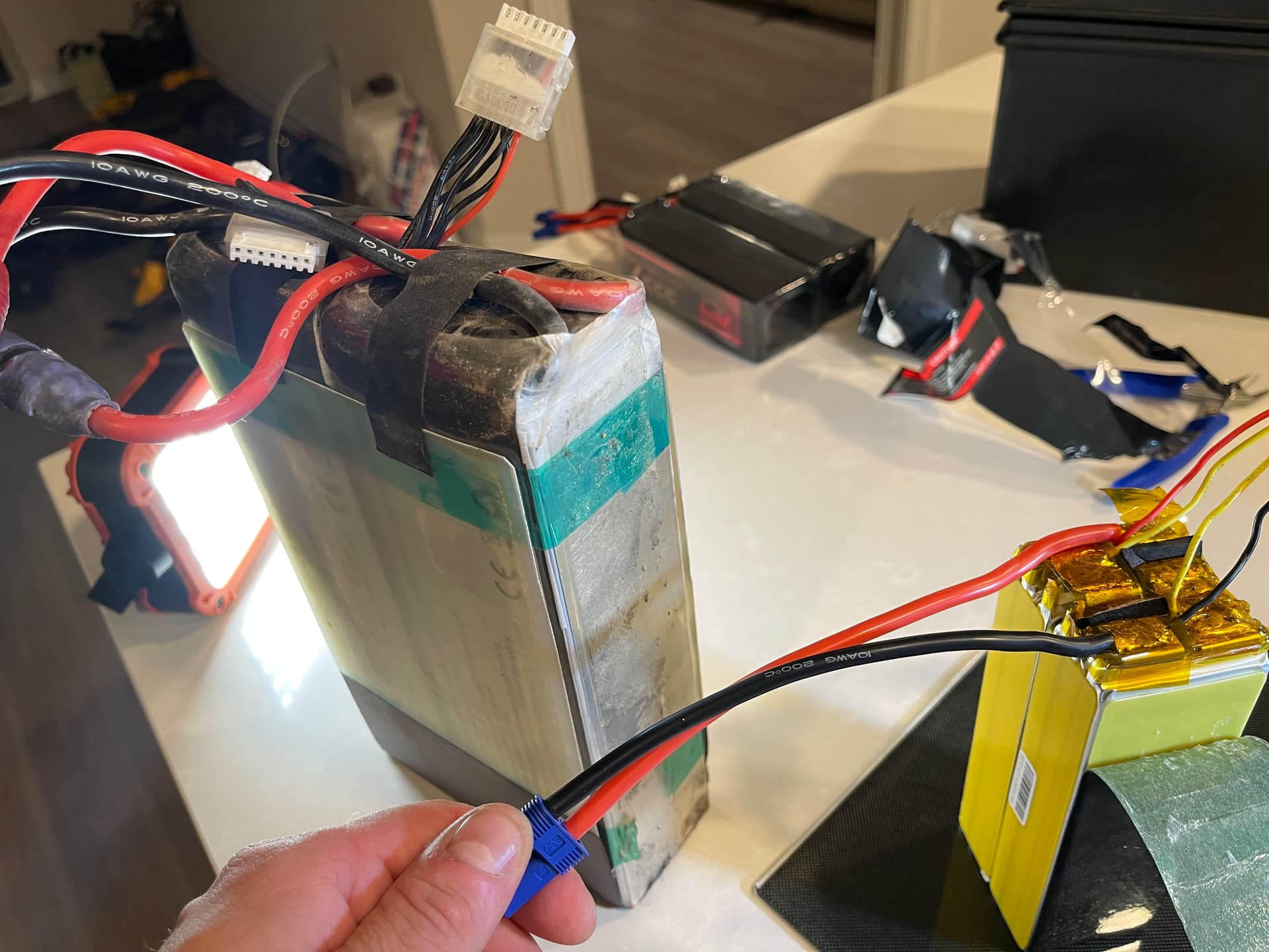

Of the 3, 12s packs I sent, one has black X’s on the bottom of each 6s pack. That one experienced a brief dead short (my bad skatan). IRs seem ok under 1c charge (14A charge, 3.4-2.0 IR ranges. They were all 1.5 2yrs ago. )
Please use that pack for a 600A spike draw, lipo manufacturers said it was cool. 1200A seems dodgy tho. (I also sent a fire extinguisher, butane, and acetone)
You could totally put two of the good packs in parallel, and that 72kw peak power (96 British HP, don’t know freedom horse equivalent) would kick.

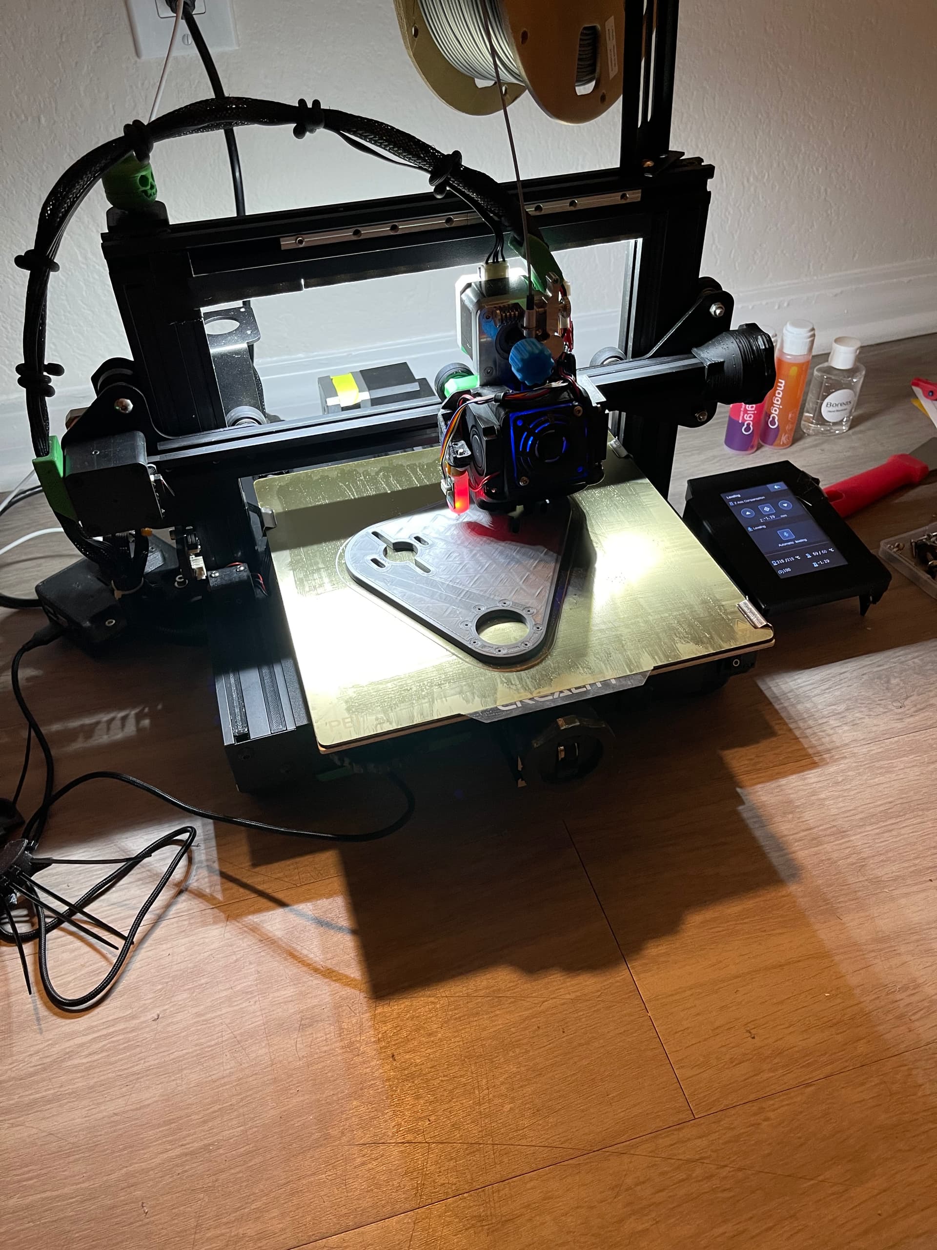

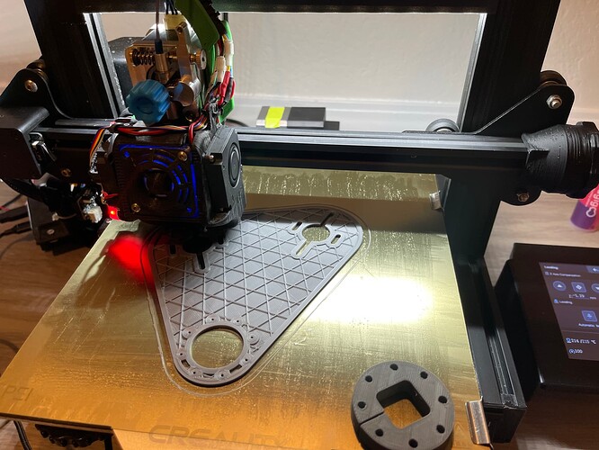

Printed a test of the motor plates before sending out for water cutting. The shorty e3v2 lives on, nothing fancy, nothing conductive. Just pla pro.

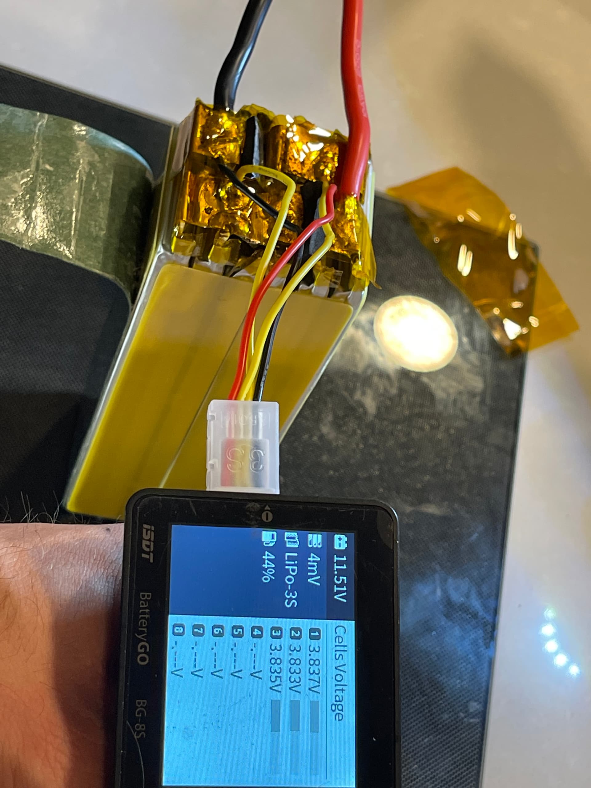

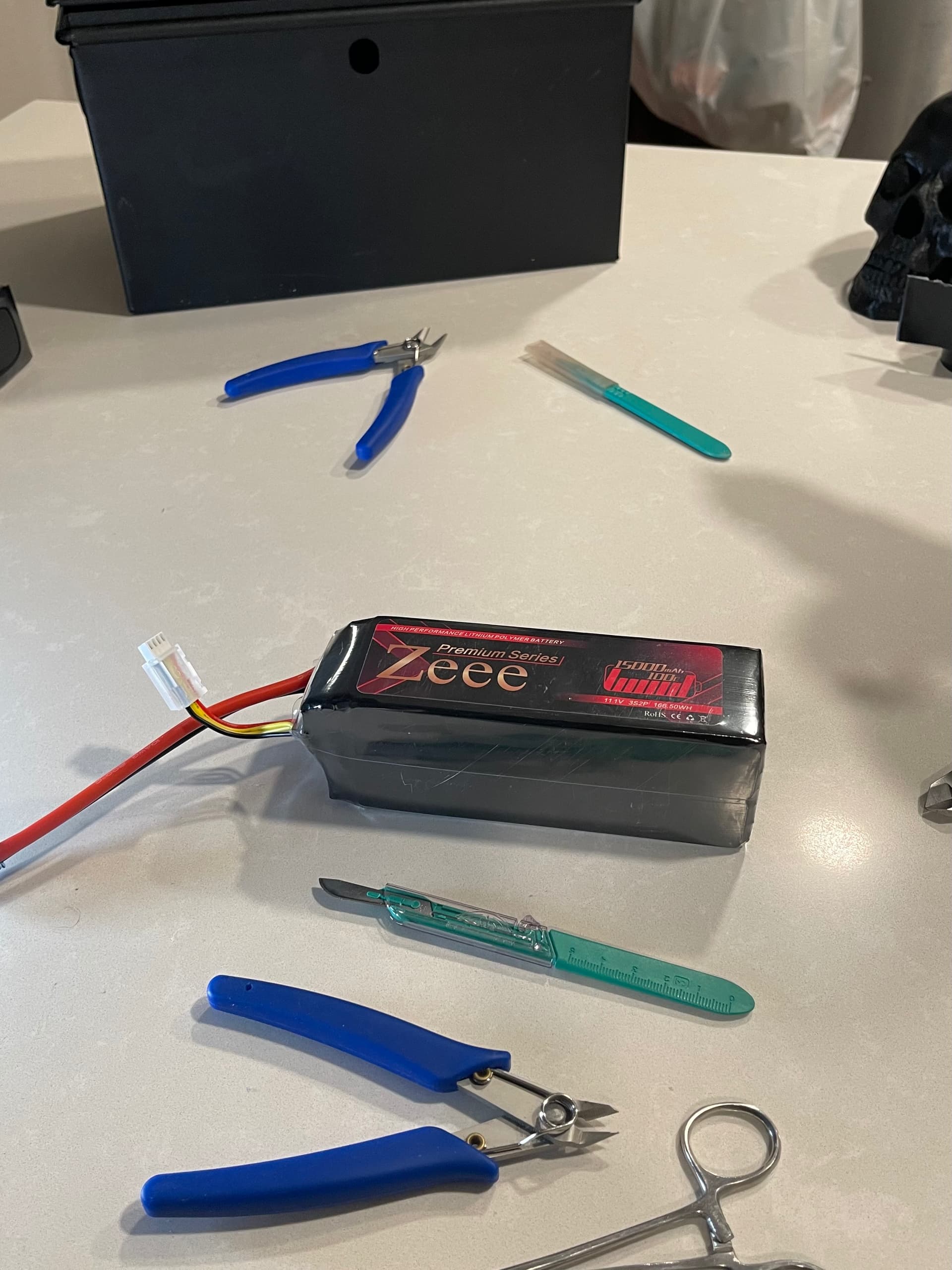

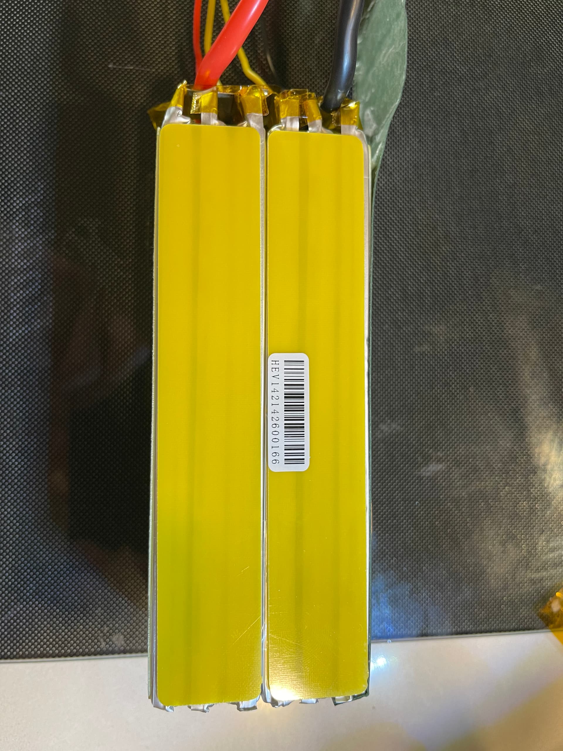

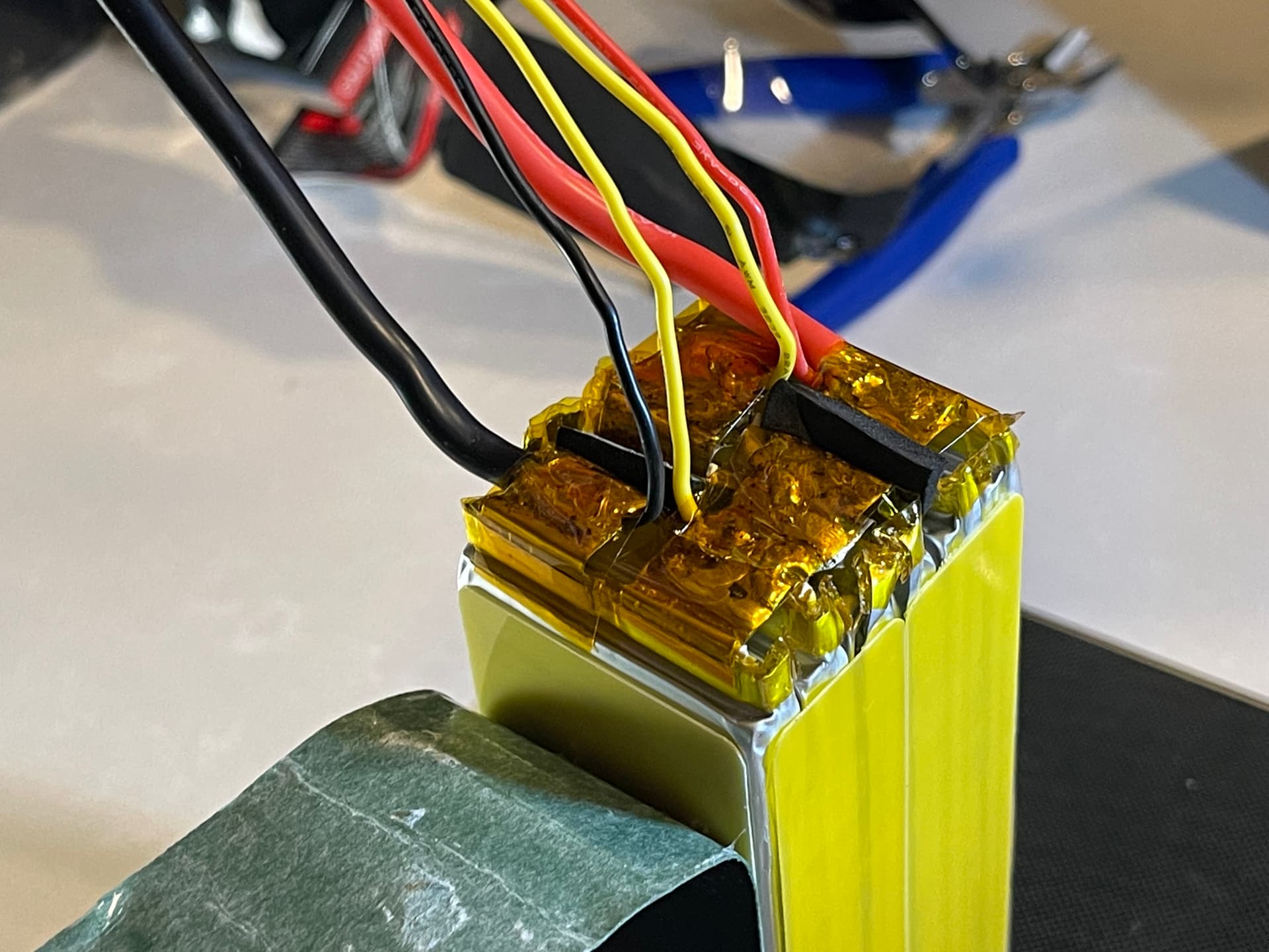

Also decided to open a 3s lipo. Same 0.3mm G10 shielding that I added to the tattu packs. The zeee packs are only 60$ per and I needed an extra 3s for the kweld.
Too bad I couldn’t get the superCap bank. :sparkles::zap::sparkles:
I guess my tattu packs were 10awg all along. Same as these packs.
