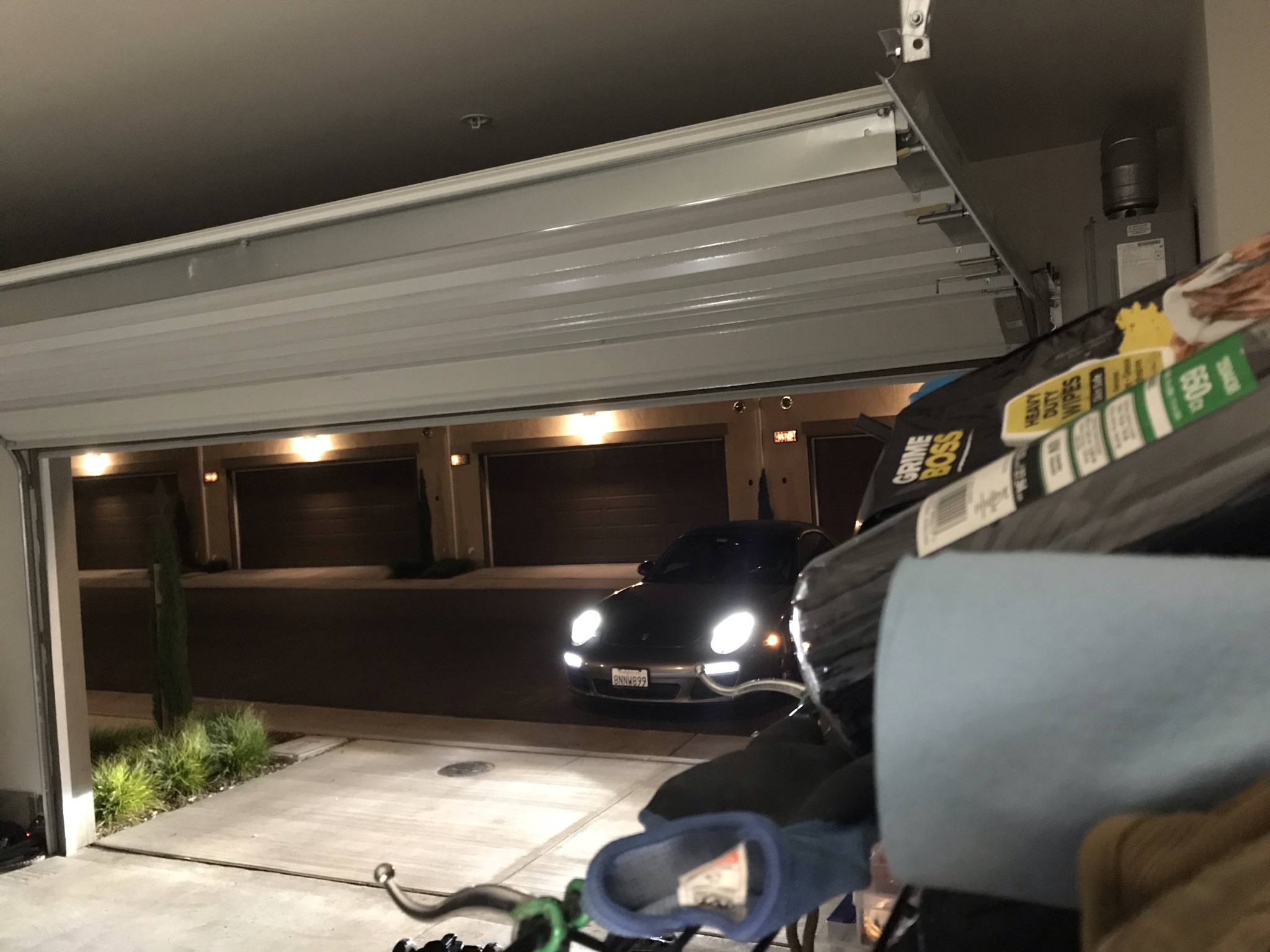

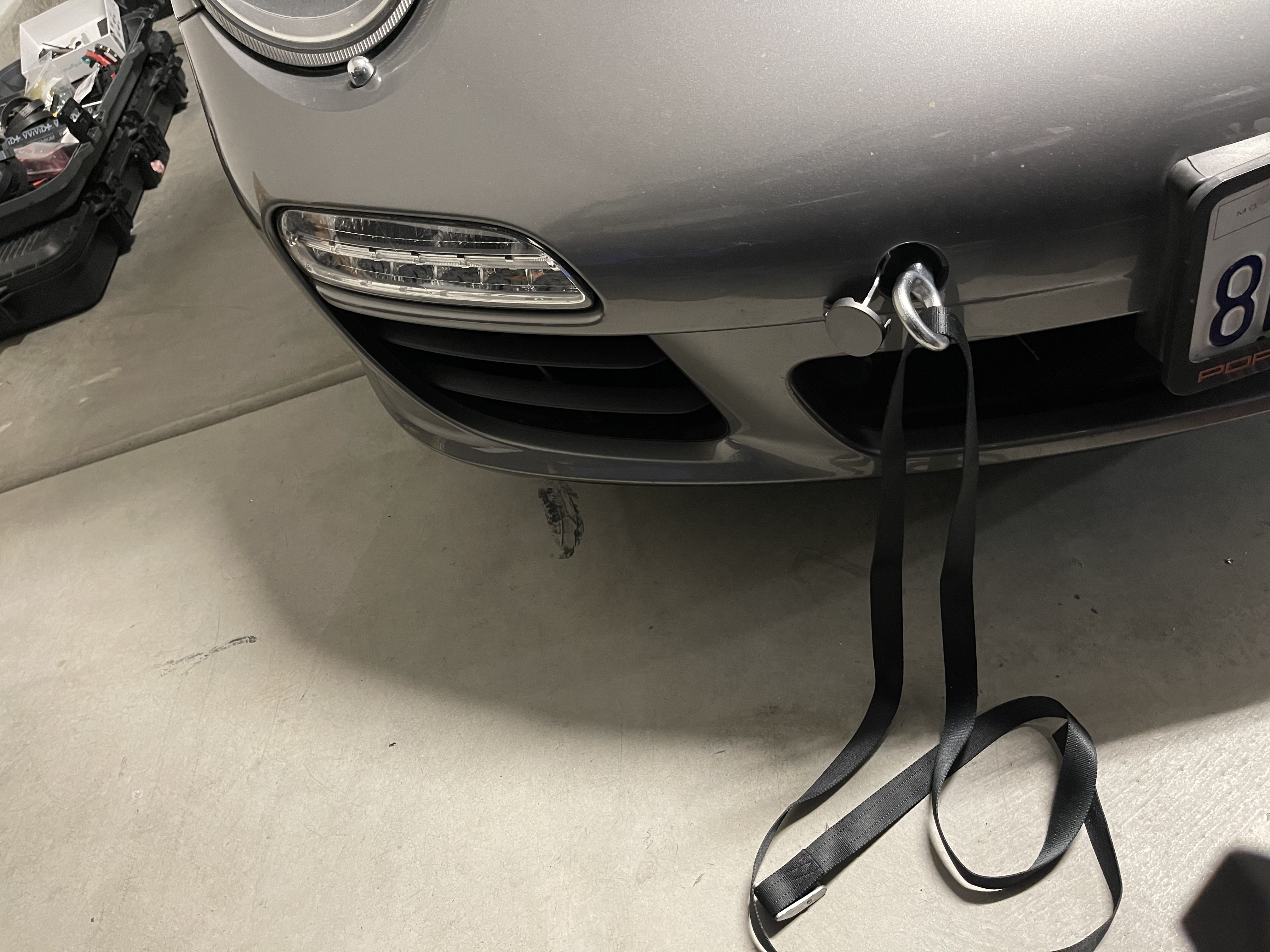

I tried to pull something heavier than usual recently. @ahrav @Jansen and @Serineh have all seen this tow rope of death. Can’t recommend it. Works ok for cars. :man_shrugging:
