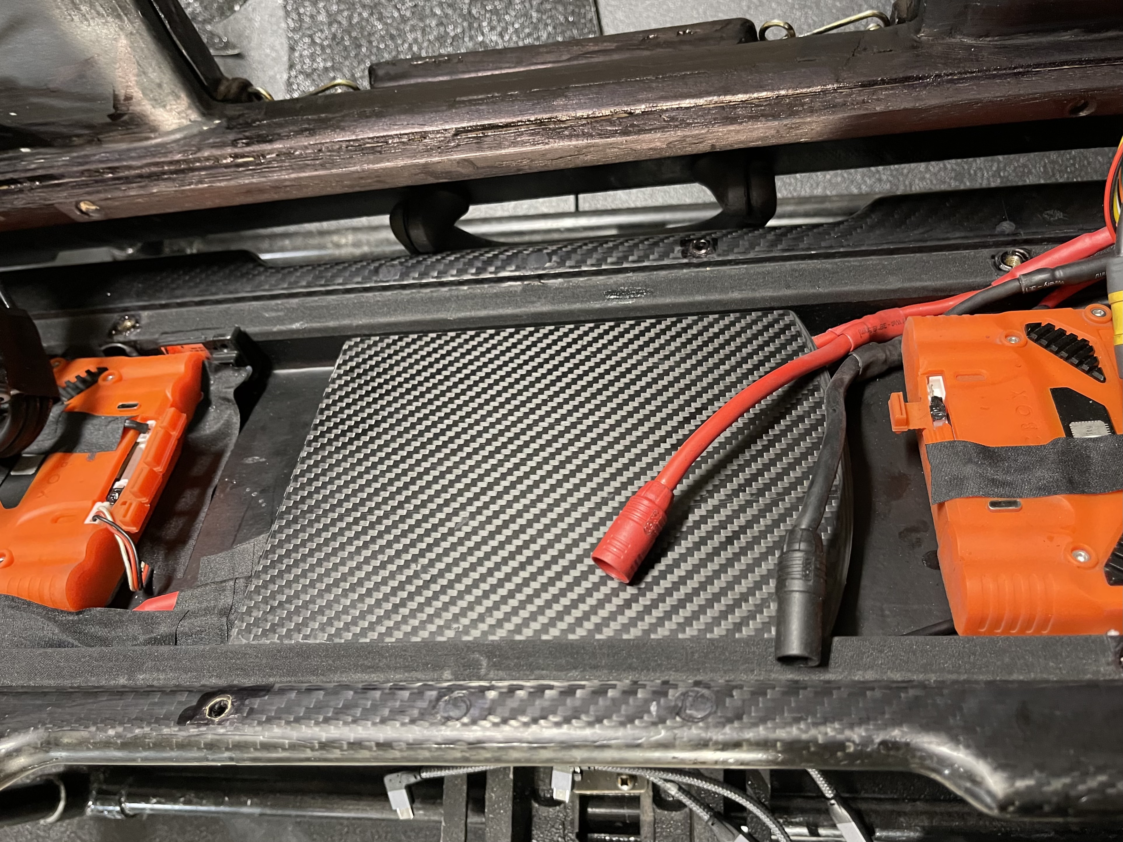

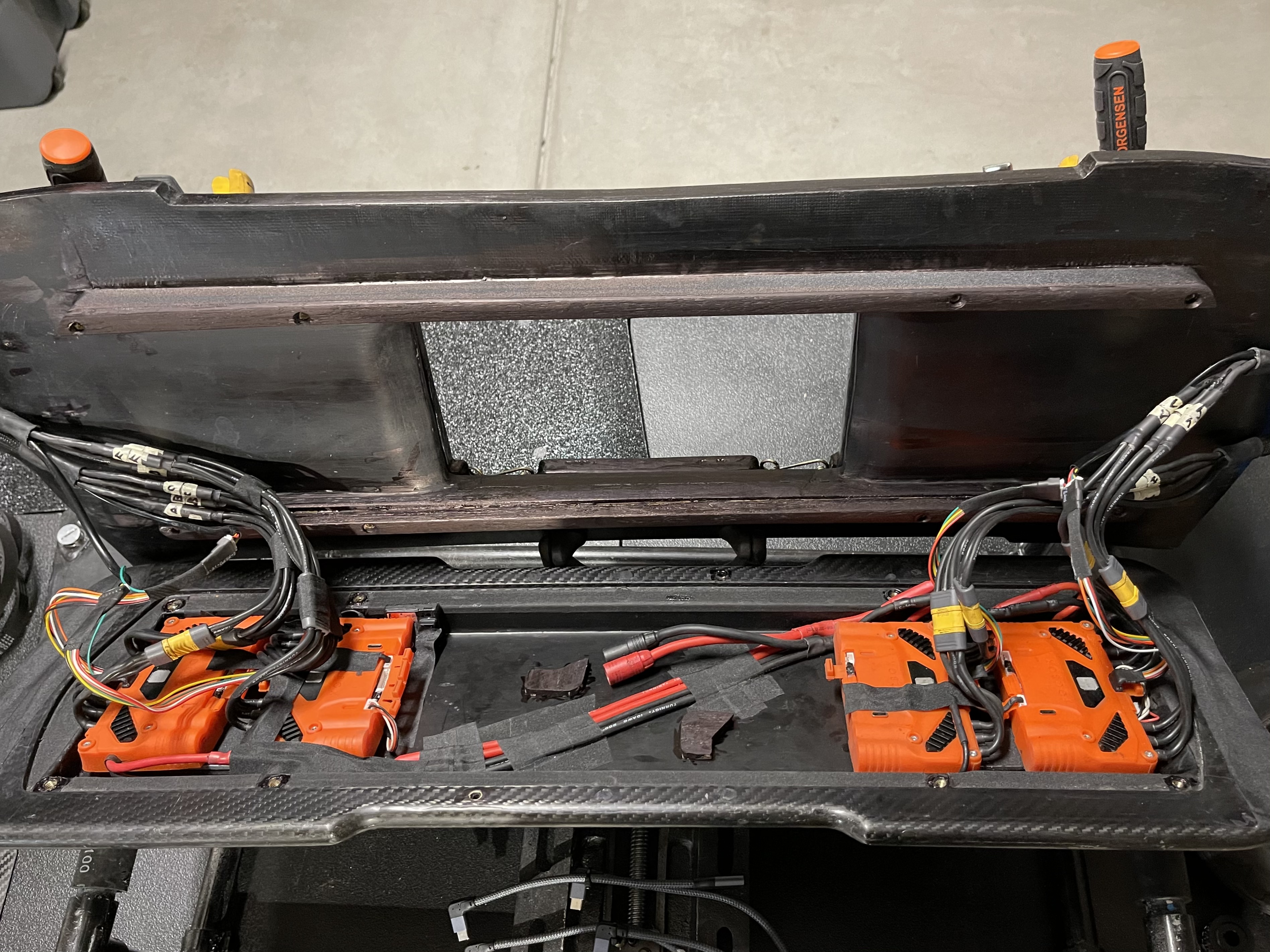

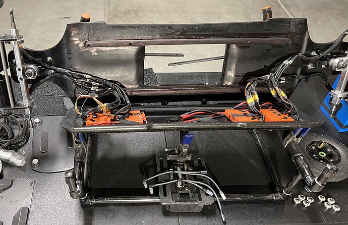

6389 x 8 | quad unity/stormity | 12s/18s tattu | RedEmber 44
Thanks for the answer back, love the build, can’t wait to see the speed and tourqe this thing has.
The tesa tape for automotive wiring harnesses is pretty good. The fuzzy stuff you can tear by hand:
Automotive Wiring Loom Harness… https://www.amazon.com/dp/B08CV8CVKB?ref=ppx_pop_mob_ap_share
And there is the smooth kind that is impossible to tear by hand. Apparently heat resistant up to 150c and good enough for Mercedez and Audi.
5 Rolls Tesa’s Most Advanced High… https://www.amazon.com/dp/B074YCG21Z?ref=ppx_pop_mob_ap_share

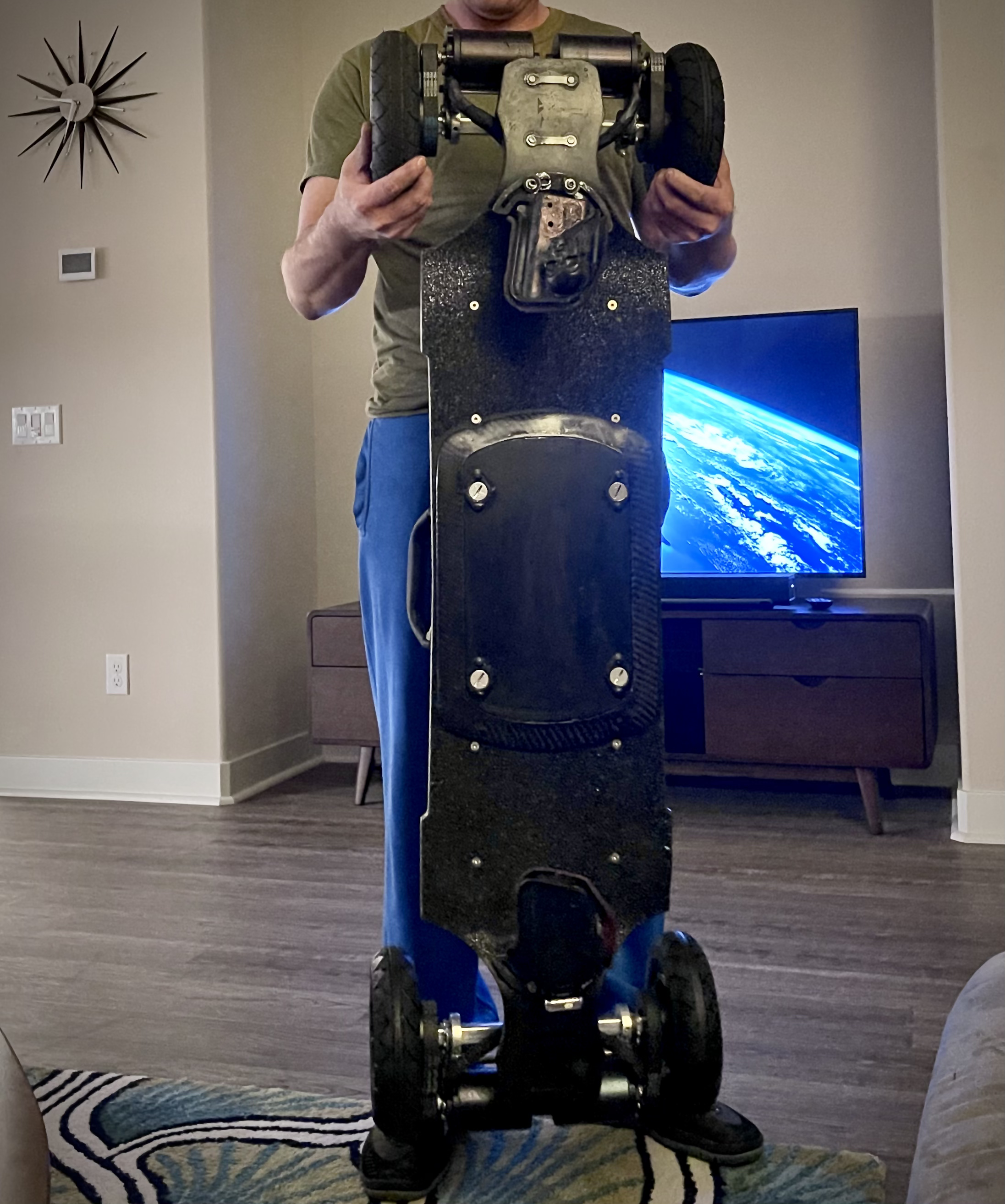

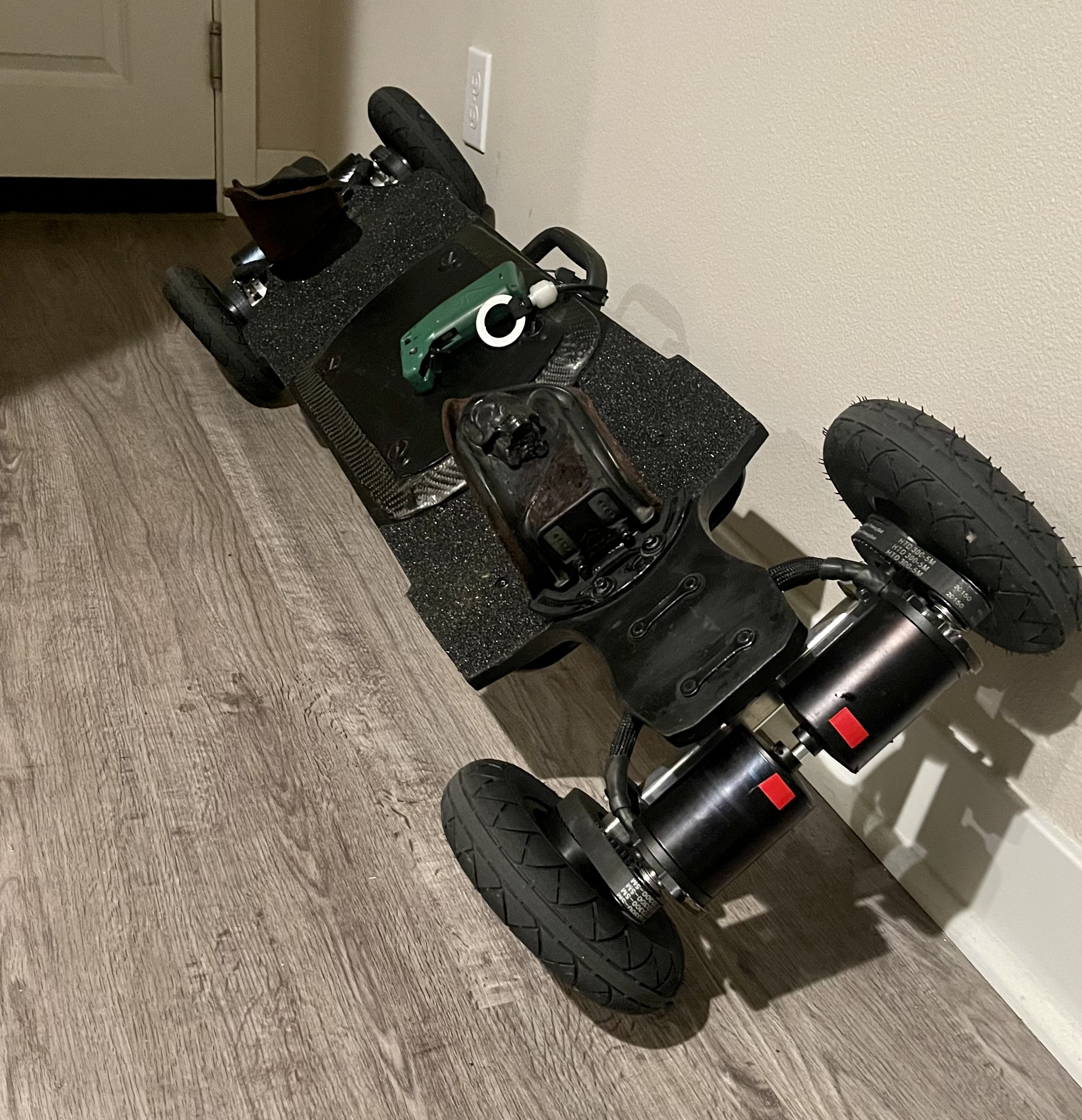

Someone asked the weight awhile back. 50lbs on the dot. Single battery, 4 motors, 4 unitys.
@ahrav the link for the gates poly chain carbon belts. They are 25$ For the 300 length belts. Not technically supposed to go on regular htd profile pulleys. We will see about that on Monday.
https://www.royalsupply.com/store/pc/Poly-Chain-GT-Belts-5M-c1032.htm
For reference, the gates 5m htd belts were only 7$

Dude, the polychain belt is rigid AF.
Other two are basic htd and gt3.
Does it work with HTD5M tooth profile?
It should given typical Esk8 tolerances. This isn’t an aviation drive train, pipe down Gates, we know.
Rode first time at medium speeds. New tires, inner tubes, bushings, bearings, grip tape, and human shoes.
It is real hard to warm all up the unity supers. Not sure about speed, GPS is terrible here. I have a metr pro canbus magnum antenna w/ gps and SD drive on order.
45A average from battery over 9 mins is pretty okay.

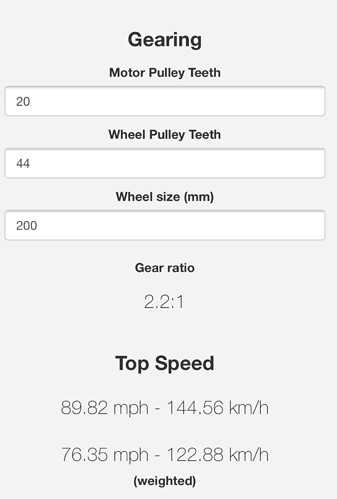

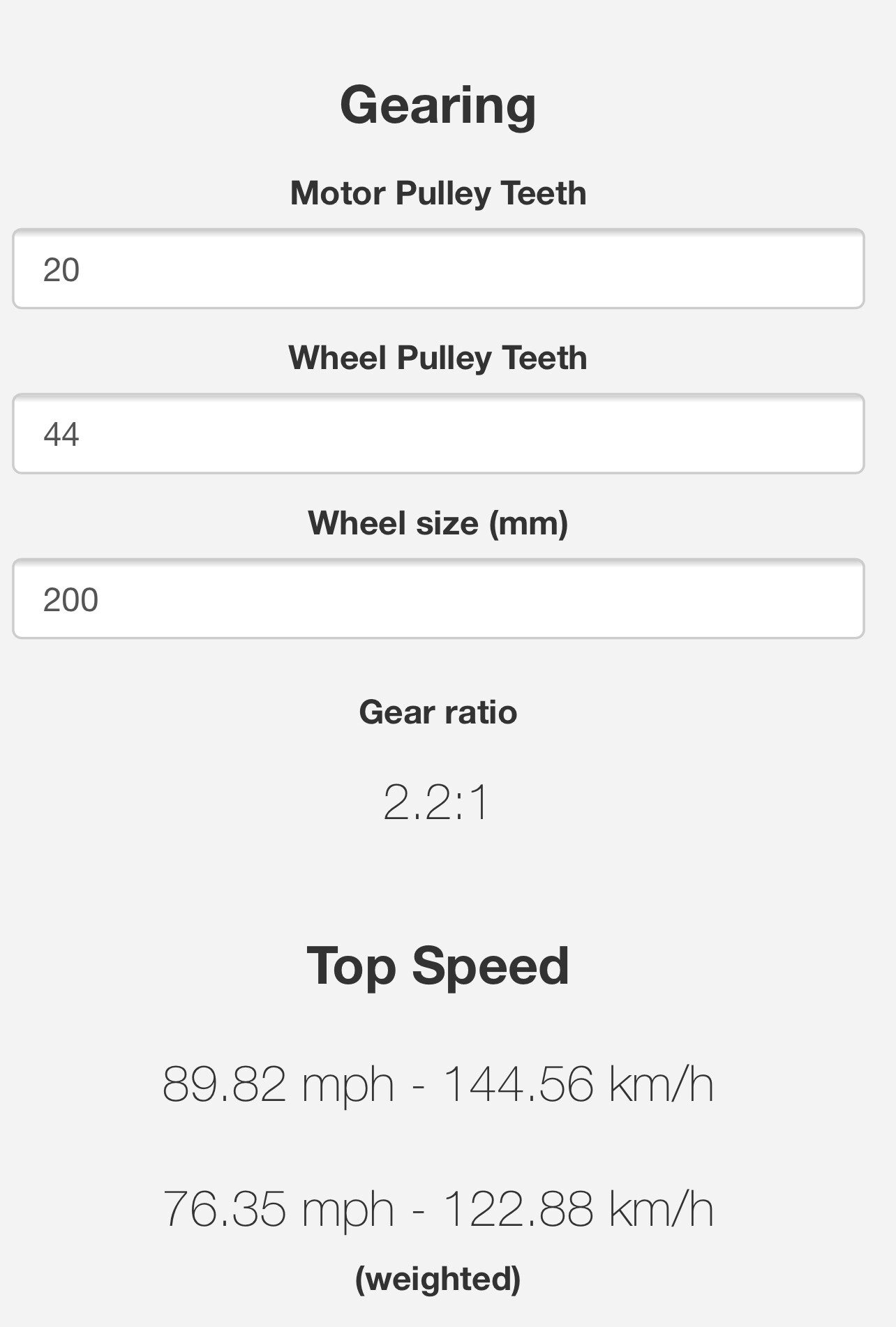

I finally swapped 18t to 20t.
That’s a 2.2:1 ratio now and it pulls
Max motor current 393.8A.

Normally connectors and cables
I think I saw as150 but unsure of the config
