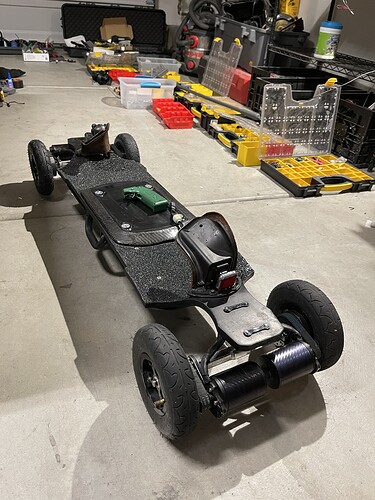

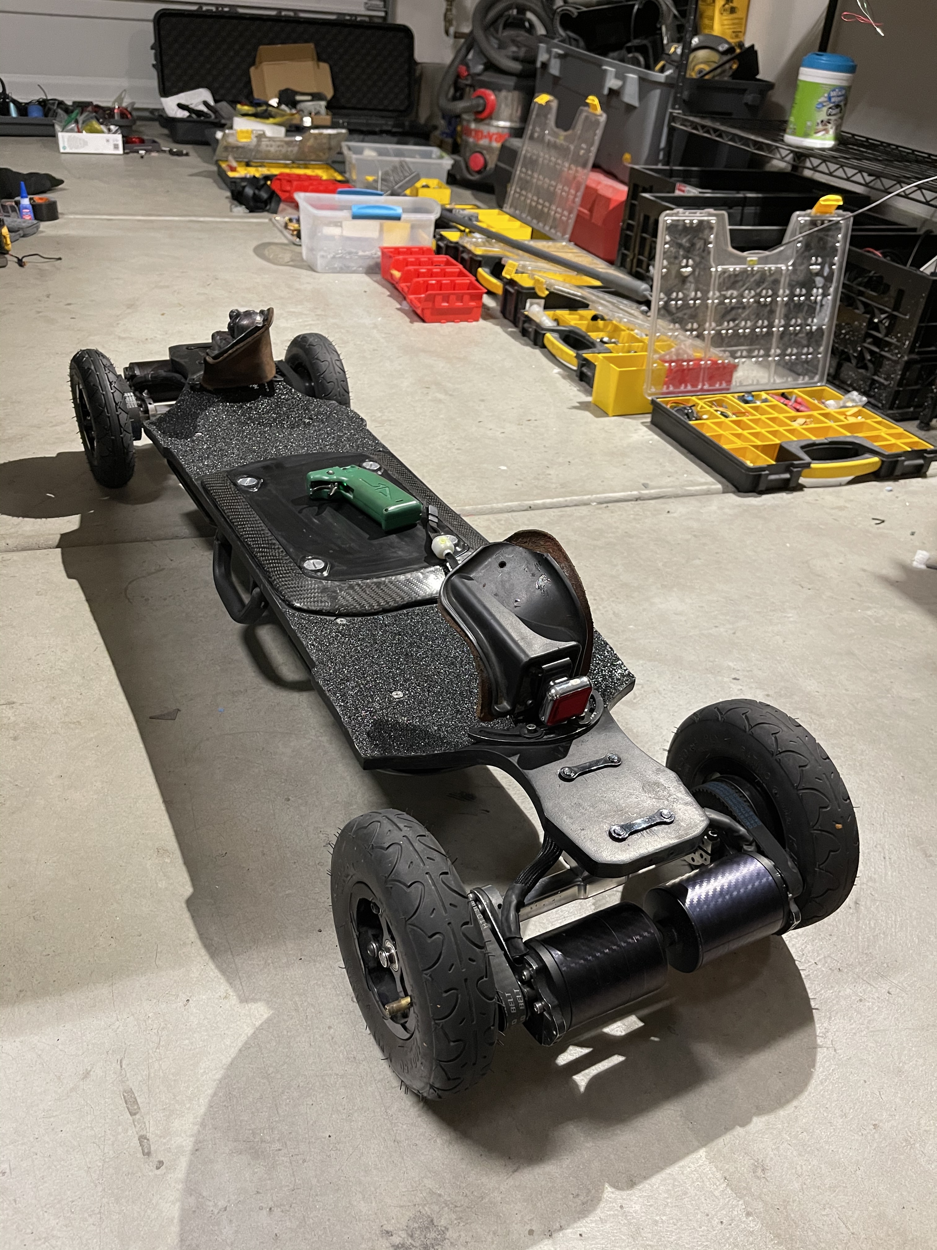

6389 x 8 | quad unity/stormity | 12s/18s tattu | RedEmber 44
I didn’t say you could see it
There are two risers made of wood and fiberglass. It is not typical.
Sensored superquadro is a go.

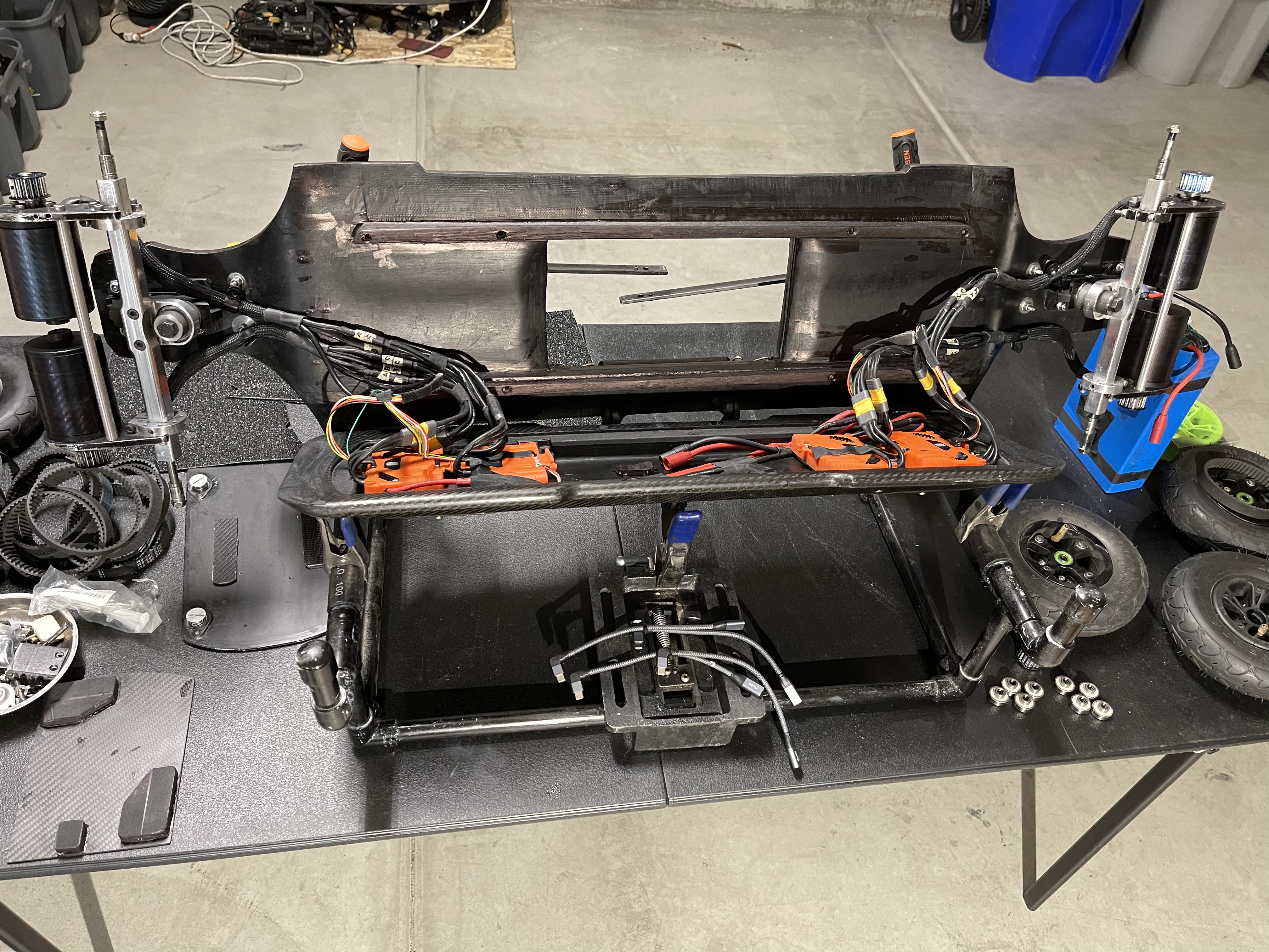

I might have gotten lost, but where are the 8 motors? for few days we can see only imgs of your 4wd with 4 motors, albeit with dual parralel unities :smiley:
more motors doesn’t really mean more speed just more sustained acceleration (besides traction). Moar ESC does mean zoooooom
you mean that you have more power you can deliver? because motors are afaik limited only by temperature
yeah the motors are the limit, hence trying to add 8 but they aren’t really overheating on him as far as I know.
I guess we will see on these tests.
You were missed at Barrett :slightly_frowning_face:
This is a pitstop enroute to 8 motors.

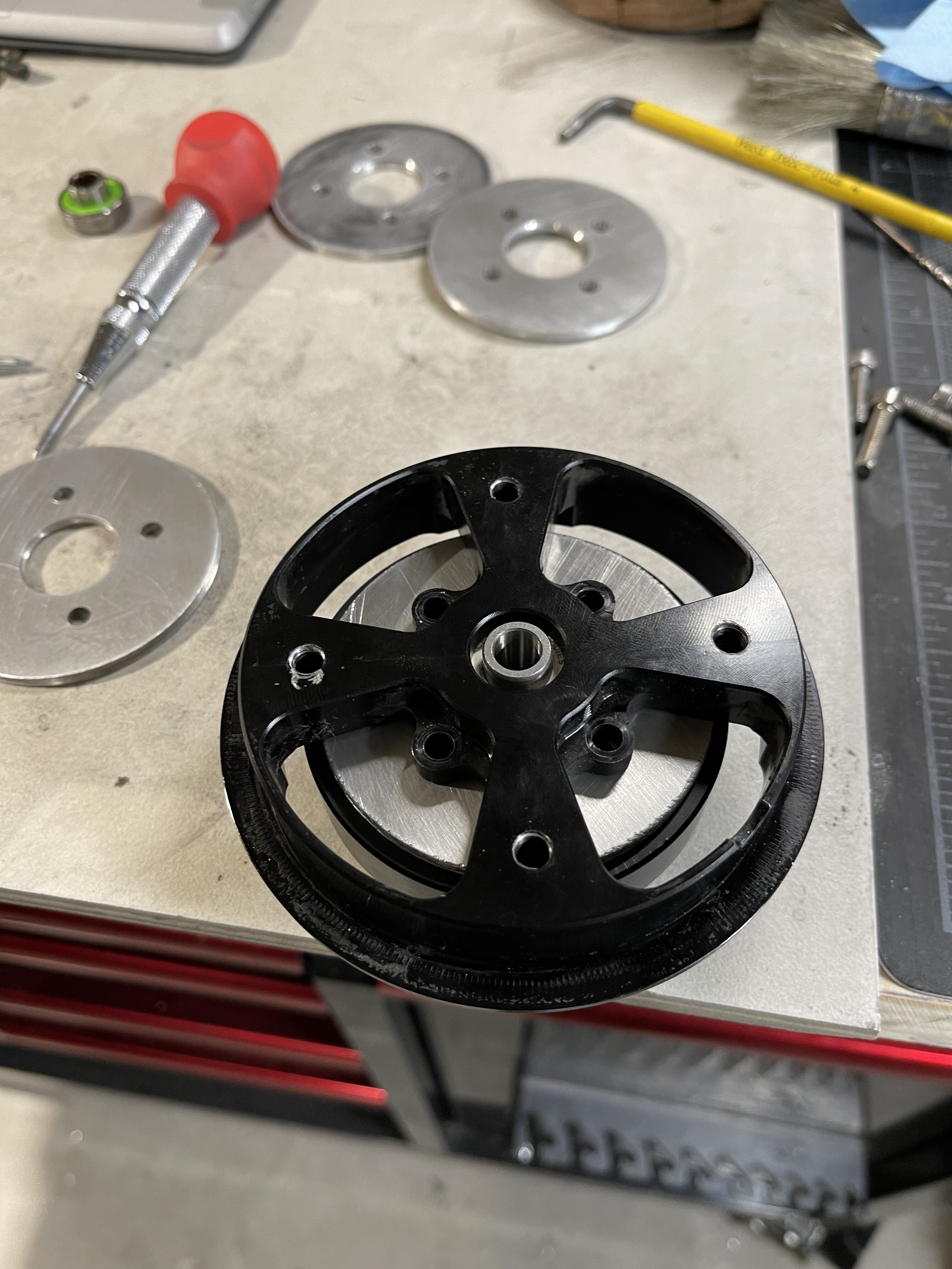

I accidentally lifted a tire up and it spun out. That and my belts are about toast. I just bought all the belts off royalsupply.com. Even the dumb ones.
Gates Poly Chain GT Carbon, powergrip GT3, and powergrip htd.
