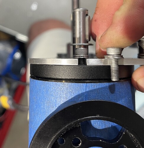

If its the screws again!

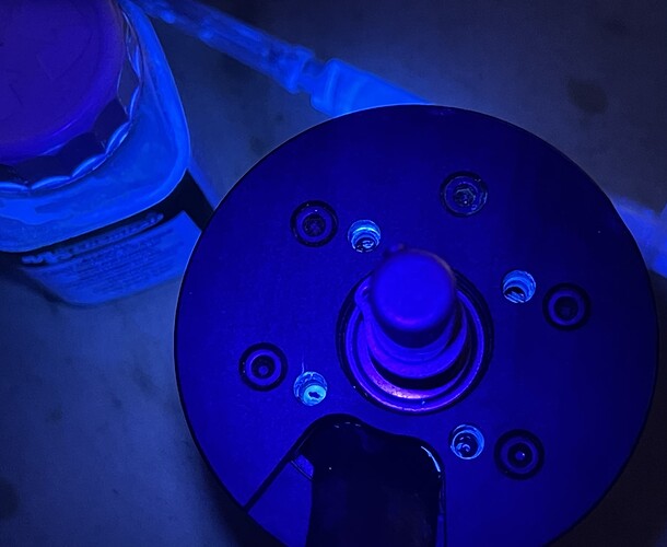

M4 fasteners are only engaged in threads by 3mm. Indeed, on the fire motor detection incident, they were too deep (but not by much).
I got a so-so look at the underlying coils and wire. No brunt coils. Enamel appeared intact, couldn’t judge if coils were mared or dented.
I did see an imprint of a fastener bottom molded into the heat shrink on sensor wires that run just below one of the mount holes.

I squirted conformal acrylic in the bottom of the mount holes (MG chem #419D).
I’m not worried about the excess locking my fasteners in, shit will buff out.
I didn’t not do motor detection until the acrylic was dry.
