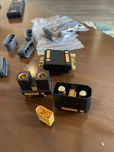

I did not expect them to be so big.
@MoeStooge @JaysTCB Need a loopkey you can use with y’all’s 8 and 6 gauge wire?
:joy: in this instance, size matters
I’m not going to pretend like I need these. Seemed like a good idea at the time.
6 gauge is pretty thick, had a hard time soldering 8awg without melting my connector, even 100w iron took some time to get the solder flowing

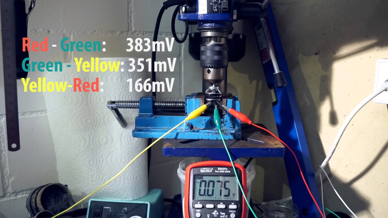

I did not burn my stator coils with that fiery double motor test. the driving Unity ESC is acting funny, but the motors test out okay with this style test
I am pretty certain it was a ground insulation short from only 2 of the 8 motor set screw involved during that test.
I couldn’t get the entire motor mount face off to see all of the coils in the danger zone near the 2 longer set screw, ill look with a borescope and macro lens tomorrow.
I’m tempted to drip an electrically inert product down there with a syringe to patch up the motor winding enamel I know I disrupted.
Acrylic conformal coating would do you well, methinks
@BenjaminF I got my MG conformal magic bottle at the ready.

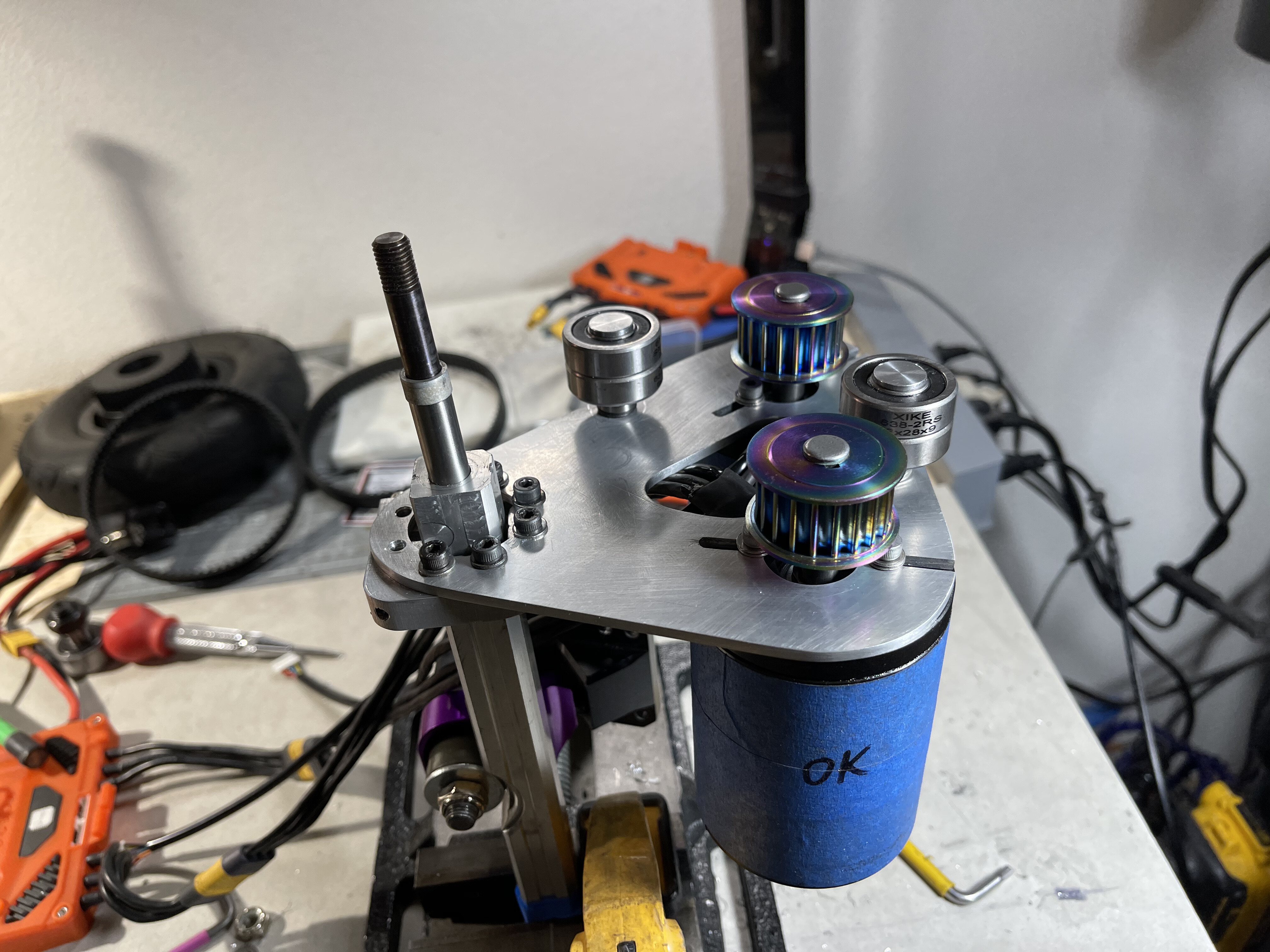

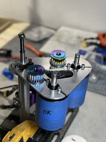

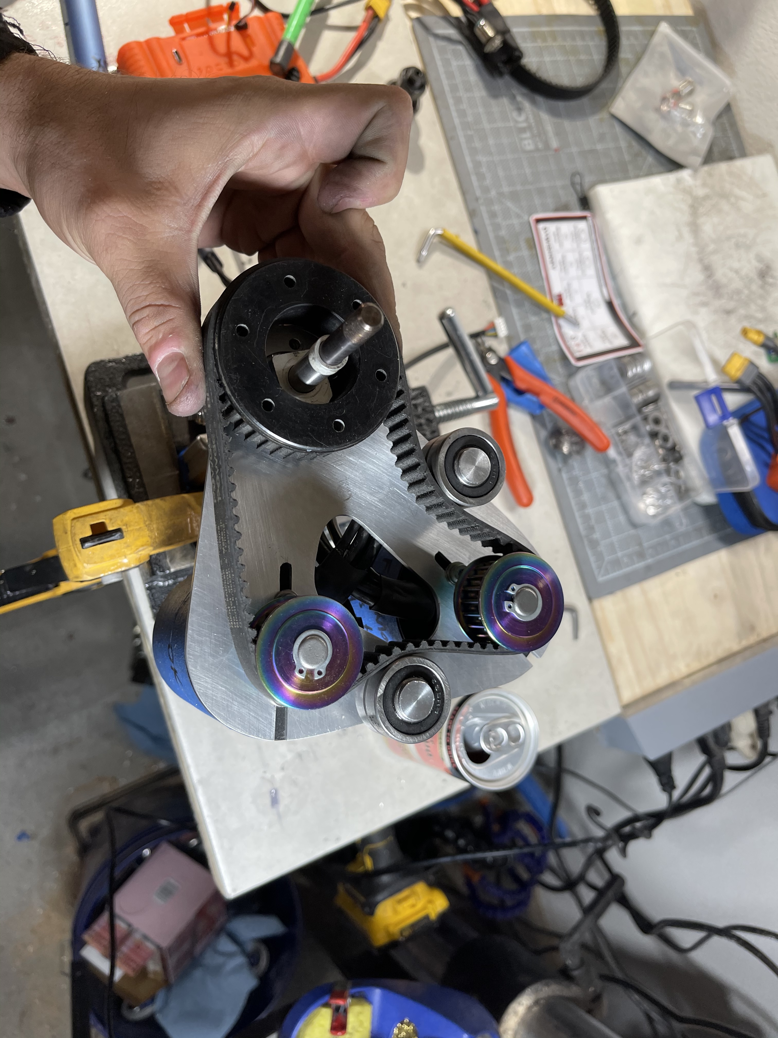

I did a thing. Finally.
Fucking huge :raised_hands:
that circlip mounting is so sexy :mechanical_arm:
Motors, belts, pulleys, c-clips are all from Lacroix. :ok_hand:
I bet that Radium dude could whip you up some crazy nice and strong mounts later on.
Dude, I was literally just looking at his insta, thinking the same thing.
