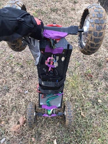

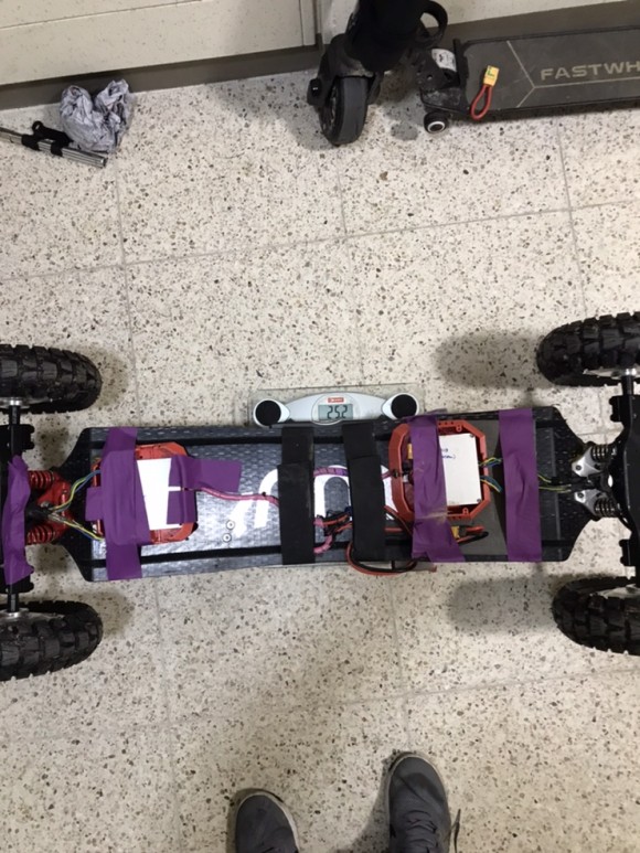

without battery. 20.5Kg
with battery 10S/20AH 25.2Kg

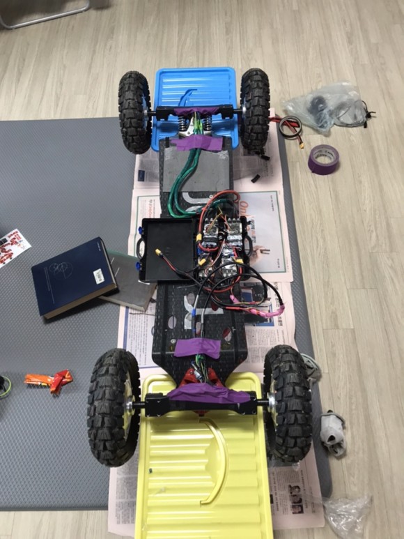

10 inch Offroad tire
I need to move the esc onto the deck.

Hi @bobyhack,
Thank you for your suggestion. I’m interested. please let me know.
You can change the configuration of the motor.
There are 6 wires inside
and 3 phases
each wire is a start or end of phase .
At the moment they are in Y setup , you need to unsolder them and connect them in Delta setup .
You should do the delta configuration for speed !
Hi @bobyhack,
That’s good news.
Thank you for your information.
I’ll try later
