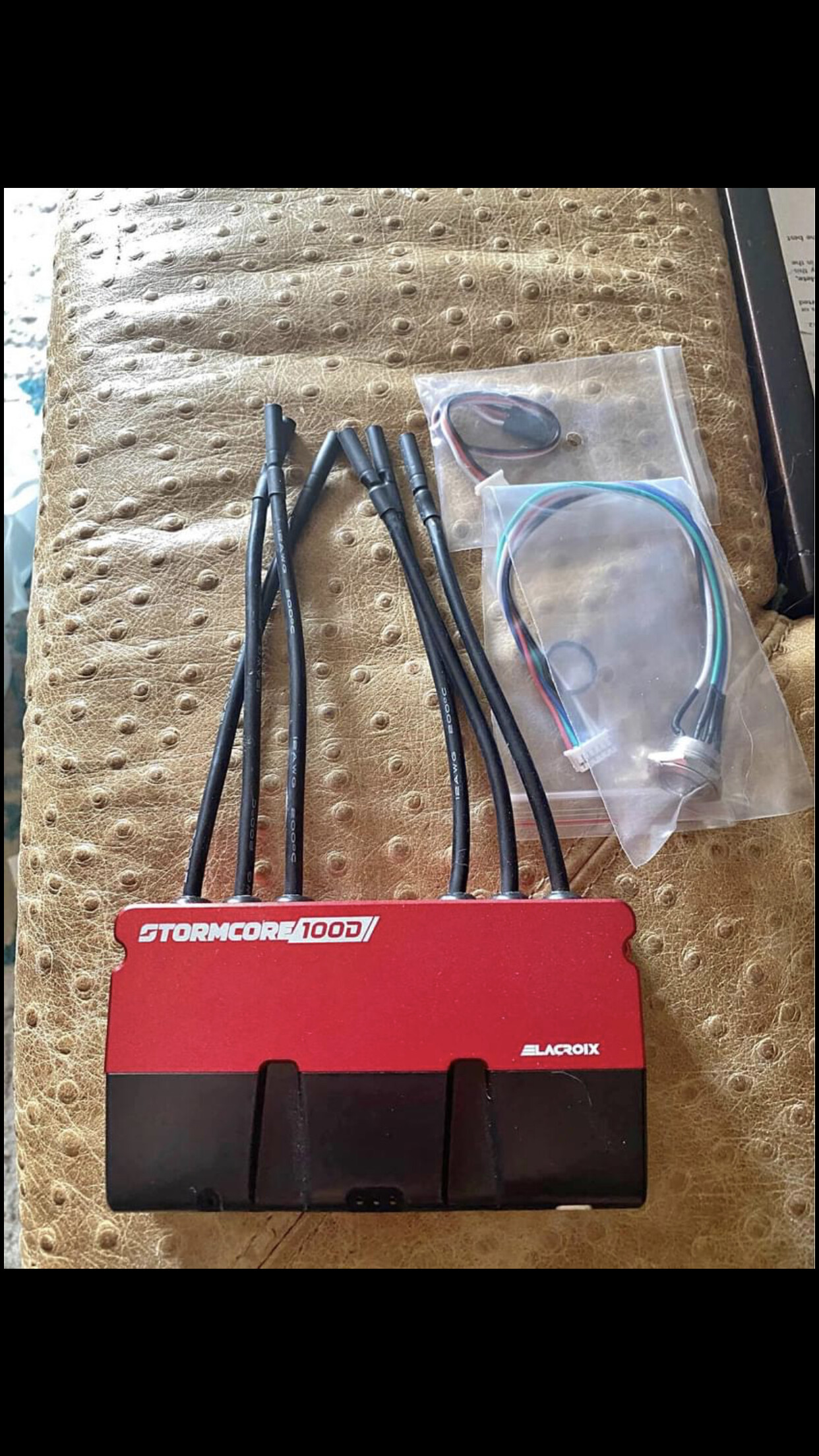

First and foremost battery update. After much thought, debate, and decisions made on a payday, I’ve decided to go with a 16s8p. (Then I bought a 18s5p instead) So I’ve ordered the below, stormy is off FB marketplace gotta deal on her.

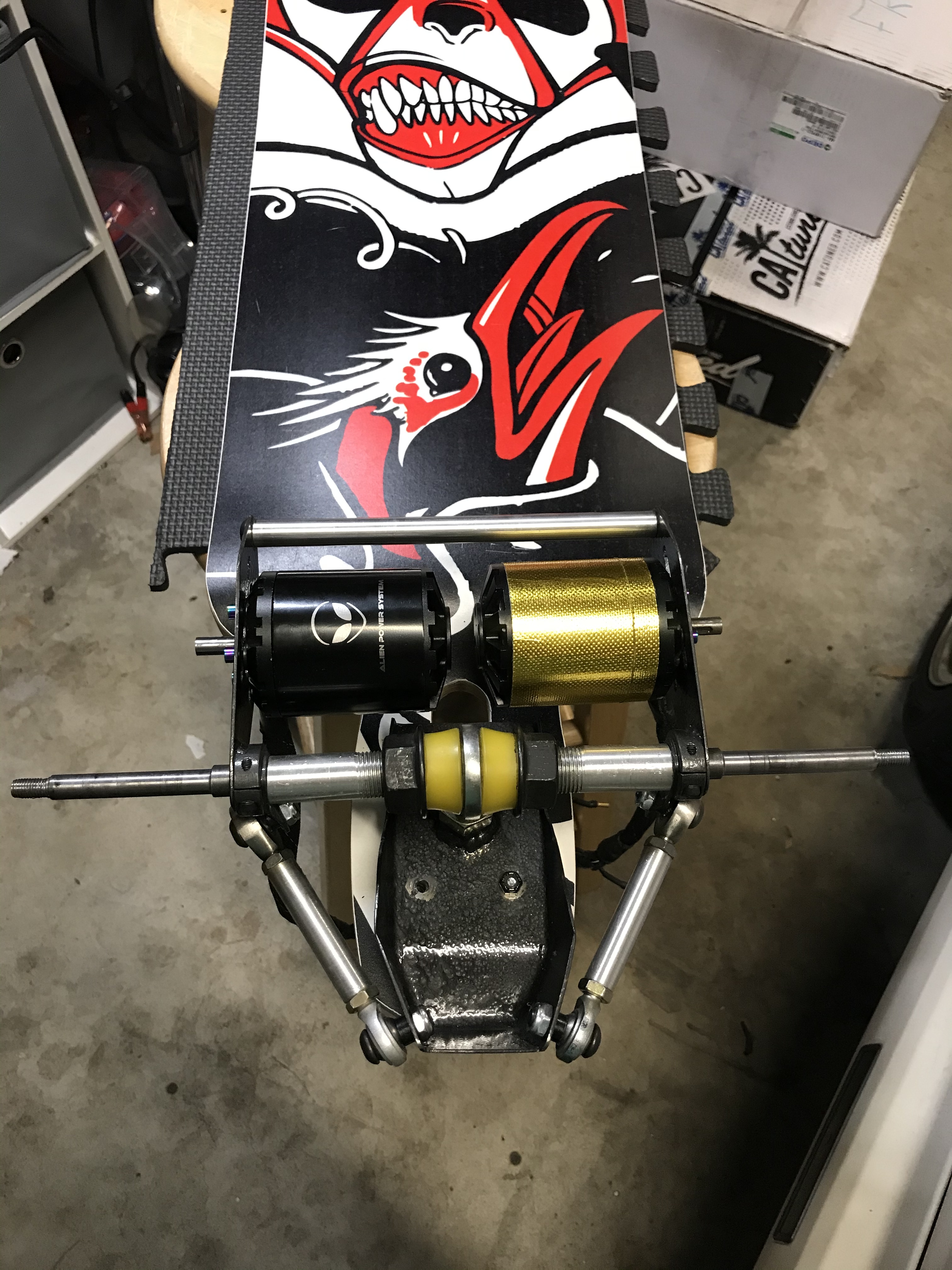

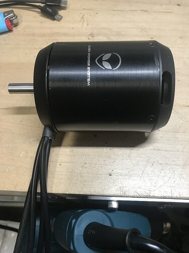

Now to continue to blow up my intended motor plans. I test fitted dual 6384’s and confirmed they fit real nice:

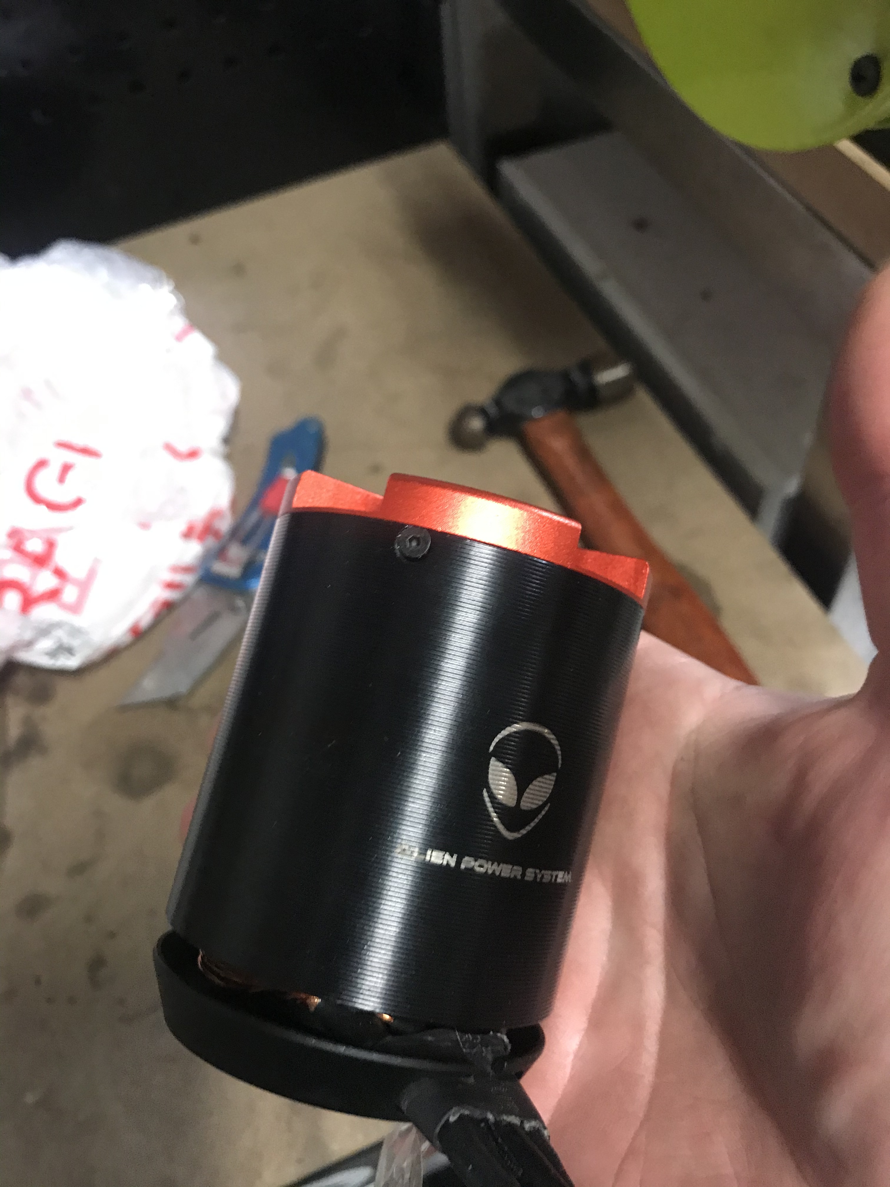

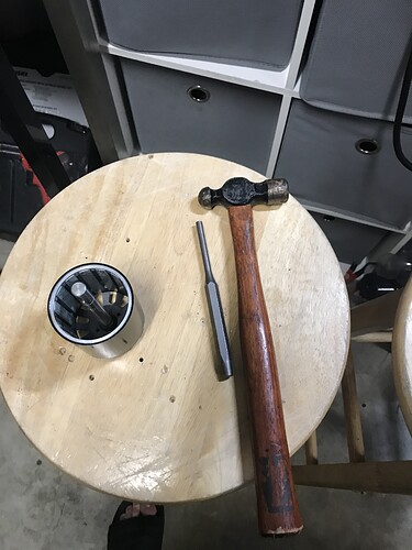

My problems: had either 170kv or 200kv APS 6384’s in my hoard to chose from. But first I needed to fix one of them in each set. On the 200kv jawns I just needed to install a shaft that had been milled down to 8mm and on the 170kv I just need a new can b/c I had cracked the magnets.
So new can shows up for 170kv and it doesn’t match the old:
This is the old:
So talked to APS and they confirmed they changed their design and don’t have the old. The reason it won’t fit is due to the new designs axle holder being longer than the old, thus it hits the bearing to early. APS says this can be remedied by taking it to a fabricator and having them grind it down a bit. Sure this is true, and something I’ll likely do/have done but that still leaves me with two motors’s cans that don’t match. Ain’t nobody got time for that on a build I’m now apparently spending money on.
On to the 200kv issues, motor shaft went in no prob with a little coaxing.
However upon detection I get a horrible screaming noise and can’t figure out why. It detected fine twice but then when I went to spin up the motors with throttle it started screaming. Then wouldn’t detect after that.

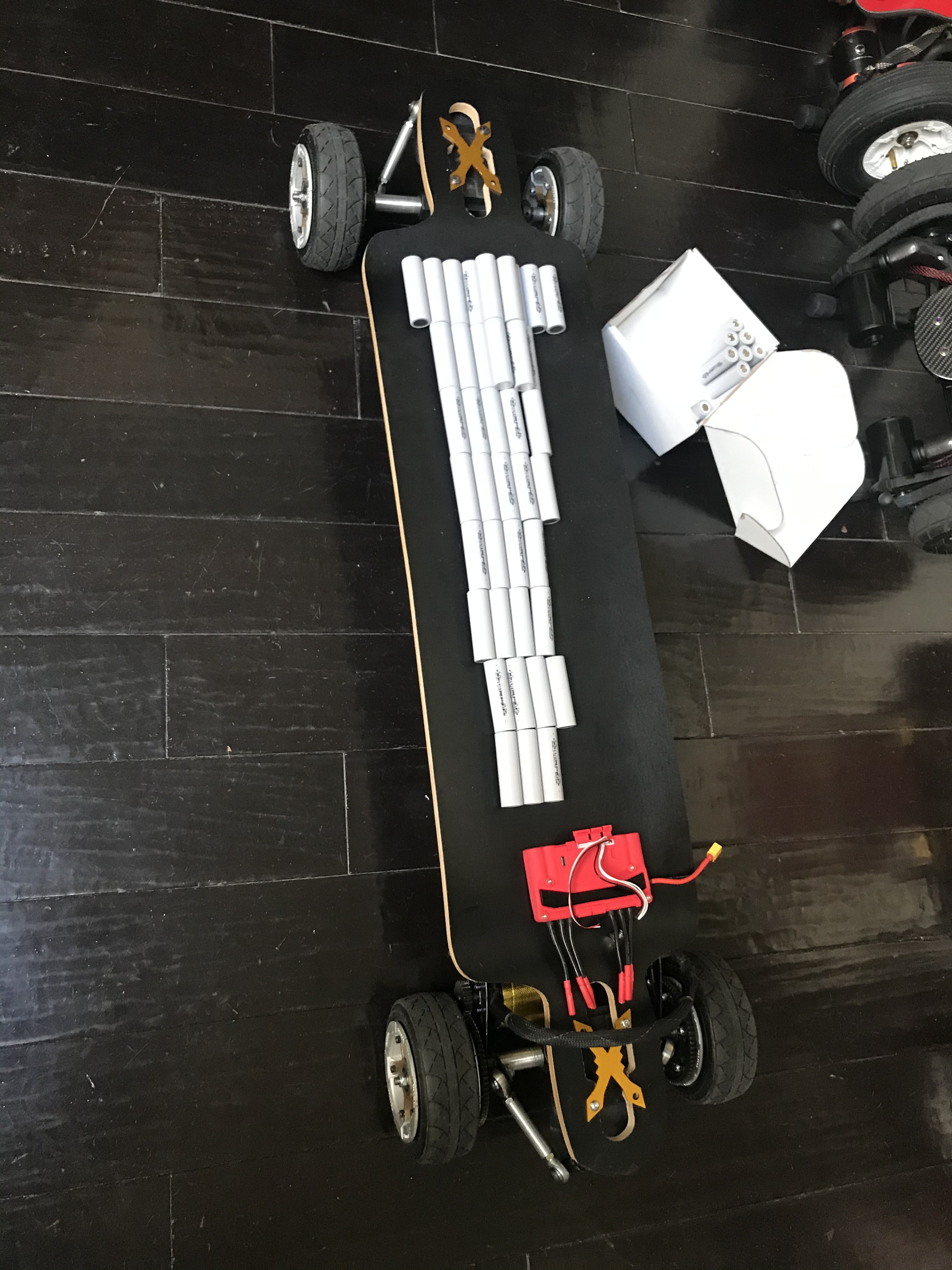

More weekend pics:

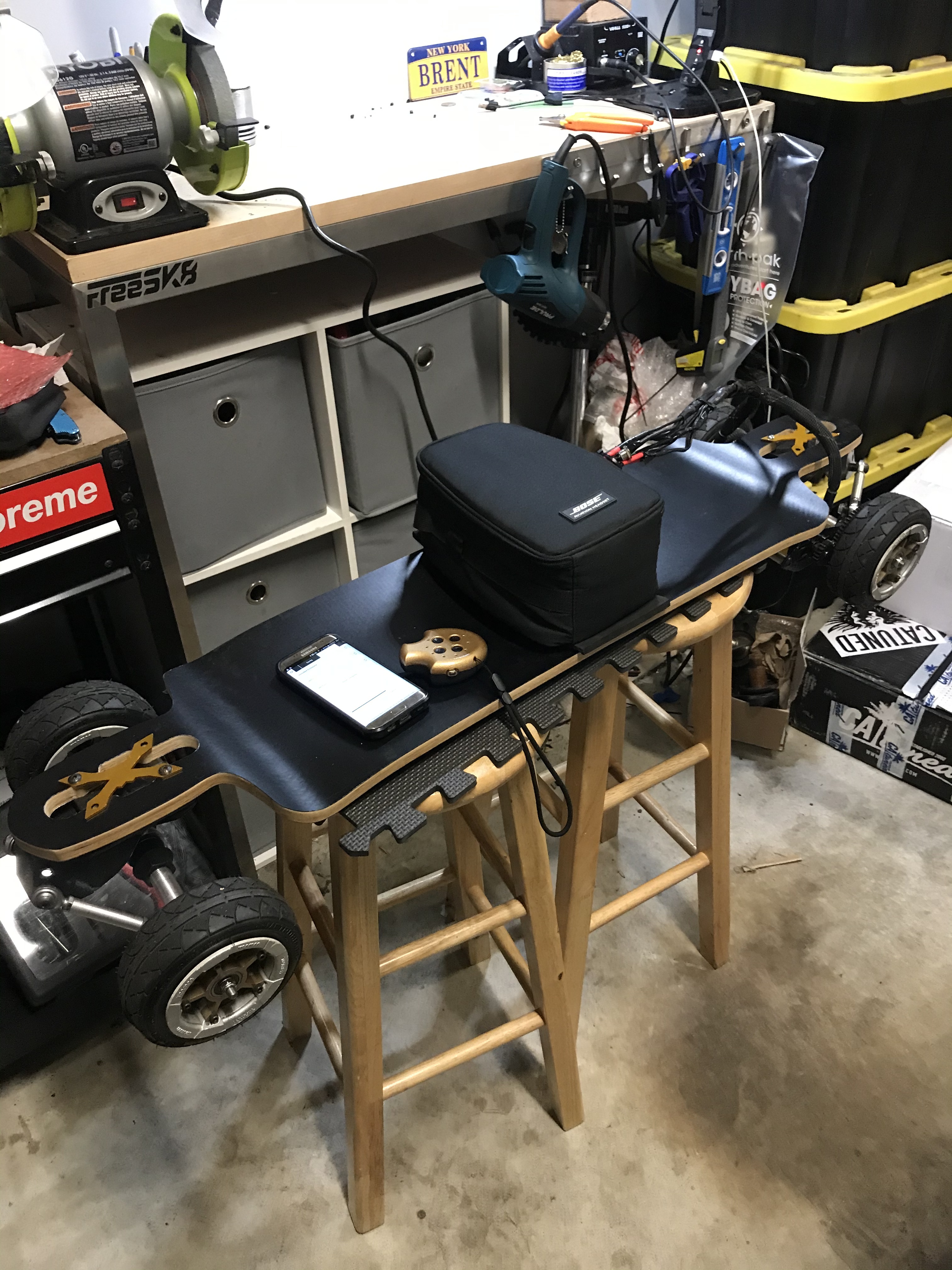

Thinking I can get away with this 16s8p layout, xenith used for mock up purposes-
I also hooked up a 10s5p 25r pack I have to the one 200kv motor for a quick test spin this weekend. Had no balls but this deck/truck set up should be quite fun once I get some speed in her.
So you bought the SC? When are we gonna brainstorm my mans
yessir and can’t today but we should at somepoint this week. I have thoughts/questions about the battery - potentially thinking splitting the enclosure into two levels so the BMS and ESC can sit in their own tier. I’m worried I’m going to hit motor mounts if the enclosure is long enough to lay the ESC and batt flat. even if the batt is double stacked

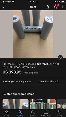

Bought Art’s 18s5p p42a pack and century 40 enclosure he had for sale. It gets here next Monday, gunna need to do some finessing to get the enclosure to work but should fiiiiiineee. If not back to the drawing board but all parts are either in the mail or in my possession to get her going.
edit - all those tesla cells I had for this are going toward a ebike build. Between that and this and my e30 projects spring/summer is gunna be dope.
