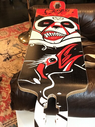

I have got my hands on probably the last NOS 2011 Rayne Demonseed in the world. I bought it off eBay all the way from Japan. It’s so clean I almost don’t want to build it… almost.

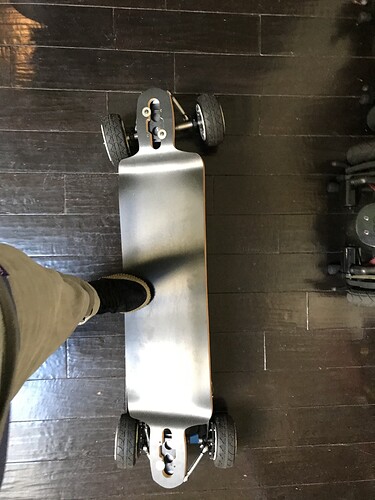

Ok work is slow so @rafaelinmissouri I got yo pix early brah:
As expected she looks dope. I have to run a 1/2” rubber spacer to not hit the deck with the trucks
Other clearance potential problem is on full turn I hit front tires a little (this is with the 3links in the most “turny” setting in front and most stable setting in the rear). So with a middle setting on both I’ll prob not tap.
I could put some more holes in the deck and mount the front trucks more forward but would like to avoid that. See second pic above.
I do have a few more mm’s on the axel if I get some spacers for the front truck too:
Here’s some more general pics:
Why do the drop through cut outs look so weird? We’re they done by hand?
If they are 44’s like this one I would buy those man - those are the 2017/8? graphics which was the last run of the 44, I have a 2011. Rayne has confirmed they aren’t making the 44 again for their coming releases.
edit - just tripled checked those are 42’'s at the shop you quoted
no idea this is from 2011 production so maybe less precision milling? dunno mounts fine/straight - I will for sure be getting those x plate thingys for final install.
