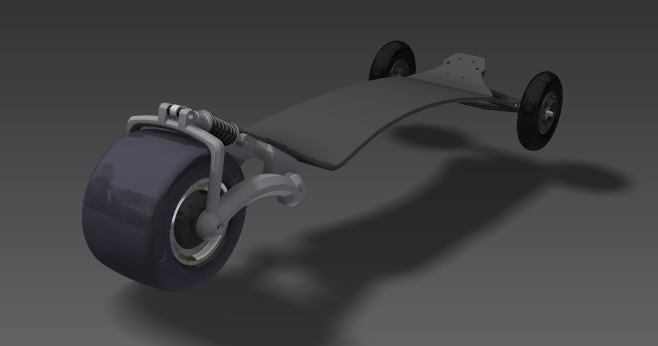

I’ve been tossing around a similar design in my head for a little bit using a single rear FloatWheel hub motor and decided to start putting some ideas down on paper:
Bindings & topmount would be in use here ofc.
