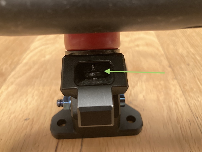

Sorry for asking again: is it better to remove the nut with @rey8801 baseplate or should I leave it in or does it not matter?

hi! not sure I get what you mean with remove the nut. Which nut? Maybe post a picture about it.

I got it wrong, I think: I initally thought that the nut (siehe green arrow in pic below) may not be necessary, since there is a (internal) thread for the kingpin in your baseplate that could also fix that kingpin?

there is no internal thread you need the nut to tight the kingpin securely
