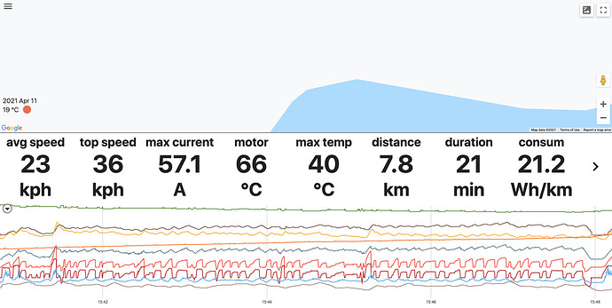

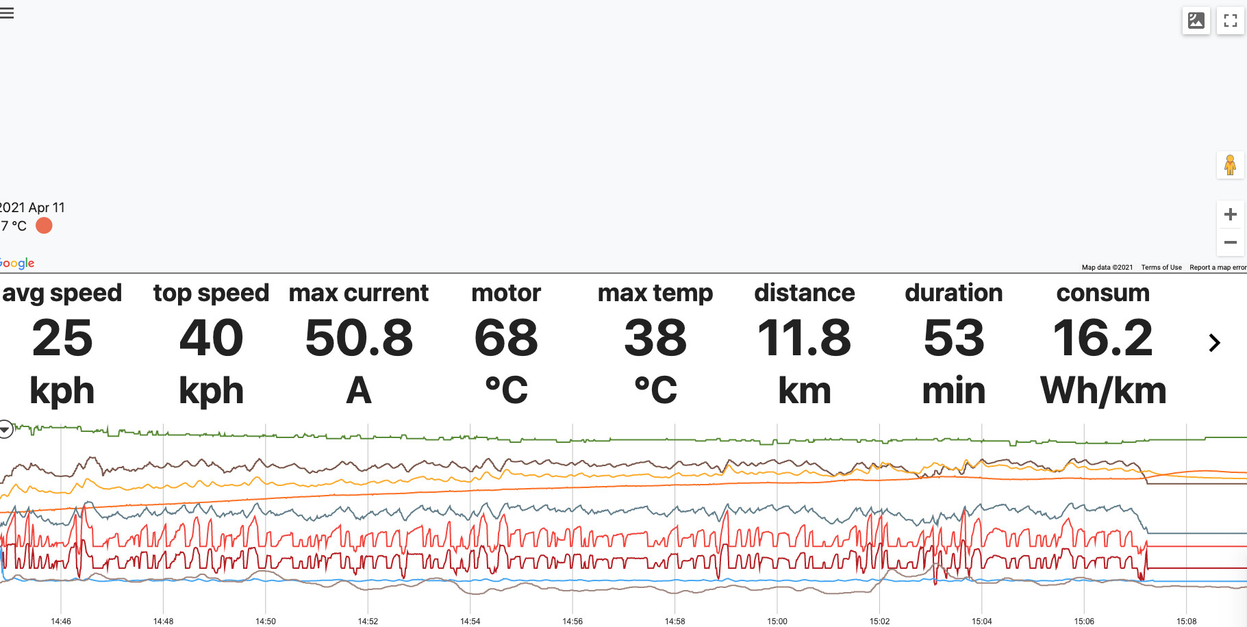

you can see the difference here, it’s actually quite significant, but honestly never having to change the bearings + easy tire changing is worth it. The amount of time we DIY’ers hear a sound and are like ‘‘hmmm, what’s that noise’’ and most of the time it’s a bearing.
Edit/ Whoops @tipsy i misunderstood the logs, but the difference is still there, at least in freeroll. In terms of efficiency wh/km, i agree, it doesn’t change much at all. :call_me_hand:
First log is going forward and the second log is going back on the same trail. This is consumption with Finality and 9" tires and a heavy 12s10p battery.

With the seal . :laughing: :rofl:
Then they have overtightened the bearings. It must be really precise, like in cars.
