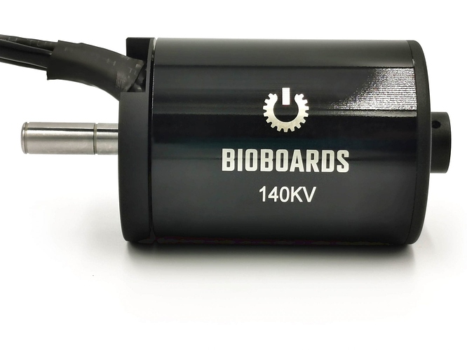

You mean these? Do they fit with the fatboy 320 eco drive setup?
These will fit 320 ECO no problem.
wait⌠they are 10 mm axle eco is 8 right?
Do Toruqueboards 6380 motor will fit FatBoy SS HD Straight Gear Drive V3 ? On other drives there is info that it will not but not in description in V3
The motors fit both SS HD and ECO gear drives.
ECO fits 8mm motors. For 10mm I would recommend SS HD.

any other options? A pretty uncommon gearing you choose for the helicals as there isnât that many motors with that low kw is there a special reason? Mostly curious
Most motor are 150-200 but lower than that it gets hard to find I noticed
