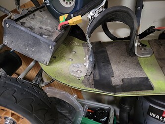

I’ve only experimented with temporary solutions…
Slab of rubber/foam/cushionny-material-of-some-sort beneath the outside of rear foot. It seems to help counteract the arch of the deck. For me it was to address a bothered knee (think bow-legged stance standing on an arched deck = stressed knee)… Though it did improve the foot fatigue for me too.
I wanna tinker some more (w/ different materials, thicknesses, shapes, locations) to discover an ergonomic sweet spot. I’m nowhere near imagining an elegant 3D-printed solution. I’m still in redneck, cut stuff with scissors territory. :crazy_face:

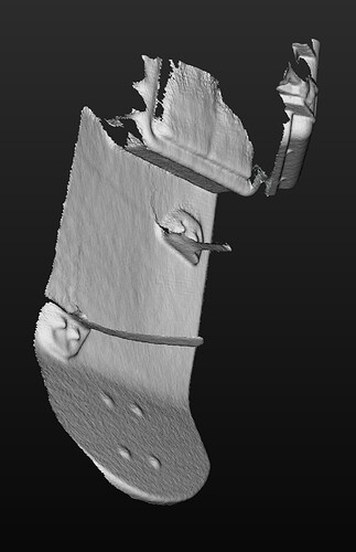

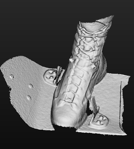

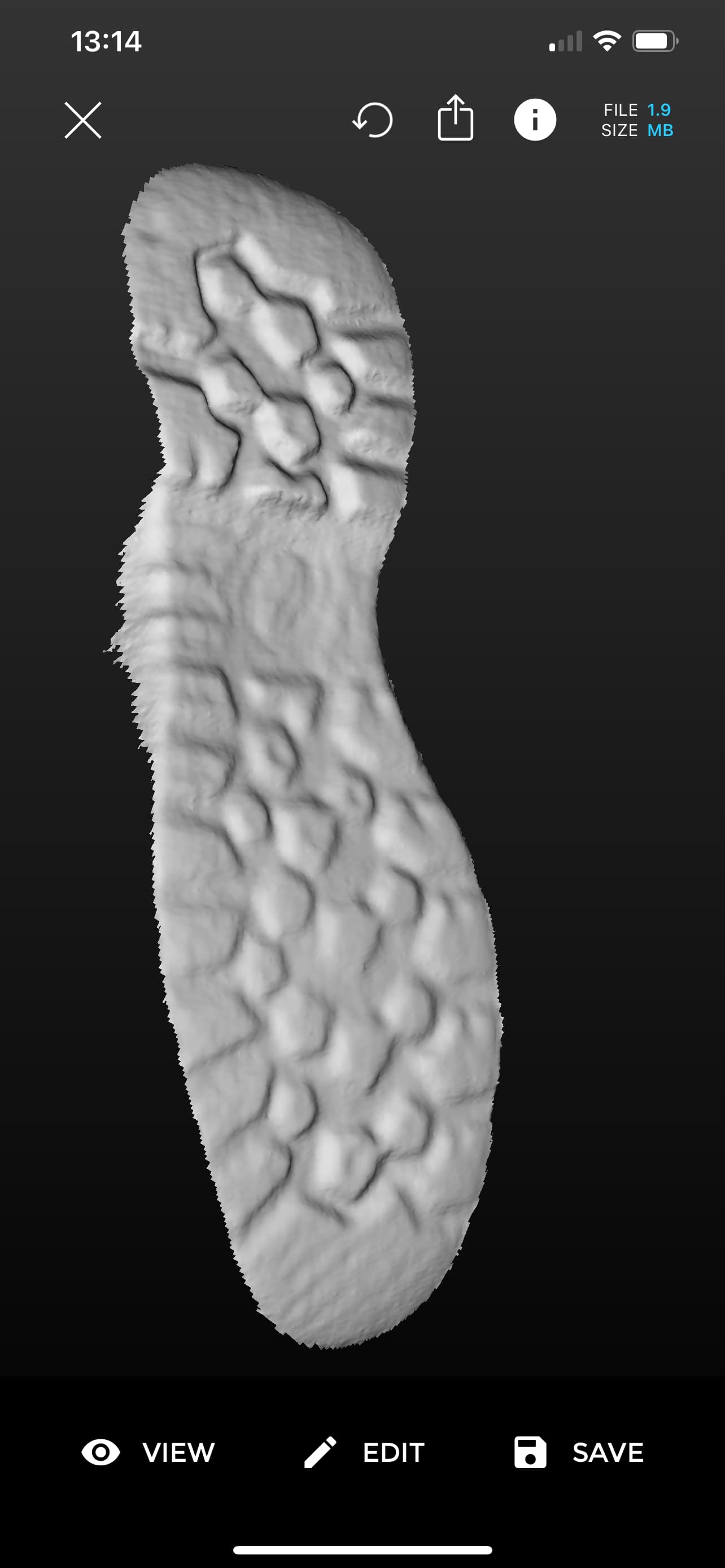

Off the cuff, what do you think about this?
Heges or Scandypro 3d scan,
Scan deck, shoe sole, stance on deck,
Meshmixer, stitch solid, do some booleans, take the shape of desired foot well,
Print it. I dunno, I’m no Dr Scholls.

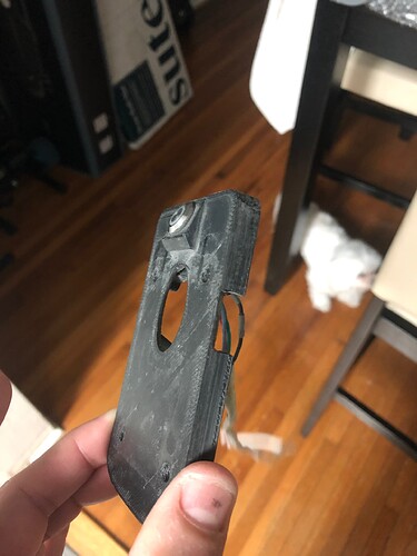

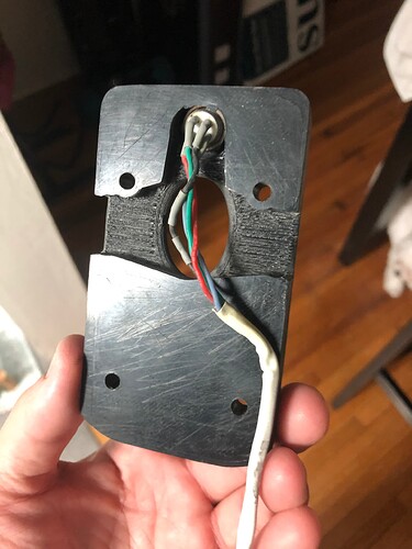

Could I entice anyone to help me design and print a pair of risers for the Haya deck? I currently have a set that are not tall enough.
I basically need this
but one with just the charge port, and another with just the power button, and none of the stuff for lights.
This is the one I have that isn’t tall enough. Its 9.5mm tall, need it to be 15mm. Not crazy about the button angle either since the connectors on the back get squished by contact.
