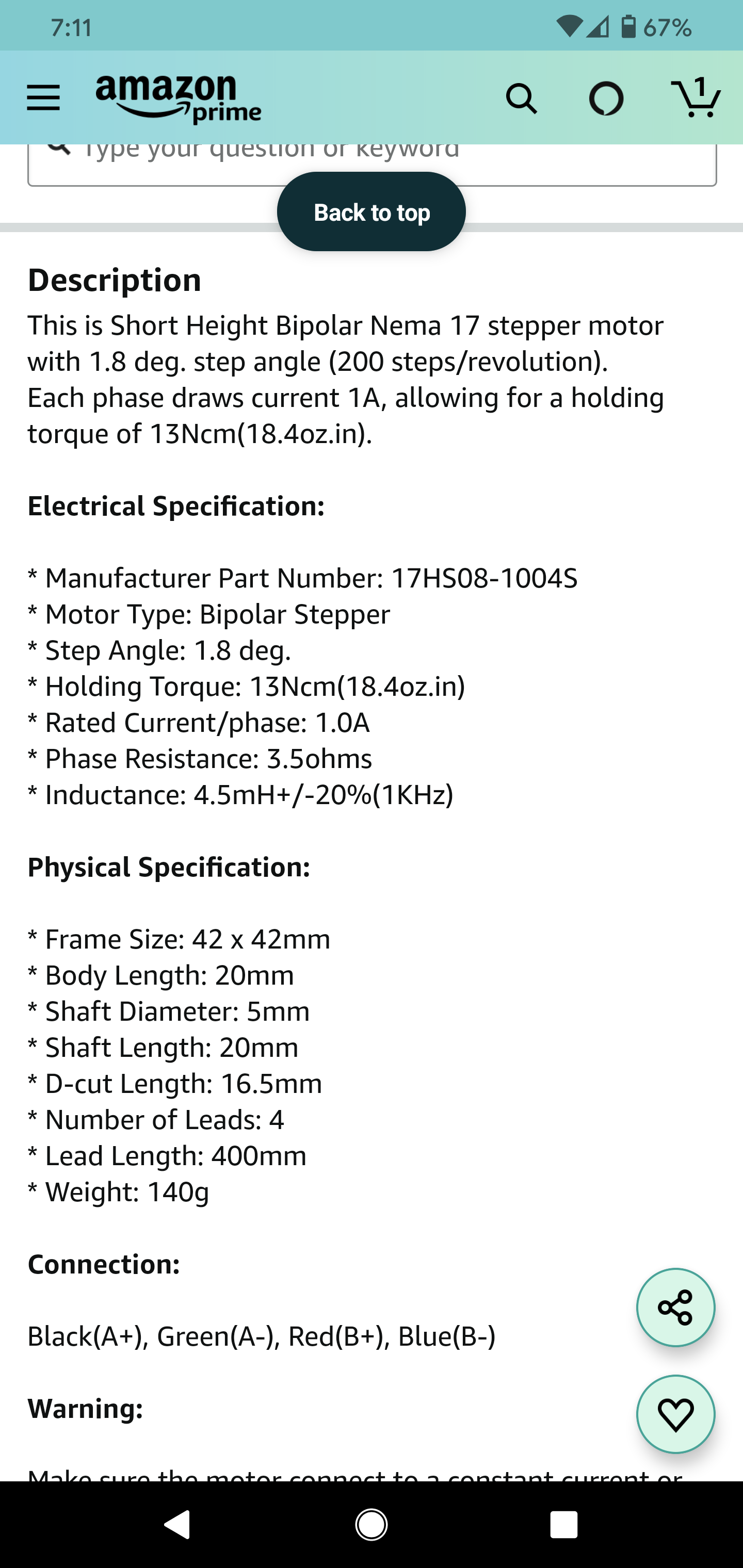

Got a weak ass nema 17 in a 20mm size and I was having to crank the current scarily high to get it to not skip steps. Pretty sure I could fry bacon on it at times.
Sure enough, the torque was rated lower than another nema 17 stepper in 20mm.

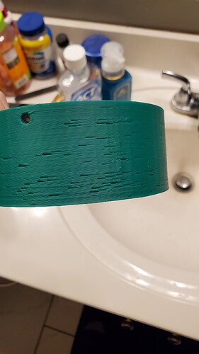

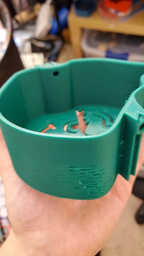

Had a few prints recently looking like this on the walls but only randomly.
I thought I must have put a bowden retraction profile on a direct drive printer and that was the excessive retraction. I resliced the file and it printed fine. Then it happened again on another file. I resliced the file and it still looked terrible.
Finally I sat there watching it and saw the motor skipping on the walls. I turned the speed to 80% and you can see the difference it made.
Just figured it was worth sharing in case anyone else has this issue.
Keywords for searching: missing layers, gaps, 3d print
I have a strong suspicion that you have a clog. You shouldn’t retract much in a all metal. It clogs easily.
Try to push filament in manually. If it is easy to do, then you probably have to replace the motor.
I didn’t actually ever retract too much on the direct drive setup though… 0.4mm is my go to.
The filament flows through easily still so I think it is the motor. I was watching it under torque and skip on those nasty spots. I also changed nozzles a few weeks ago and cleaned the hotend out while I was in there but will explore that again if my current hypothesis doesn’t hold up.

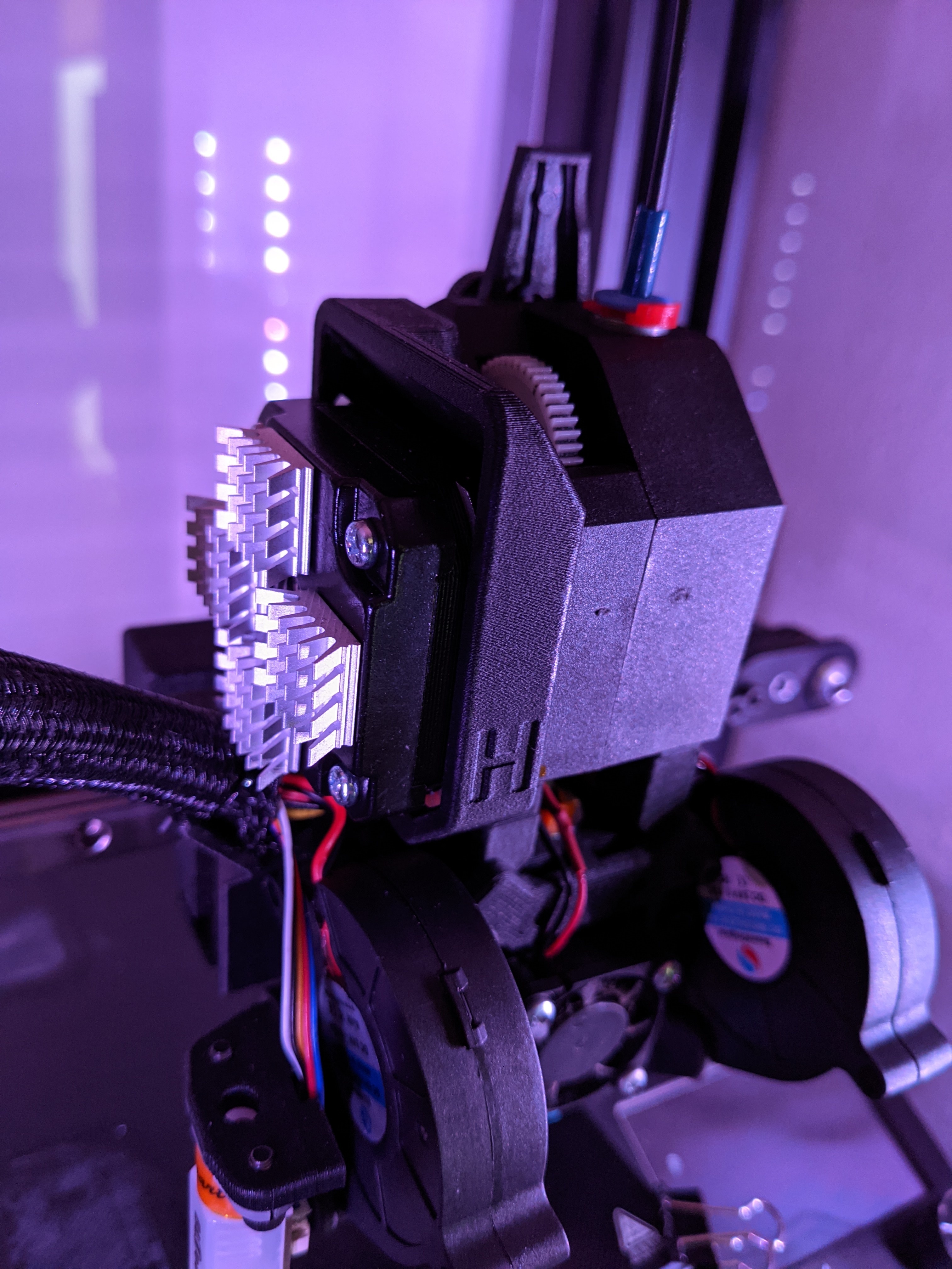

Right after we’re done cooking, I’ll go back in time to see what I did dude. I had the same problem if I remember right. Ended up using some little heat sinks that helps a ton too. Haven’t had any issues with this motor at all.
Bahaha I was looking at a handful of tiny heat sinks wondering if they’d do anything.
I stuck some little (like 40mm square) chipset coolers on all my motors just because I could. I know they’re rated to run pretty toasty, but cooler is better in my book.

I think I just got too weak of steppers for my needs. I had to crank the current to get any sort of decent torque to print and I’m scared to set them any higher without better cooling.
I got a slightly larger stepper motor with much better stats.
Old was 20mm and 13 Ncm torque
New is 26mm and 18 Ncm torque.
Any idea what yours are?
Looks like I have your old ones…

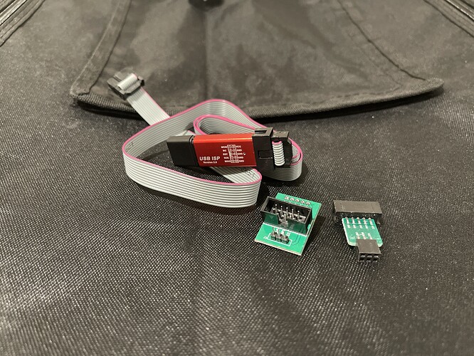

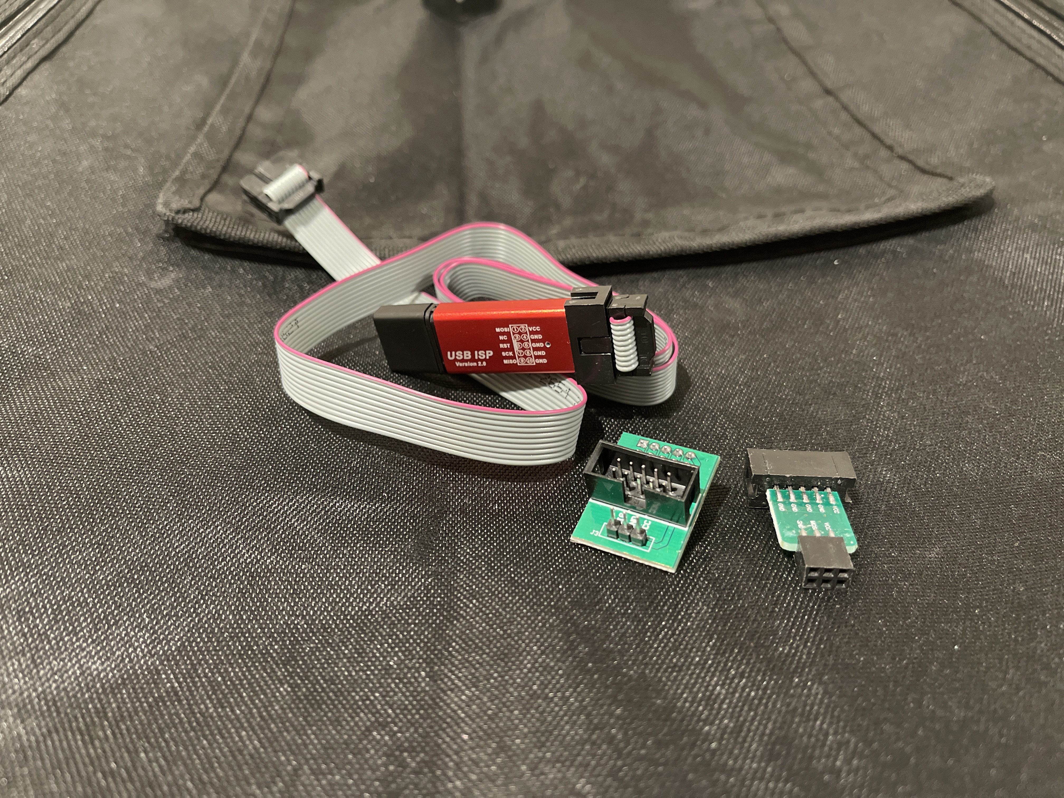

My BL touch came with this. I presume it’s for older creality machines without bootloaders?
Deja Vu when I opened the box. Where else in my life have I had to fuck with bootloaders till 3am (st link :unamused:)
