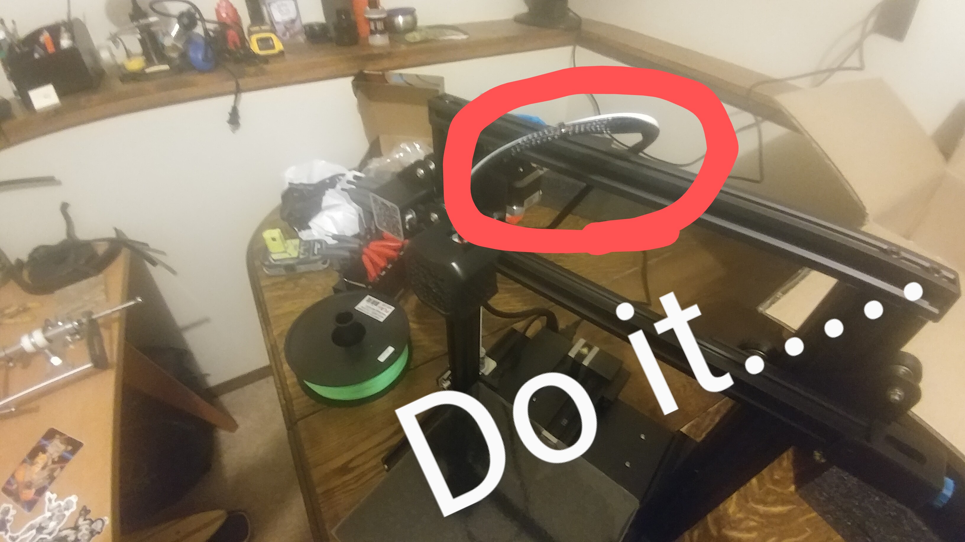

I’ve had the occasional more brittle roll… but it tends to be more niche or lower quality stuff. Extending the arc into the extruder so it doesn’t undergo too much bending works. As long as it’s printing well and doesn’t need to be dried out.

That’s def annoying. If you can’t add any more capricorn tubing between the roll and the extruder, idk what else would help. Once it snaps though, I’d just push it all through the extruder until the roll is back at the hot end.

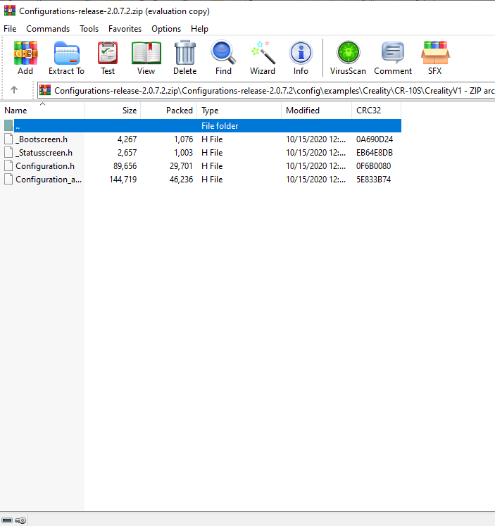

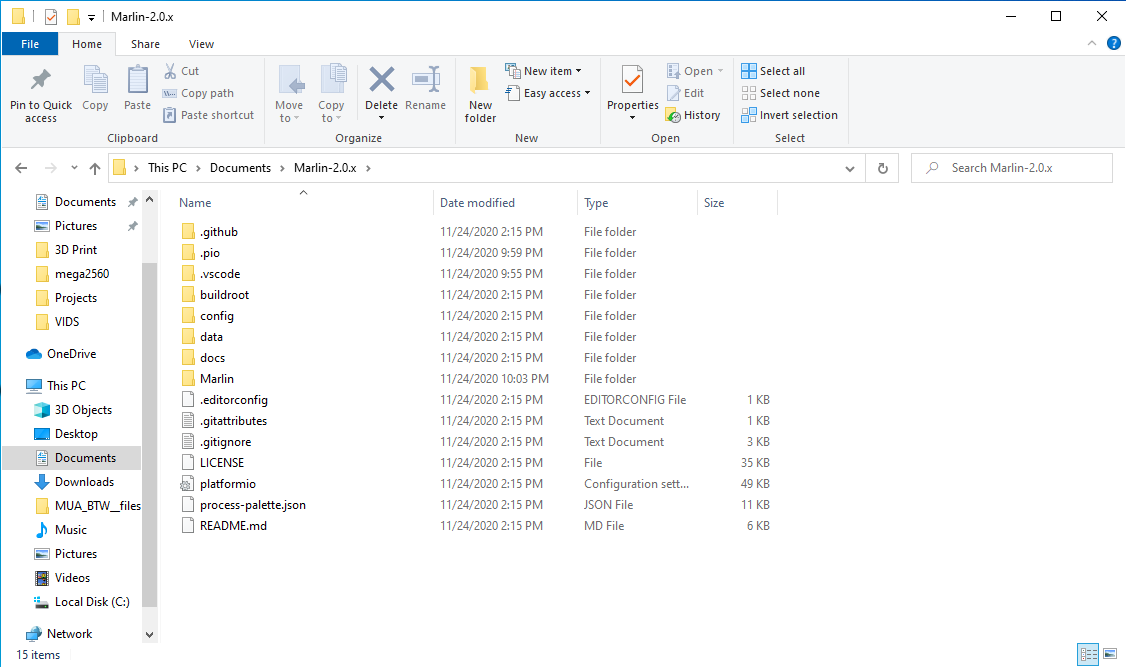

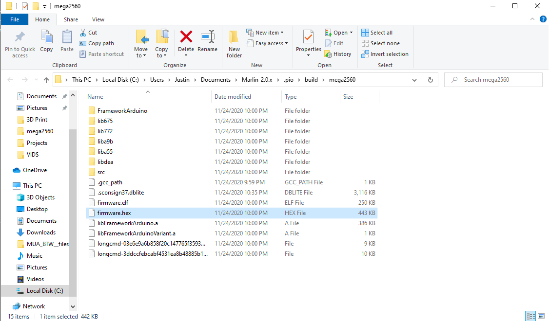

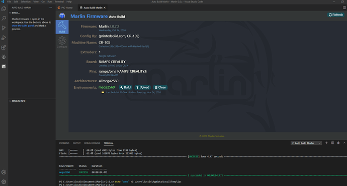

So trying to upload Marlin one more time and I have no idea if I’m doing this right
I downloaded the Marlin folder
Transferred over the proper configuration files for my CR10S Pro

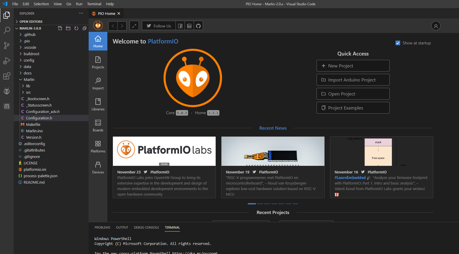

Went into VSCode to use Auto Build Marlin
Ran Build
and this is the result
Can anyone verify I did anything right? and if I did, what to do with the firmware.hex file?
This is what I found for your printer…
"You’ll find the firmware file at Marlin/.pio/build/mega2560/firmware.hex. You can use this with Firmware Updater to flash the firmware to your printer.
If the computer you’re building Marlin on is connected to the printer by USB, you can upload the firmware by running: ./buildroot/share/vscode/auto_build.py upload."

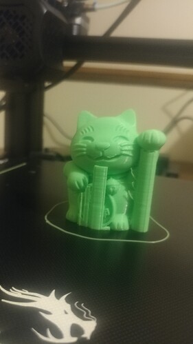

Inland PLA+ Demo cat print
I’ve always had the firmware come in as a bin file. But I also just put it on an SD card by itself and boot the printer up and it auto runs the update.
Looks pretty solid. I see a tiny bit of evidence of oozing so you might want to turn up your retraction just a hair.

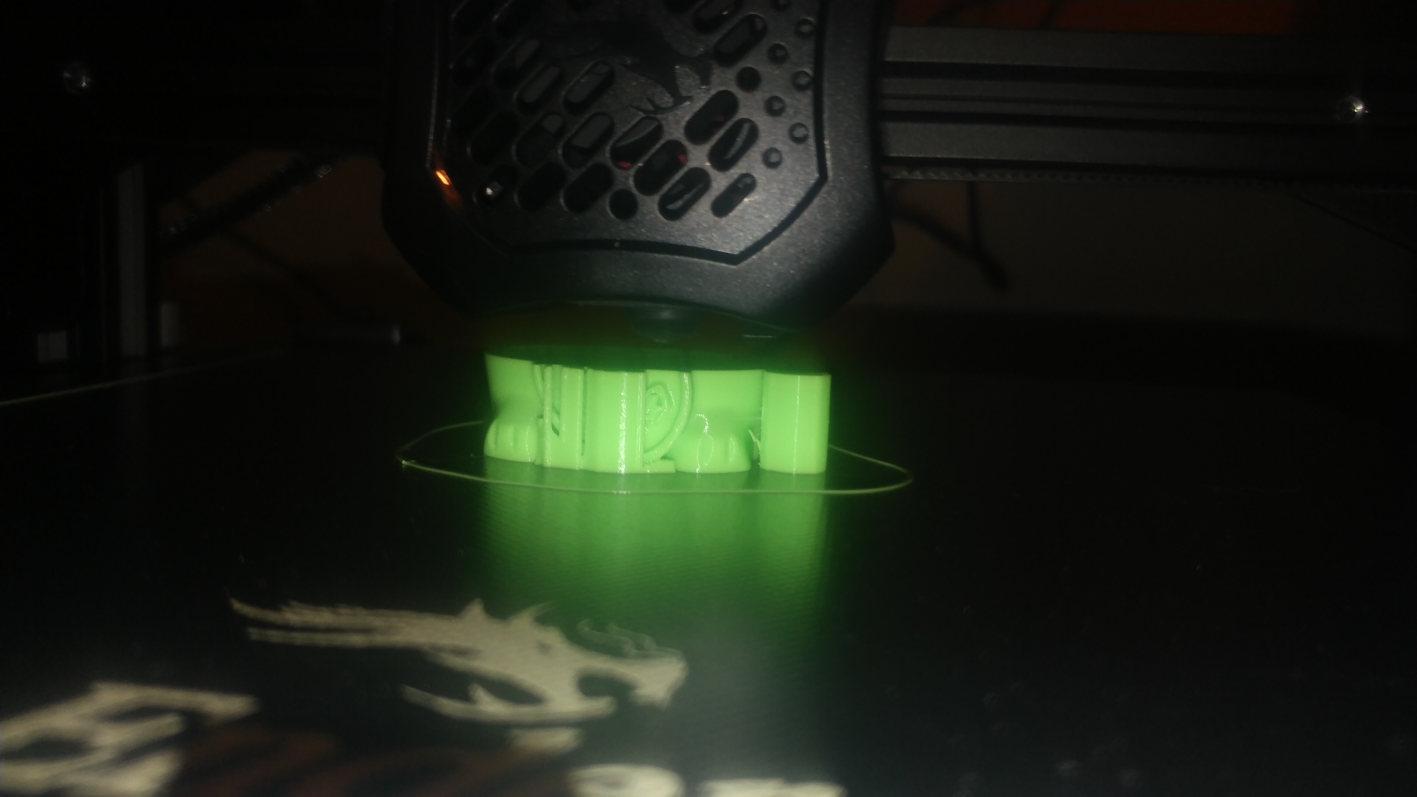

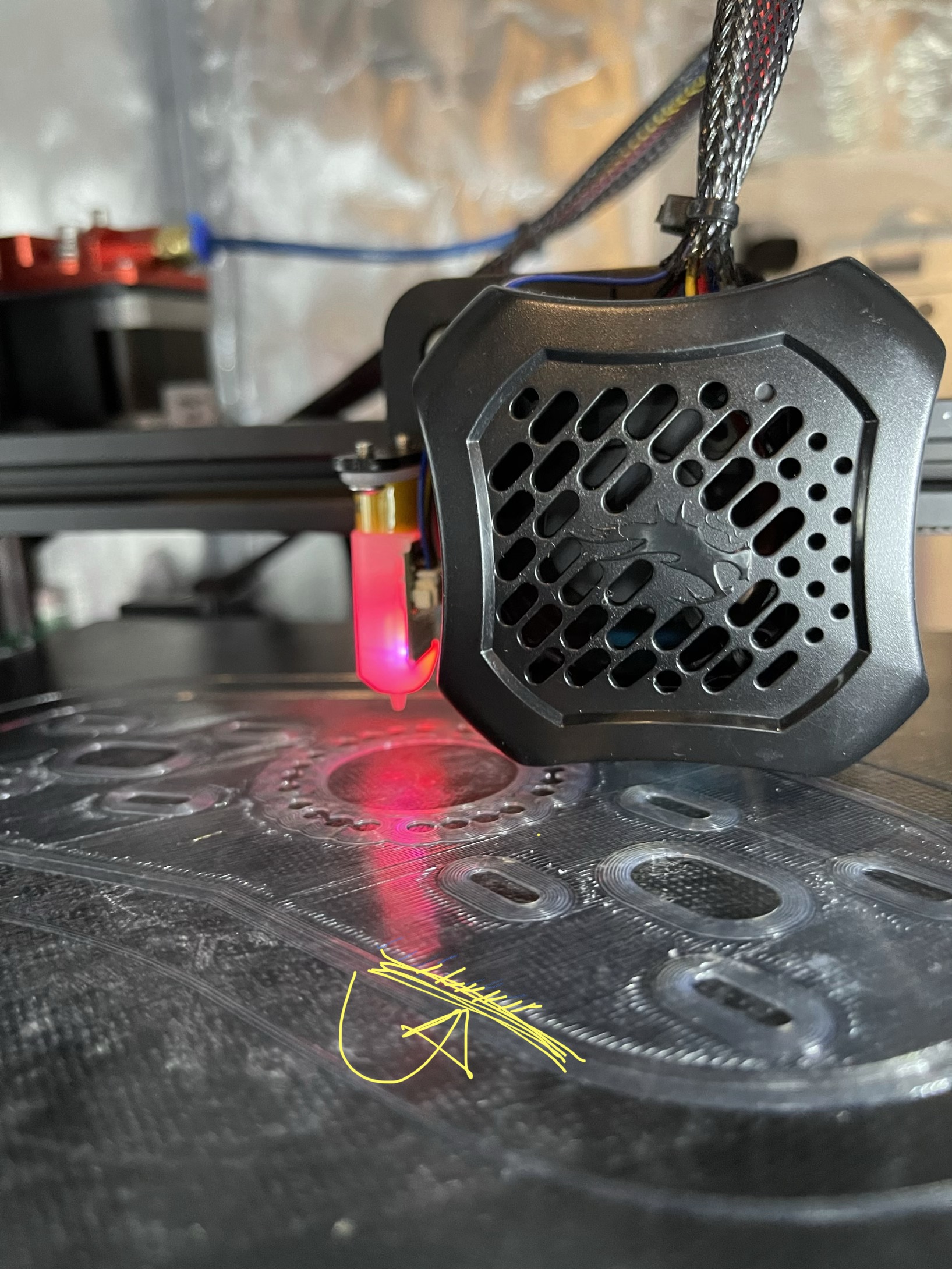

Are these perpendicular infill discontinuities due to bad retraction settings or under extrusion?
Not on direct drive yet. Printing slowish.
If they just happen on the first few layers but not on other layers, you can blame it on the bed not being level. If it happens on the top layers then the flow% needs to be reduced. It is overextruding.
