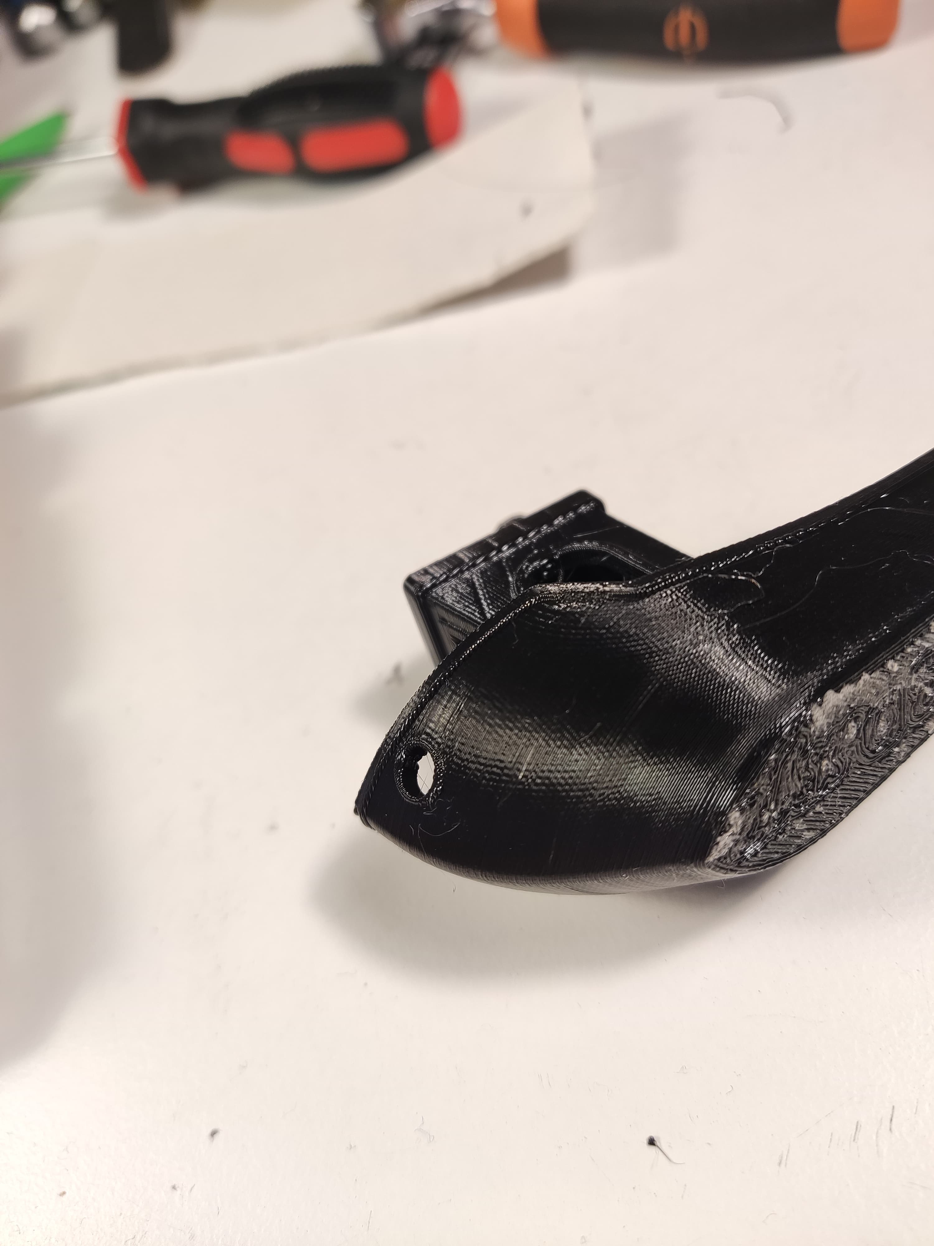

Modded Ender is finally up and running! Decided to go direct drive with a .6mm nozzle due to TPU’s limitations on print speed. Now to see if I can figure out how to glue TPU together… Print bed isn’t exactly big enough to print footpads.
First iteration - no spikes
Second iteration - w/ spikes for grip
Have since been testing mainly. They’ve been working really nicely. Actually borderline too good. I had to loosen my bindings way up to be able to slide out of them; otherwise my shoes would stick. @skate420 took them for a spin when we road some sweet sweet single track trails in her hood. She seemed to like them.

Washers give a more stable (i.e. steel vs tpu) mounting hole for the spikes
The spikes hold your foot in place really well! I didn’t use them with the bindings on but I imagine you could pretty well lock your foot in place with the combination of the two. Definitely something to try if you like super grip.
