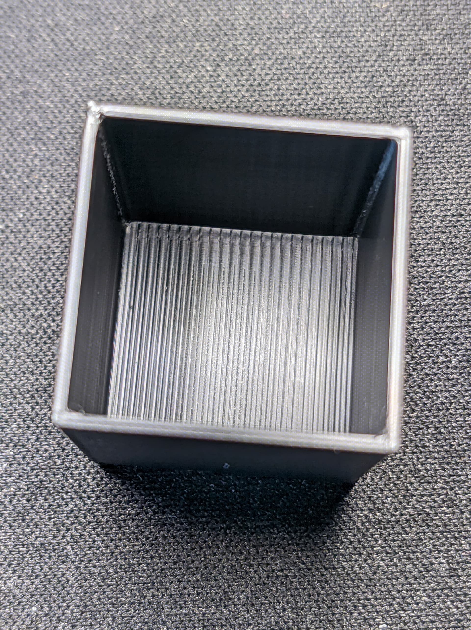

I am happy with the overall looks apart from the first layer and the edges as they have curled up.
Adhesion was crap, didn’t use any additives. Might be the cause.
The top layer of the inside looks nice, as well as the walls.
Accuracy is meh again. Though more precise than previously but still one side is off.
Measurement is basically
0.80 x 0.76 x 0.80 x 0.76
Goal is 0.80 all-around.
E: Forgot to adjust flow and my e-steps again since i’ve installed the Silent board. Doing it now.

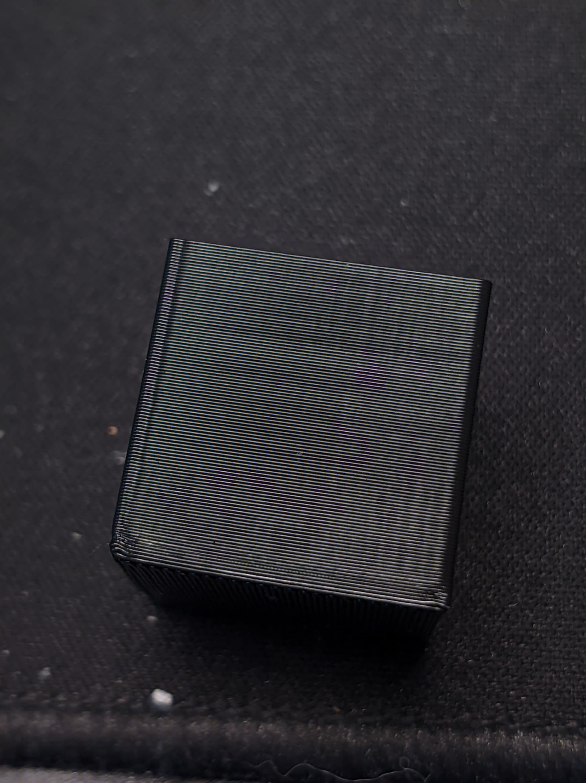

Print 2 with adjusted esteps.
And current cura profile.
Previous print was… I don’t know what profile or settings it used.
The one with my profile doesn’t looks as clean and has stringing.
First layer looks better but is lacking filament.
The adjusted one is accurate in a different way.
The thickness is worse?
0.85 x 0.85 x 0.85 x 0.74
BUT the outer dimensions are almost spot on. 20.05mm on all sides where as the first one was 19.80ish.

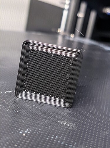

My biggest issue so far is my first layer, the lines are way too thin, but the second layer is thick as it should be.
First layer:
Second layer
It will definitely help but your bed likely also needs to be a tiny bit closer. I’d do a quarter turn of each knob. I actually run 0.6mm line width on my 0.4mm nozzle because speed.

my first layer is like this
grafik
but the second and so on layers are like this
grafik
Also adhesion doodoo
A bit closer to the bed will help with adhesion too hopefully. I use a bit of hairspray every few prints on a glass bed.

Yup, you need to raise your bed/lower the nozzle for the first layer, it’s too far away.
