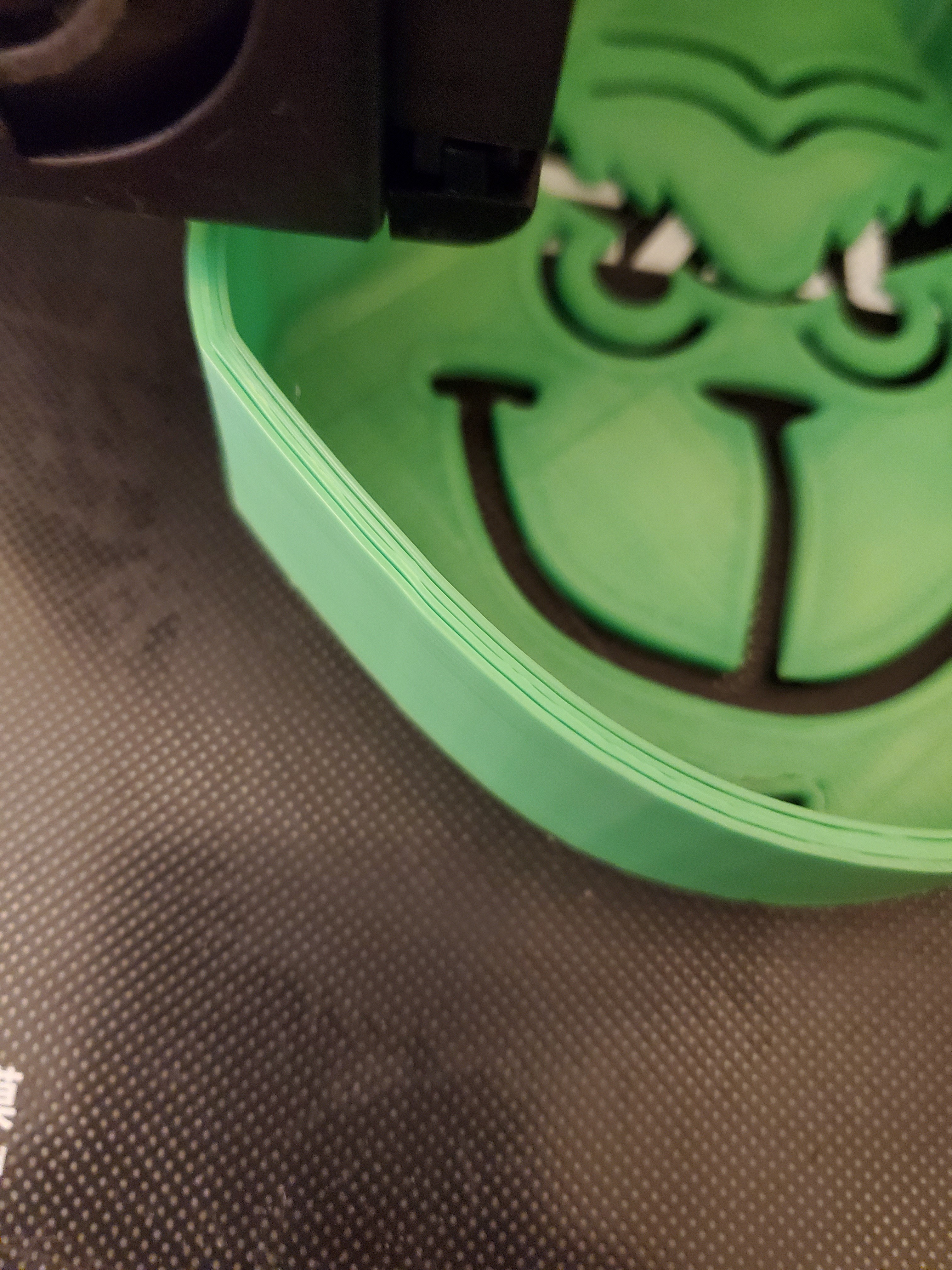

Yah easiest to see from the side shots or straight down on the last image in the middle of the black box it was too big for my print bed and printed out of TPU so was slow going so I did it in two parts then glued it together but would maybe like to throw a sticker or something else over that to just cover it up, not terrible looking but just trying to keep things cleaner on this build than my last.
take a look here. This is how I cover the seams.
Nice hadn’t seen this thread I’ll take a look through it, another 3D printed little stripe part might work nice similar to how some are done here thanks!

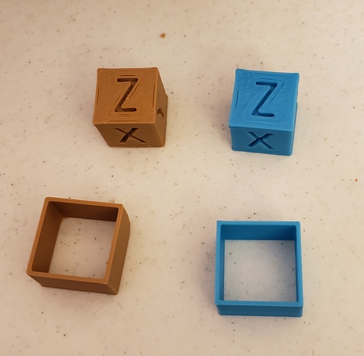

I did the estep calibration and corrected both my machines. They were both set to 93 esteps/mm default. Now, one is around 140 and the other 125.
I then printed a 2 wall hollow cube and it measured very close to correct.
Feeling confident, I printed my xyz calibration cube :muscle:
The wall lines specifically are not touching each other on the top faces. You can see it more here.
The 4 wall lines don’t mesh together. My line width is set to 1.3x nozzle size.
Bumping flow rate up while printing helps this issue but my hollow cube test measurements claim flow is, of anything, a smidge too high.
I changed nozzle diameter when this issue started happening. Are there any other settings in cura I might have needed to change when moving from 0.4mm to 0.6mm nozzle? Other than the obvious nozzle diameter value when setting up a printer.
What’s the number of walls and infill.
What about the setting “print walls smaller than nozzle diameter”
And also “print small gaps”
Wall line count is 2
Infill is 25%
Print thin walls is off
-Fill gaps between walls is set to everywhere
Filter out tiny gaps is off
I made a profile before I posted earlier that has filter out tiny gaps changed to on but haven’t gotten to test it yet.
1.3xnizzle gives you 0.78. please make it 0.8. I think I read somewhere that might cause issues based on how they perform the calculation and the steps of the stepper.
Print thin walls should be on, especially with large nozzles.
Other than that I don’t see why the walls shouldn’t fuse given that they should based on your flow rate calibration.
Print thin walls being on seemed to help out a bunch. I didn’t bump nozzle width yet, changing one factor at a time for sanity’s sake.
A bit funny that “print thin walls” being on fixed my issue of walls being too thin :joy:
Thank you for the support!
