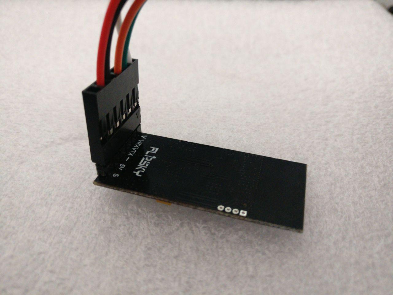

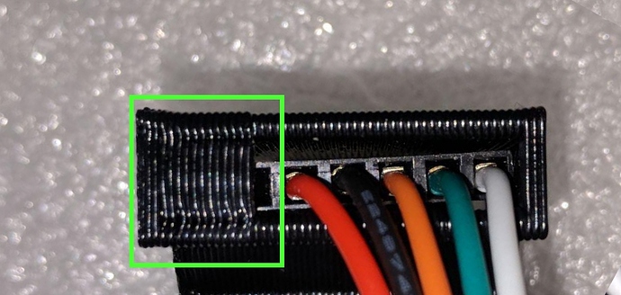

I quickly designed a Case for the Flipsky VX1 Remote Reciever because it does feel fairly fragile with its 90 degree angle. Its technically a WIP because i need to implement a way to better route the UART cable (you can still push it through but it will crack, but thats really not that bad) Maybe dremel a slot in the back so the wires can fit in.
I did a test print with 0.4mm and its enough in my opinion.
The Bottom is open but comes with a lid, which has to be either taped on or like i did, glued.
The Cover also has a Anti-Disconnect roof for the cables, so if something happens and the connector loosens, it can’t disconnect due to the roof.
