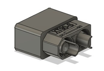

Hereā€™s the STL for my double sided loop key:
double_sided_loop_key.stl (79.6 KB)
double_sided_loop_key.3mf (60.0 KB)
The loop key needs to be soldered very compact.
What if mud goes in the holes while riding, and when you flip it around to turn it off, you get mud on the metal bullet connectors?
Hm, good point. I havenā€™t thought of that. I may need to make a cover.

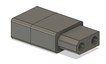

This should do:
Why do you need a cap, if the loopkey is only pulled while itā€™s not being ridden, and, hence, not getting dirty?
The cap fits both sides.
But why not just the key? What purpose do the printed bits serve?
The only time it seems filth might enter the keyhole is while riding, and the key is always in the hole while riding. In the closet when the key is out it wouldnā€™t seem to get that dirty to need a cap.
The idea is that after pulling the loop-key out, you flip it over and you plug the plastic side into the loop-key slot, so that you donā€™t lose it.
Then while riding the plastic side is exposed to dirt so it needs a cap. When the board is off and stored the cap can go on the ā€œliveā€ side of the loop-key so that you donā€™t lose the cap.
So basically the workflow is:
  • to turn it on:
    • unplug the loop key
    • remove the cap
    • flip the loop key over
    • put the cap back on
    • re-insert the loop key
  • to turn it off:
    • ditto
This is what I was missing. I guess I never had that problem. :metal:
