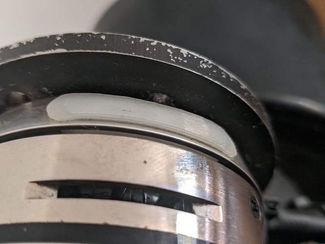

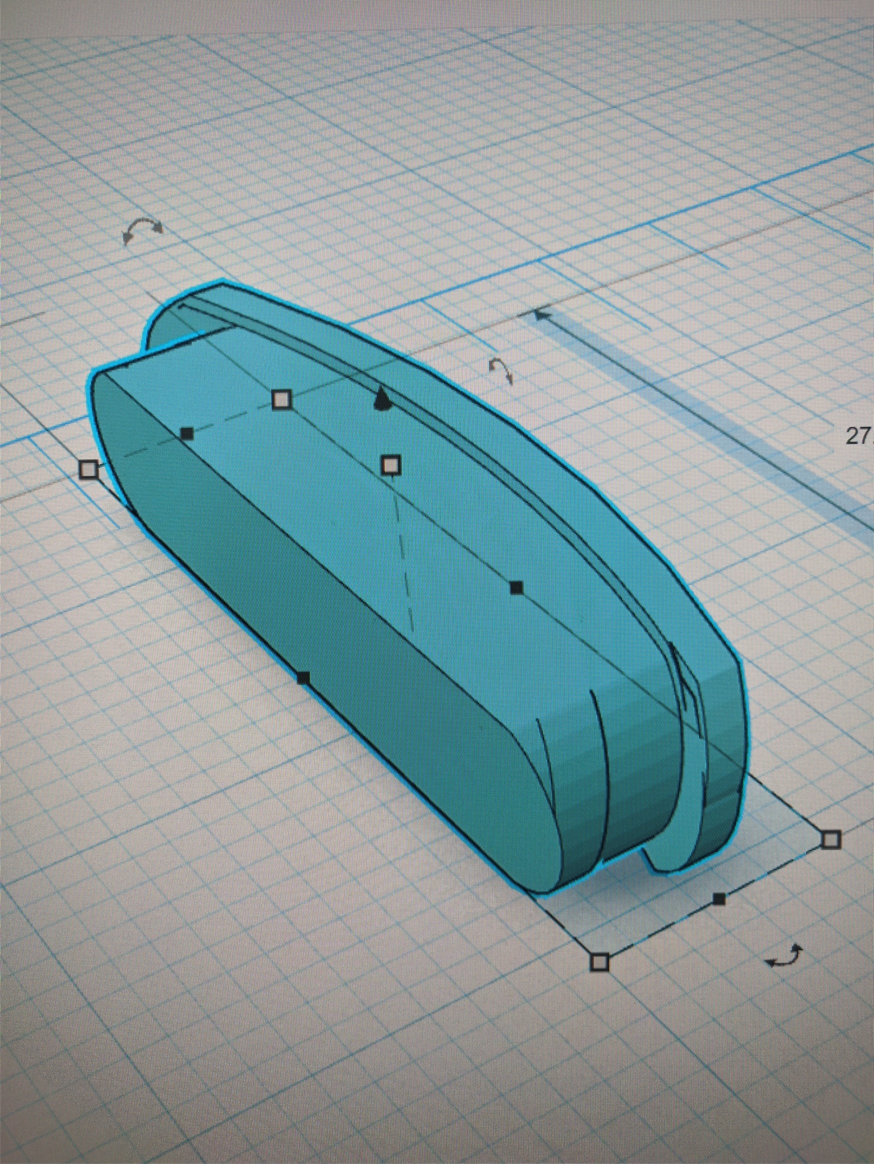

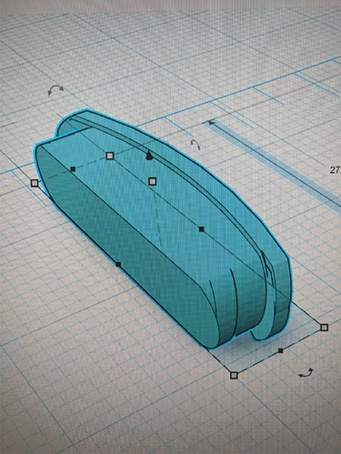

I created a plug for the rather big holes in the sk3 motor. Suuper tight fit at the from me printed size (116%) 114 or 115 would be fine too, i wanted to make sure nothing gets in.
Printed with TPU 0.2MM and a 4 line brim.
(Yes i know, there are other ways for dirt to get it but its a start.)
FILE at the End.
(it is a 116% scale from the original file because the model of the motor i got was wrong. For you it will be 100% and print ready. The file is really tight and you need a tool to press the sides in, optionally print it at 99 or 98% on the Y axis (length)
116 scale sk3.stl (97.0 KB)
Nice, very creative! I used tape to do this on my SK3 but it would always ripped after a while.

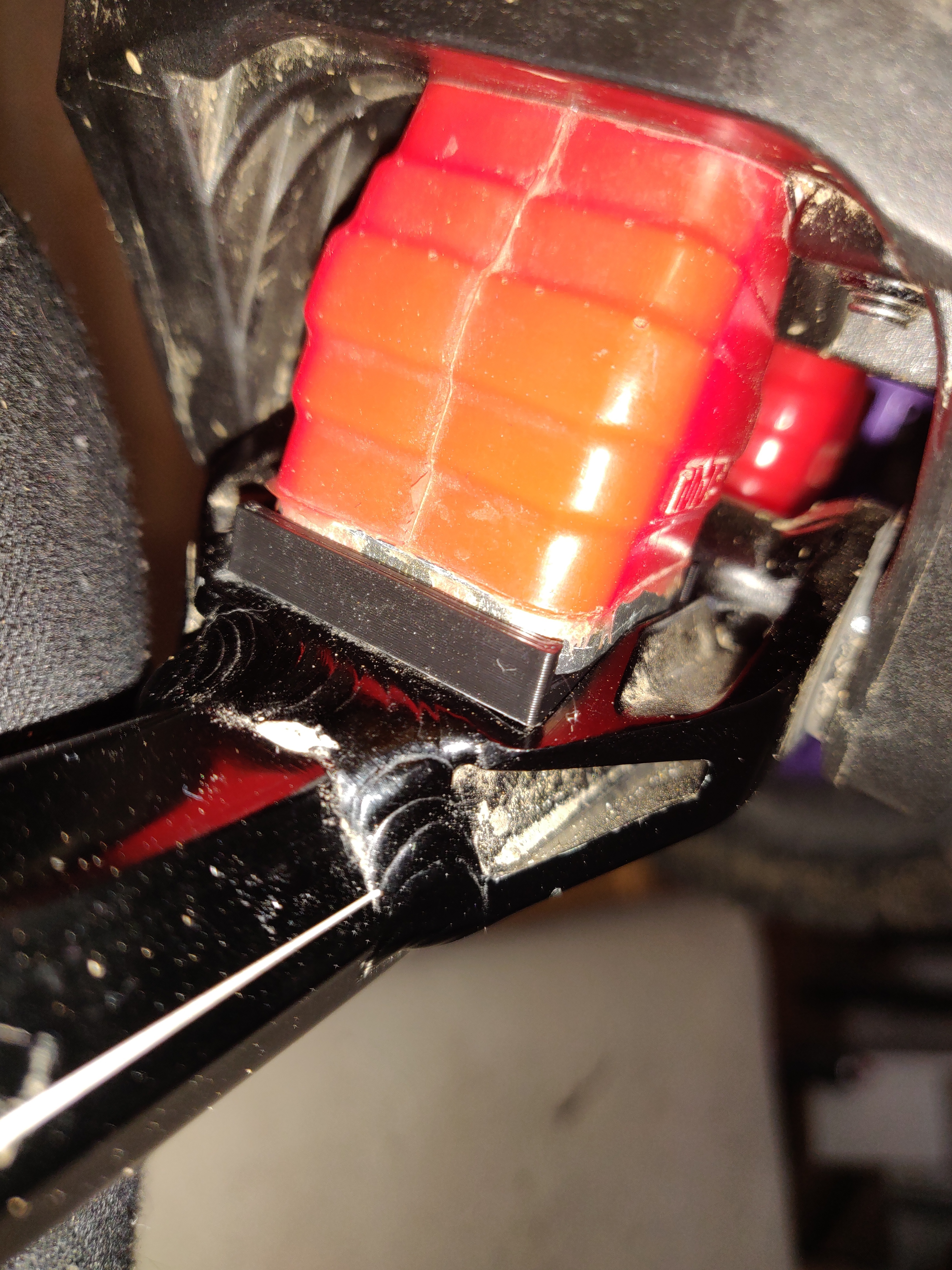

I printed myself a mbs matrix 2 Shockblock riser. Makes even the Red shockblock stiffer due to the increased height.
For Orange i used 3.5mm extra height and for red 2.5mm.
So 2.5mm left and 3.5mm right (have to use 2 colors of shockblocks)
Just installed them but need testing.
@Venom121212 @Creavenger
Awesome idea! Would be very easy to tweak the shock blocks exactly to ones personal liking
Looks good but isn’t that what the set screw in the bottom of the truck for?
When I turn those, it raises the whole metal plate on the shock block.
yes but i don’t know how well the threads handle my whole weight pressing on the setscrew alone. I
Also this way the overall feel is more stable than before because it isn’t as soft as before

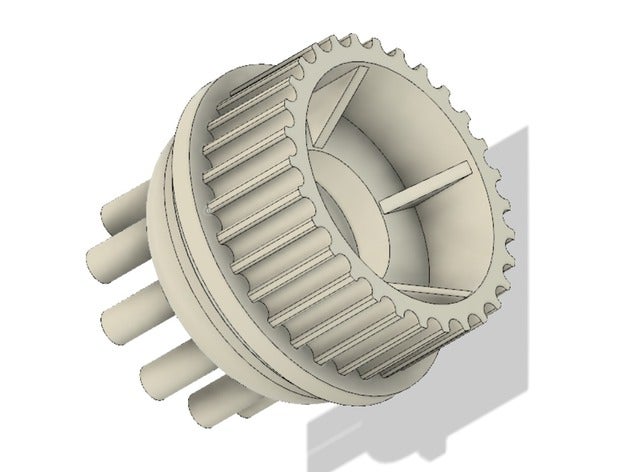

Anyone have a 30t Kegel pulley? Smallest I found was 32t.
It’s kinda tough to get smaller than 32t with the kegel hole pattern. The walls get a little too thin and weak.
I found one last night but it’s press fit, I’d prefer bolts for my printed parts.
This is what I currently have printed, I like the lock nut design. And it was easy to print with no supports https://www.thingiverse.com/thing:1733883

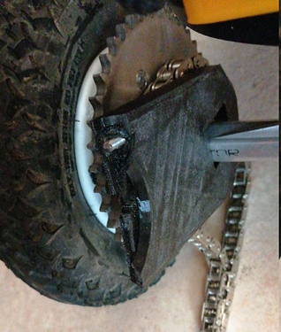

Does anybody have a belt cover for the electricskatesolutions evolve 63mm motor mount?

I’ve actually combined the two to create the 30t locknut pulley. I haven’t tested it yet though, board is half way built.
