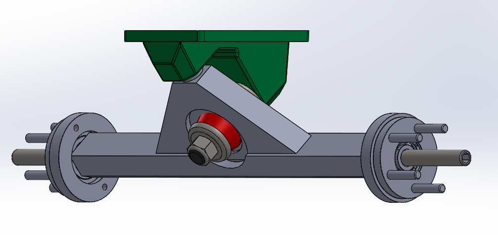

So @mishrasubhransu designed and printed some sweet looking berg hubs with kegel fittings - perfect for the BN geardrives using the kegel fitting. Means you can swap between TB110s and Bergs without needing to change the fitting (since they’re both kegel). @mishrasubhransu ‘s design could also be used for a similar setup using belts IF there’s 60T kegel pulley…was just wondering whether modelling a 60T BN-style press fit kegel pulley is viable…(I’m going straight to derail jail for this one lol)
this is a cad request thread. Ok yeah so you want a 60T HTD 5M pulley for the BN push fit adapter.
I already have a model of the BN Kegel pulley push fit adapter so anyone can make a pulley and print one.

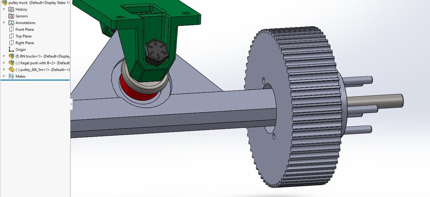

Exactly what I’m after, but someone would have to modify the design for 60T, no? (I don’t have the skills). Also, was wondering if there is any potential structural issues with 2 3D printed parts working together…especially since the kegel prongs when 3D printed may be a weak/brittle?
just have to design a pulley, that bolts into the adapter. Due to the small diameter of the bolt pattern the stress will be high hence why I thought a carbon fiber plate could spread the load out the a printed pulley exposed onto it.

it really needs a metal hub or something I think
Ahh a metal hubs! I was going to use the printed hubs, is that a bad idea? Maybe my idea isn’t possible then
the stress there is really high, if a pulley cracks the wheels will lock up…
another option is to print it all in 1 part, but the material has to be tough. the kegel pins are not that big.
ah right, well it’s unlikely I’ll get the hubs millled, although it’s an option for that nascent kegel hub project, I forget who’s behind it, maybe surfnacho and luke

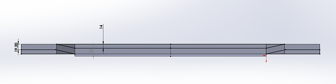

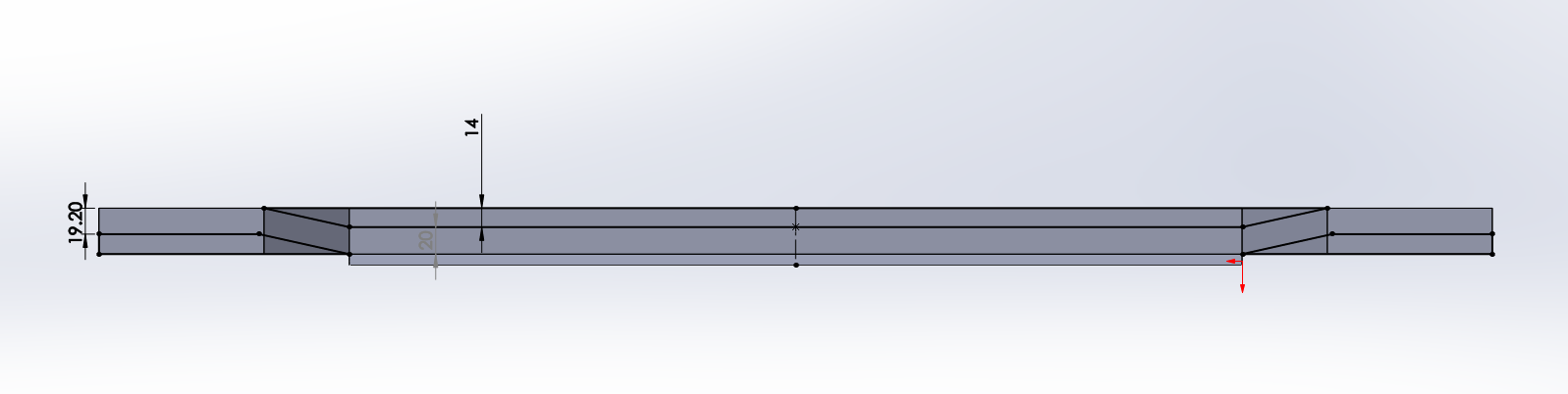

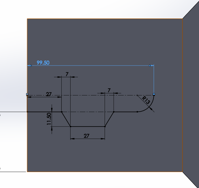

a 60t pulley with a belt is like 100mm diameter btw
:dizzy_face:
Too thicc for my liking. Thanks for mocking that up for me though dude :pray::+1:
just doing this by eye
ok bit more than by eye now
Ok still by eye some

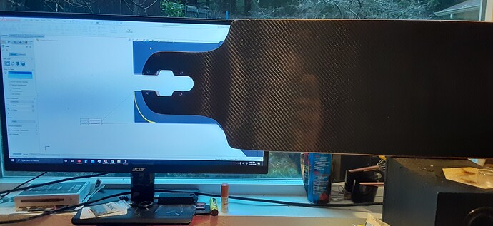

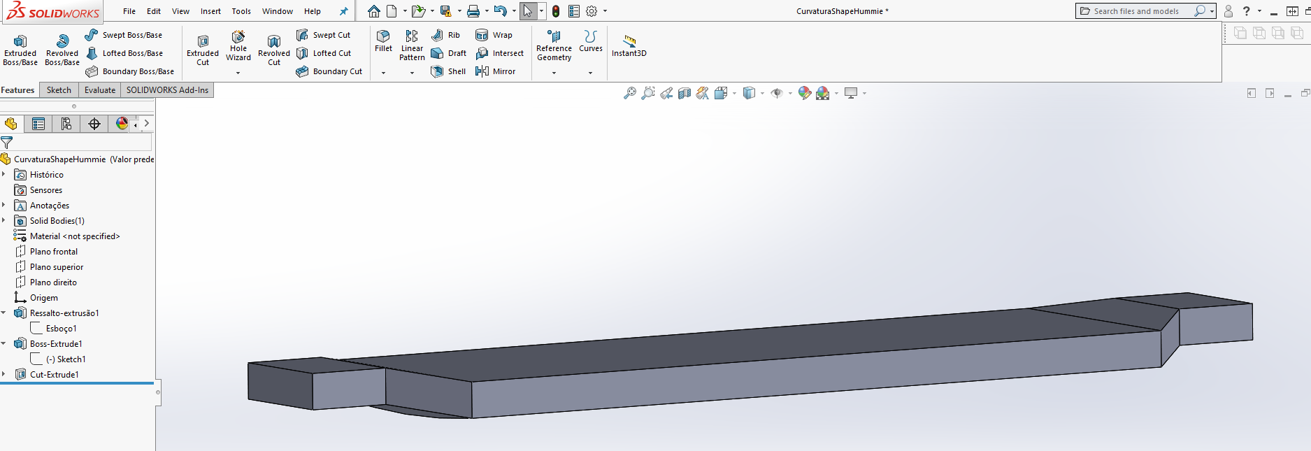

dimensionally accurate projections sounds really useful… AR vs VR lol
Looks good bro. Would be interested in this if it has bolt holes and dropout area. May get some custom backing plates cut and even just a top view of that area would be helpful for me. Churrr :call_me_hand:
