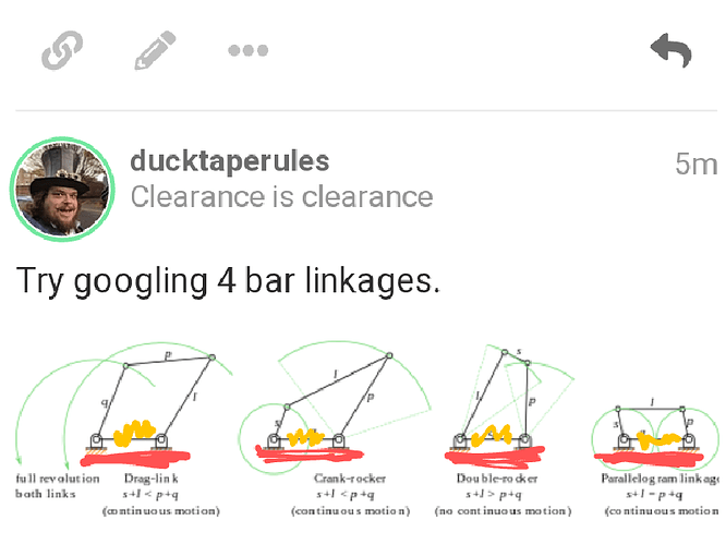

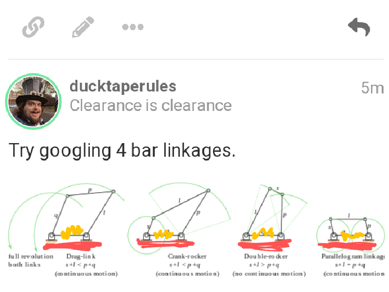

Try googling 4 bar linkages.
The ā€œframeā€ still counts as a kinematic link.
the key you’re missing is the ā€œgroundsā€ are connected by a baseplate or an axle
Count the links…
You had to edit an image taken from the 4 bar linkage Wikipedia page to prove your point, But sure, Your probably right. You win.
