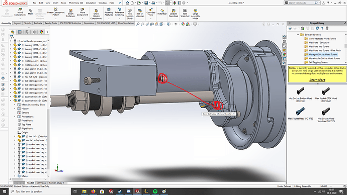

Hello @MoeStooge
Have been working on my designs a bit more, however since i have never ridden a 3 link truck i have no idea what angle is the best for stability or carving. I have some rough ideas, but i dont wanna “guess”
One thing I noticed is that you extend your liks nearly all the way till the wheels. Now because my gearboxes are there its hard to fit the liks that close near the wheels, now what happens when i mount the links a bit farther away, on the hole in the gearbox.
Do you have any advice on how to continue my design?
An answer is appreciated, but i understand if you feel like you dont wanna share your experience.
also dont mind the baseplate, thats a work in progress still.

The further out in the axel the pick-up point is the more control the link has over the axel. You can move them inboard but as you do you lose that leverage control. Angle wise the input deck plane would be considered zero in relation to the rod angle input. 45deg of arm and will make a real carvy setup. DIY :+1:
do you think i can make a stable ride with the rods inwards like this?
i wanted to make it adjustable a bit for more carve/ speed, i think i will make the holes so that i can decrease this angle to less than 45 degree then.
afbeelding
also does this angle matter a lot for steering?
if so, should it be a bigger or a smaller angle?
The most important thing is to realize the bolt hole centerline of the radius rod spherical is at a right angle to the radius rod. Rod ends must not bind in any way during axel articulation.
Rear @near zero front at 25deg keeps us pretty stable at 50+mph. 45/45 is really carvy. 45/20 is a good 35mph angle set
stiffer bushings would also help with stability right?
