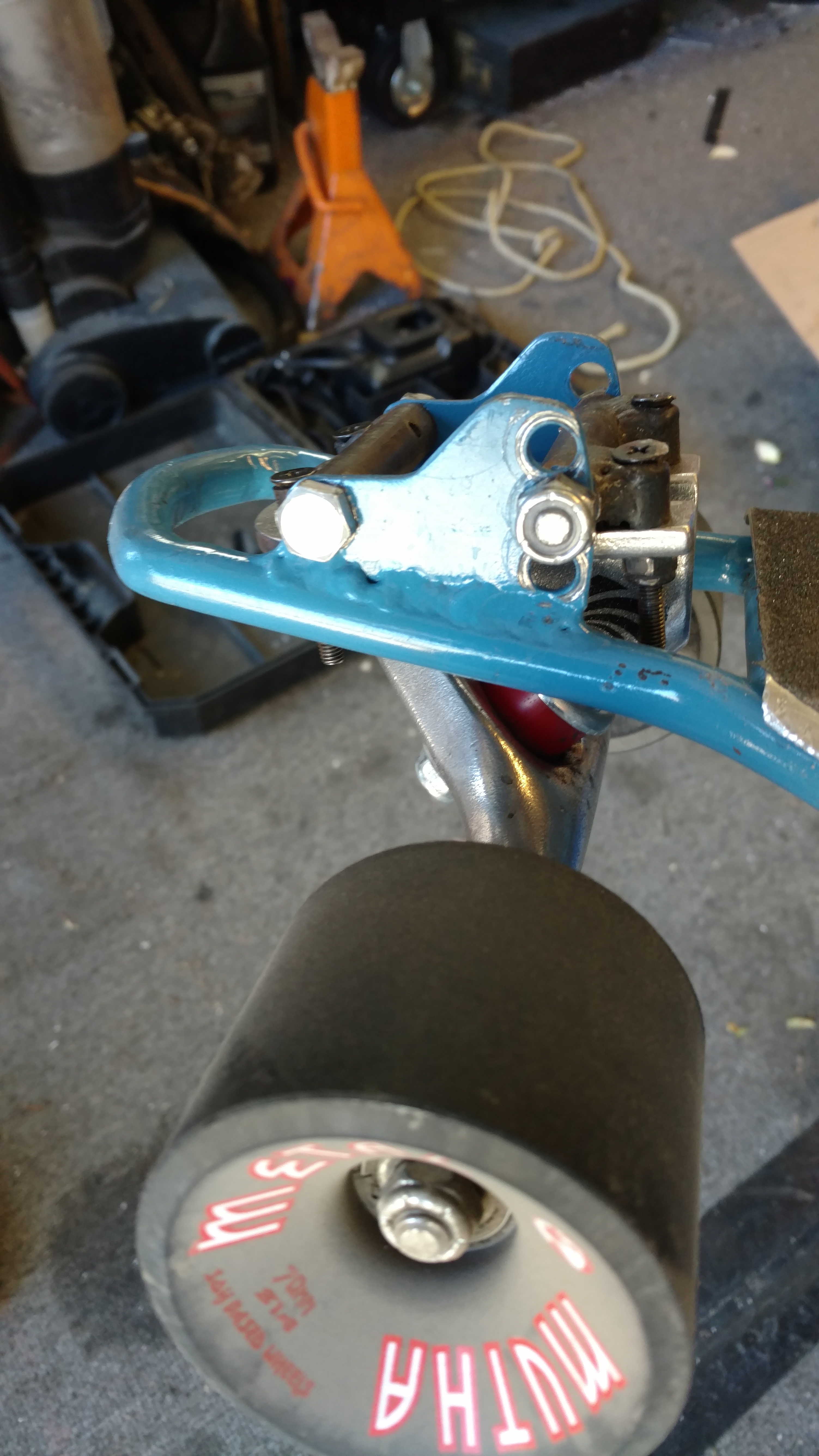

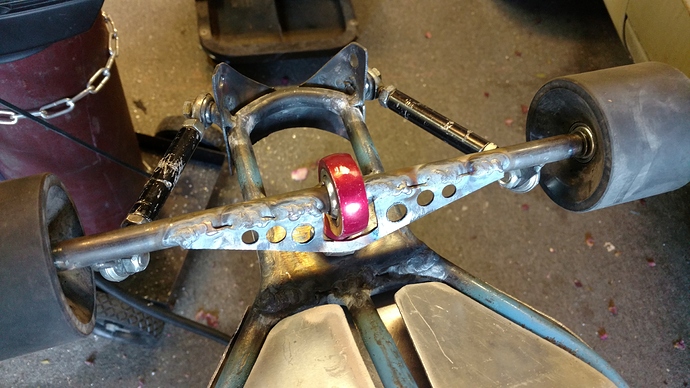

Glad I caught this. Nov-Dec 2016 was my first build. MAY 17’ is correct.
Front was ran without bushings.

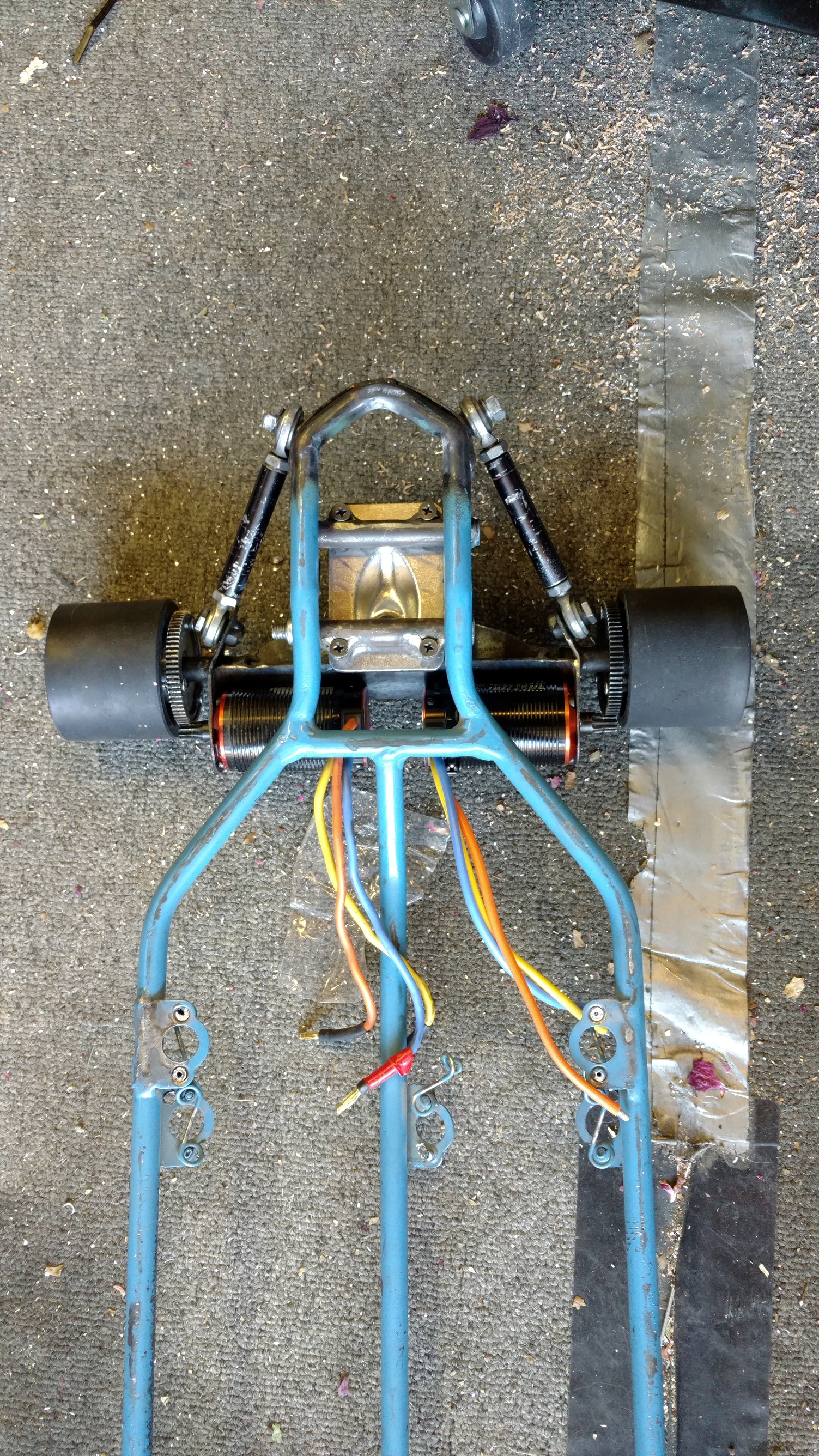

This was the V1 raceboard I went 45mph at SPD1 parts of this board are still in the V2 I currently ride. https://youtu.be/9WeG6JQzOMc
Ran Adj RKP junk before that.
54mph on the Dry lake bed with Rubber Bushings. The V2 was stretched to 42" wheel base and 11" wide deck. Dude holding the radar gun is dead. Wear your helmet.
RIPTIDE bushings worked with me to develop the current bushing setup. Custom fabricated urethane and Brad’s knowledge pulled it all together. That was 2018. Nkp was coined by Brad.
Brad has been a good friend to me opening the doors to the DH community and instigating good times. Tepe was the first run with Riptide Bushings on-board.

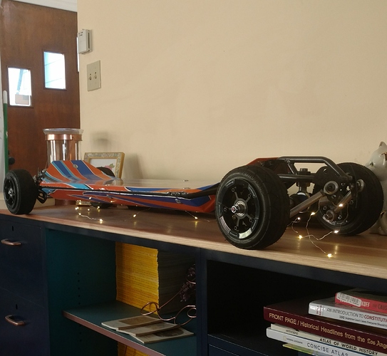

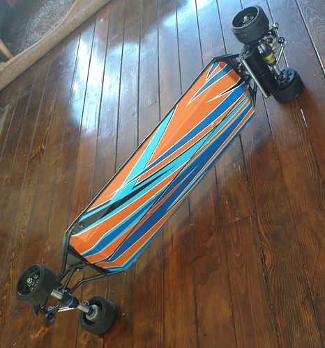

World record board NKP 3link Front Drive long rod. Single day of testing went well Max Capps made a few passes getting acclimated his last pass was on depleted batteries making 63mph.
Board has never been ridden since. Wheels are currently on Brad’s board.
V3 Front Drive Sept 2018. Luke stepped on this board first time day before World Cup. Made the finals after 5 rounds of eliminators. Track record.
Jason Lucier wins Barrett, wins BakO10 doing 52mph uphill. Then brakes the all time standup record at Mary-Hill going uphill on International Downhill Federation timing. That’s faster than any Pro Downhill racer EVER went at Mary-Hill.
V-4 Is the 2020 model RWD semi drop. I made one for a fellow racer and one for myself.
Testing was promising. It should race better then the V3.
NKP 3-link didn’t just happen. It is a well thought out and race proven design.

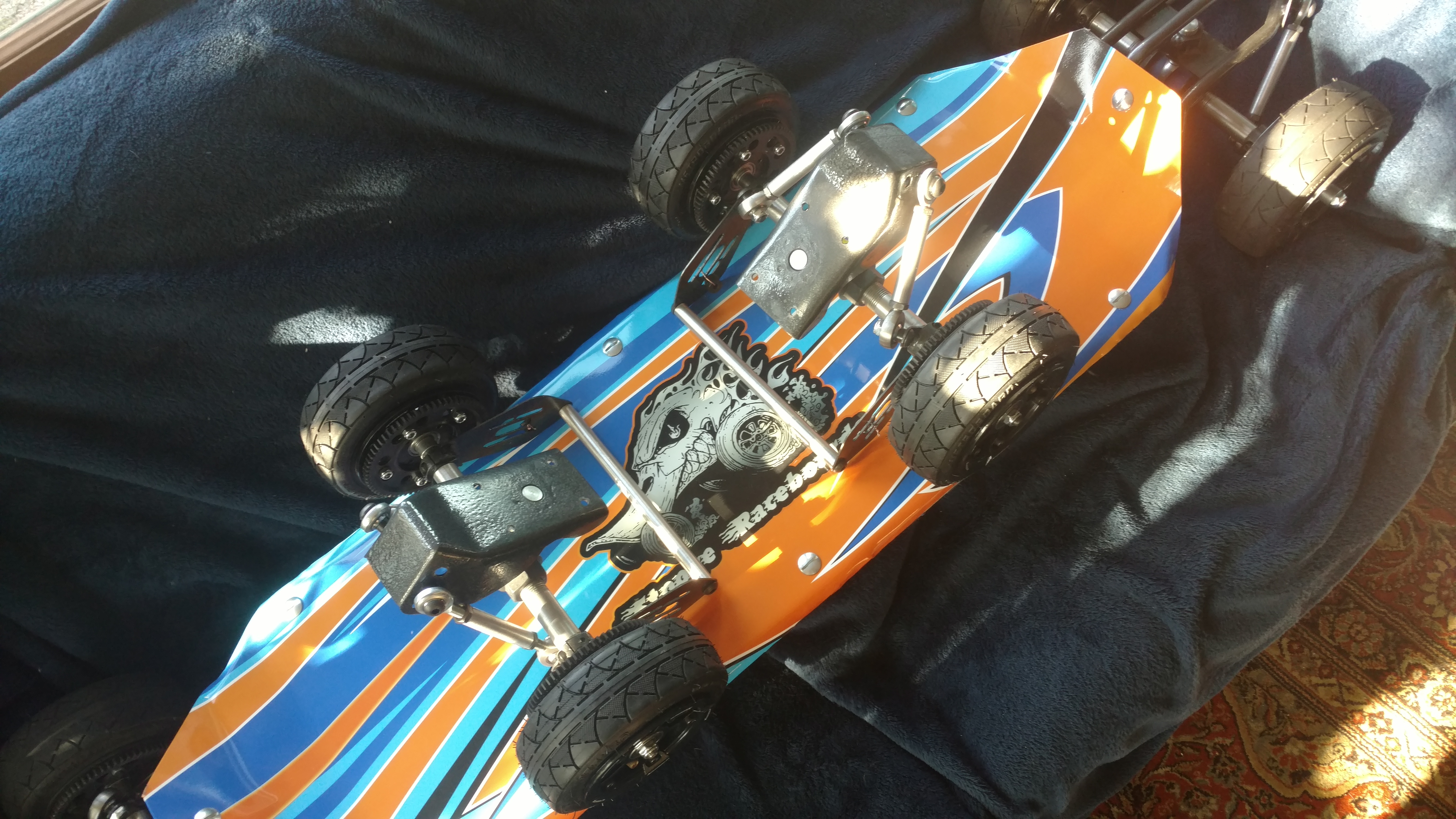

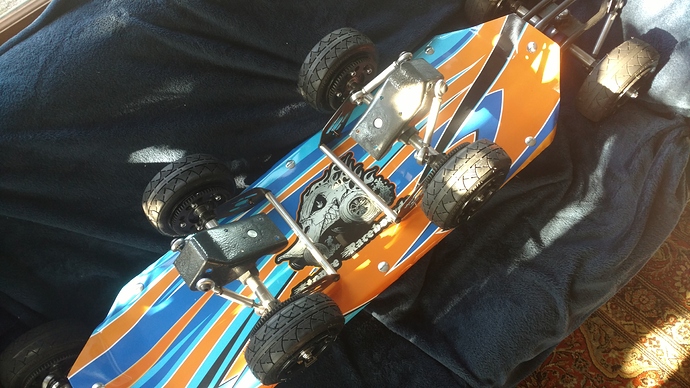

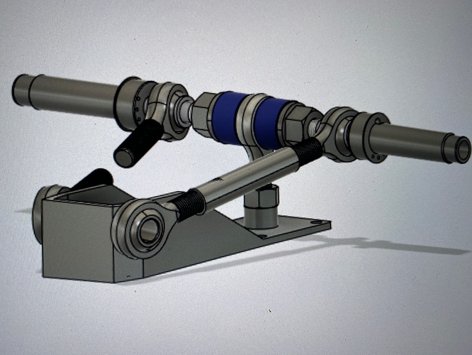

@evoheyax sent me this draft of his rendering
On April 6th. Clearly has no concept of function. If you cant see the problem you should probably not be making this either.
This one will work but end bad as well. Also Poor concept of Function.

These are prototypes. These are not a finalized product. The renders you see don’t have actual angles and rod lengths and heim angles.
I may very well redesign them 20 minutes after I build the first one. But it has a lot of adjustability. So I can figure out what I need to change and go from there. And 10 days later, test another design.

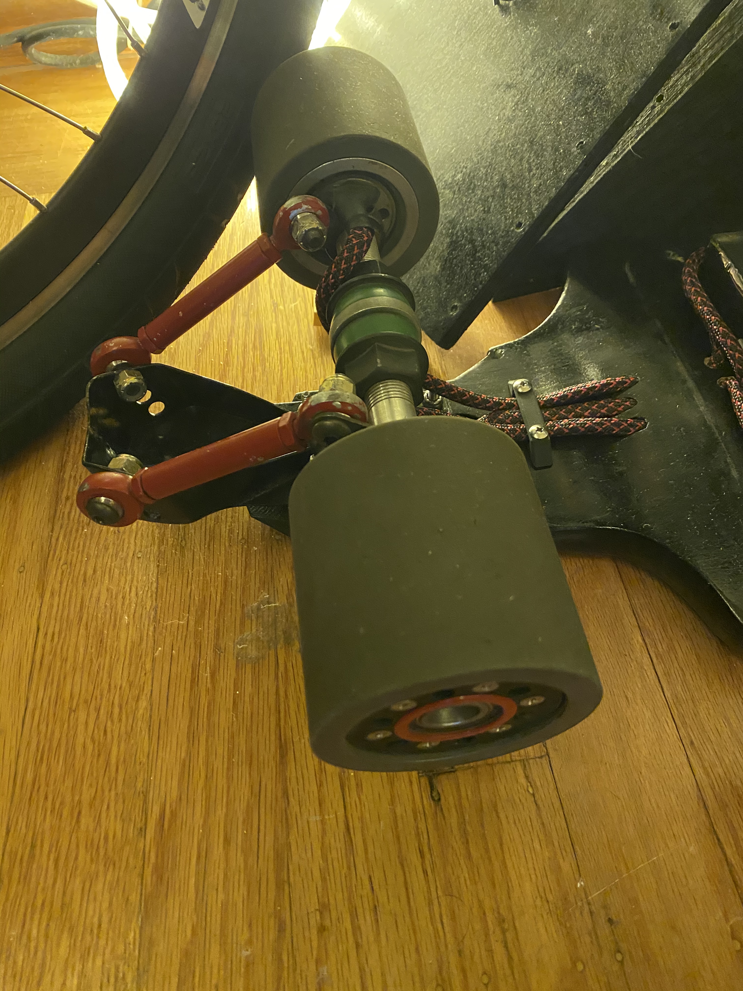

But I speculate the 3 link truck is probably a mismatch with urethane hub motors.
Its a metal on metal truck design without any dampening at all from bushings.
Hub motors don’t have the urethane thickness for the best ride comfort and quality under the best of circumstances.
Its not insurmountable or anything. But I feel there’d definitely be fewer people enjoying it with urethane hub motors vs other options.
It’s actually the opposite. Npk with hummie hubs was much better than with Rpk trucks hummie hubs imo.
Just watch the Kickstarter video and you’ll see some times where I hit bumps and potholes and stones in the road and I glided right over them.
