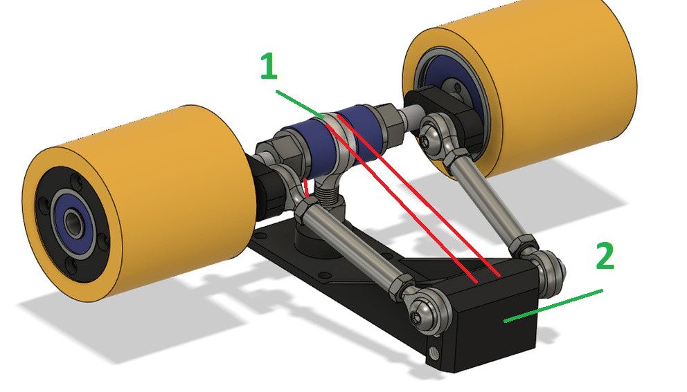

1/2" Solid 4130. Spindle area is 10mm
Is there a reason why pieces 1 and 2 need to be seperate? Seems like extra pieces and less structure for no reason.
I imagine machining piece 2 to incorporate piece 1 world be some extreme machining. And with piece 1 screwing in allows more adjustment. Then again be nicer as one piece possibly being stronger and less parts

The spherical carrier bearing (piece 1) allows for the roll pitch and Yaw moment center of the axel. A one piece baseplate (2) with a spherical bearing insert would work. By using a rod end as the carrier it allows for ride height adjustment.

I think it would be quite simple with a 4 axis cnc. Losing adjustability is a trade-off for sure though. Probably depends on the objective of the design.
You would also need a block of aluminium almost twice the size.
It would increase machining time and cost without offering something in return apart from loss of adjustability.
Also how would you incorporate the spherical bearing?

The point would be additional structural integrity, moving from steel to aluminum is not something that should be taken lightly, the fatigue life of aluminum is pretty bad.
The machining and material cost would be negligible at scale, you are talking $5 vs $8 per piece or something around there. Many spherical bearings also come in a cylindrical package that can be inserted into a hole. Anyway I can’t see the whole assembly so its hard to say for certain.
Aluminium doesn’t have a fatigue limit as you correctly stated.
That said, if designed properly it can withstand millions of cycles.
That swivel joint would have to be pressed inside the aluminium housing and stay there too after these millions of cycles.
Can it be done? Of course, IMO though it creates more problems than you are trying to solve.
What don’t you like about the current design in aluminium? Is it the threaded hole that holds the rod? There are many ways to reinforce it if need be.
Taking a second look it is probably ok. I think those linkages will remove most of the bending moments on that spherical joint caused by forward/backward force when hitting a crack or some such.
I also think this picture design looks a lot beefier than that screenshot of CAD.
