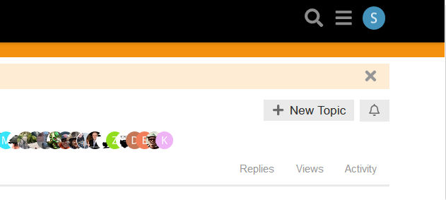

Just read through about 900 of these comments, so im more caught up now - @moon when do you think 4:1 Helical Drives will be available? Also, will the price remain around 320 Euro per set as mentioned somewhere above?
It should be at the top be at the top right of the page. If not, you don’t have permission for some reason.

I didn’t have it at first but now I do, Thanks!!
