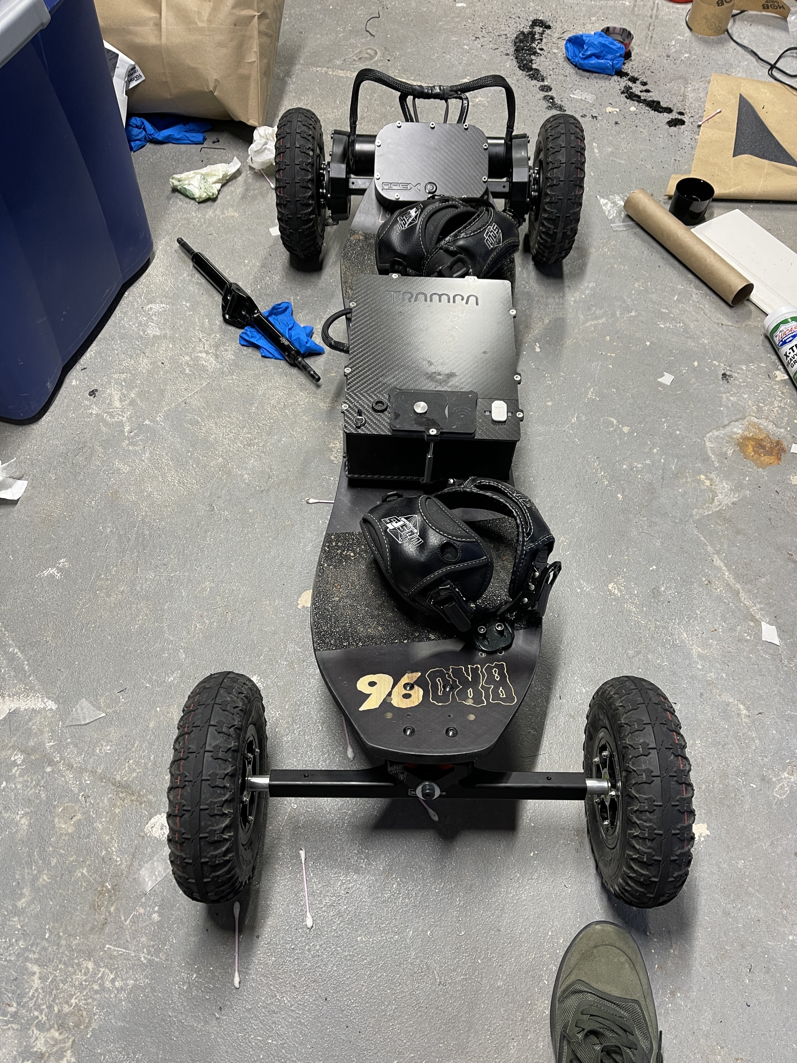

Moon gear drives DO FIT on 3DSERVISAS trucks! Ohh she’s thick now boy
Don’t mind the Qtips. It’s for cleaning board parts.
the older gen 22x22 ones ye
Hmm I didn’t know there’s a new gen. I only just received these a week ago.
oh huh I thought their hangers had moved to 20x20… nvm
They might have, maybe I just was sent the old stock. Idk. Anyways I don’t wanna derail this thread but I’m happy as fuck
