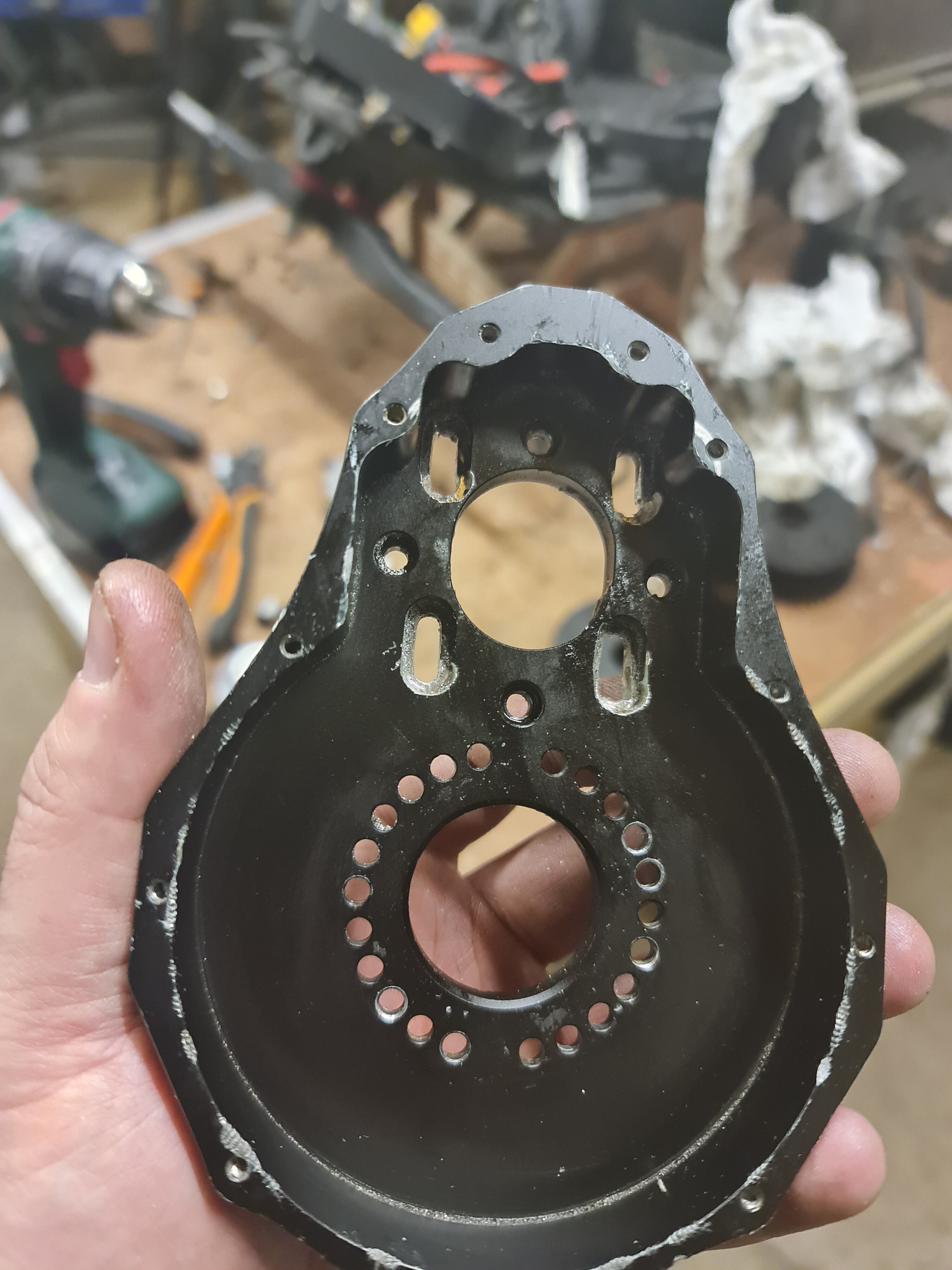

I have a very very early set of drives and so they were not designed with the 8T in mind. I couldn’t get the motor pinion close enough to the wheelspur.
Work holding was atrocious, result was meh but it works, you can see I just extended the motor bolt slots
As long as it works that’s good.
I sometimes wonder how to set up a job on a complex part like that and manage to accurately cut exactly where you want it to. Good job anyways.
The best way is to cut some of the features into the spoilboard. So, luckily I am friends with Moon and he shared the case CAD file with me so I could project the clamp holes and cut them into the spoilboard and then screw it down. It’s not easy and there are better ways but I was in a rush tbh!

The wall thickness seems passable actually, reduced key width
