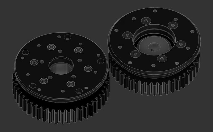

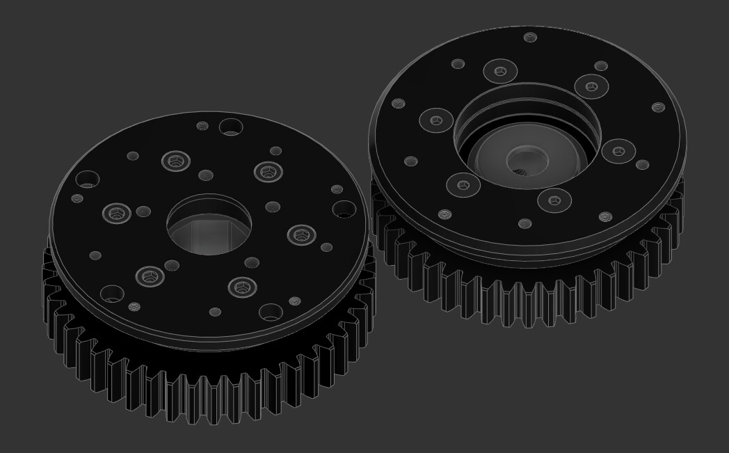

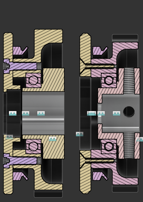

Wheel Adaptor
Now supports - ETOXX Offset Rims, MOON Rims (to be tested)
28mm bearing seat added back into design
M5 countersunk bolts replaced with m5 low profile cap head bolts
New wheel adaptor design

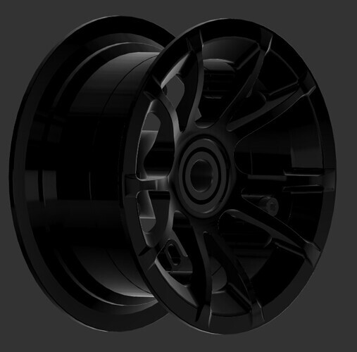

AT MOON RIMS
  • 6.5-9" compatible
  • Moon drive compatible
  • Dual mounting system
  • Press fits into the Moon drive

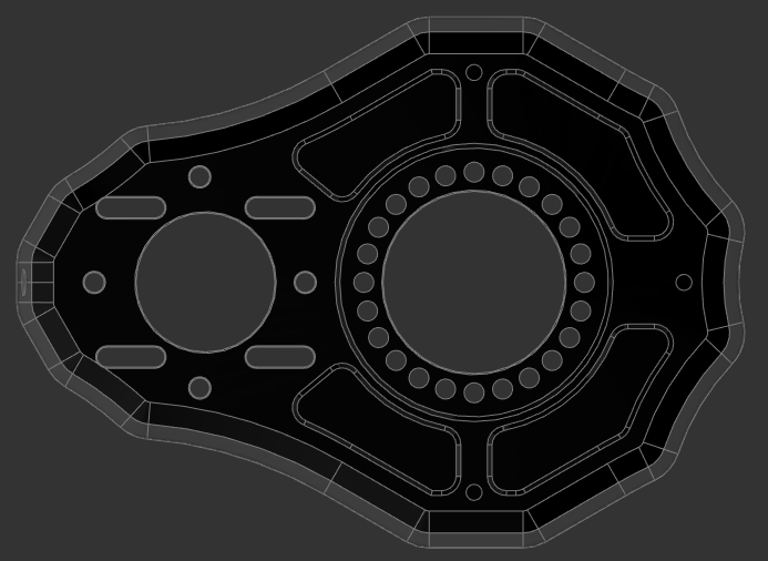

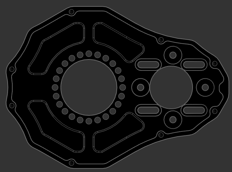

Gearcase and Lid
Slightly larger, 2.5mm less ground clearance
Mounting points to support future accessories
Max motor shaft length now 26mm, previously 24mm
Clamp bolts no longer blocked by motor on shorter gearing ratios

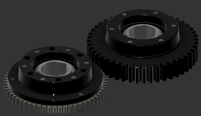

Steel gearing concept
Aim to produce a lightweight robust steel/steel gear pairing. Drop fits into all batches of moon drives.
OD 1.5 59T steel wheel gear (175 grams) on the left . MOD 2 47T POM gear on the right (90grams)

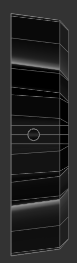

2mm thick motor mount shims (backwards compatible)

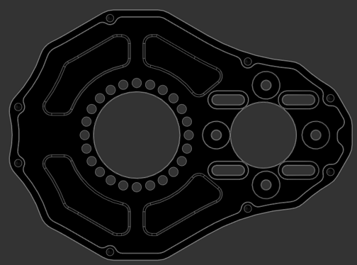

Motor adaptor - bolt pattern for 44/30mm pitch and SSS inrunner pattern (backwards compatible)
