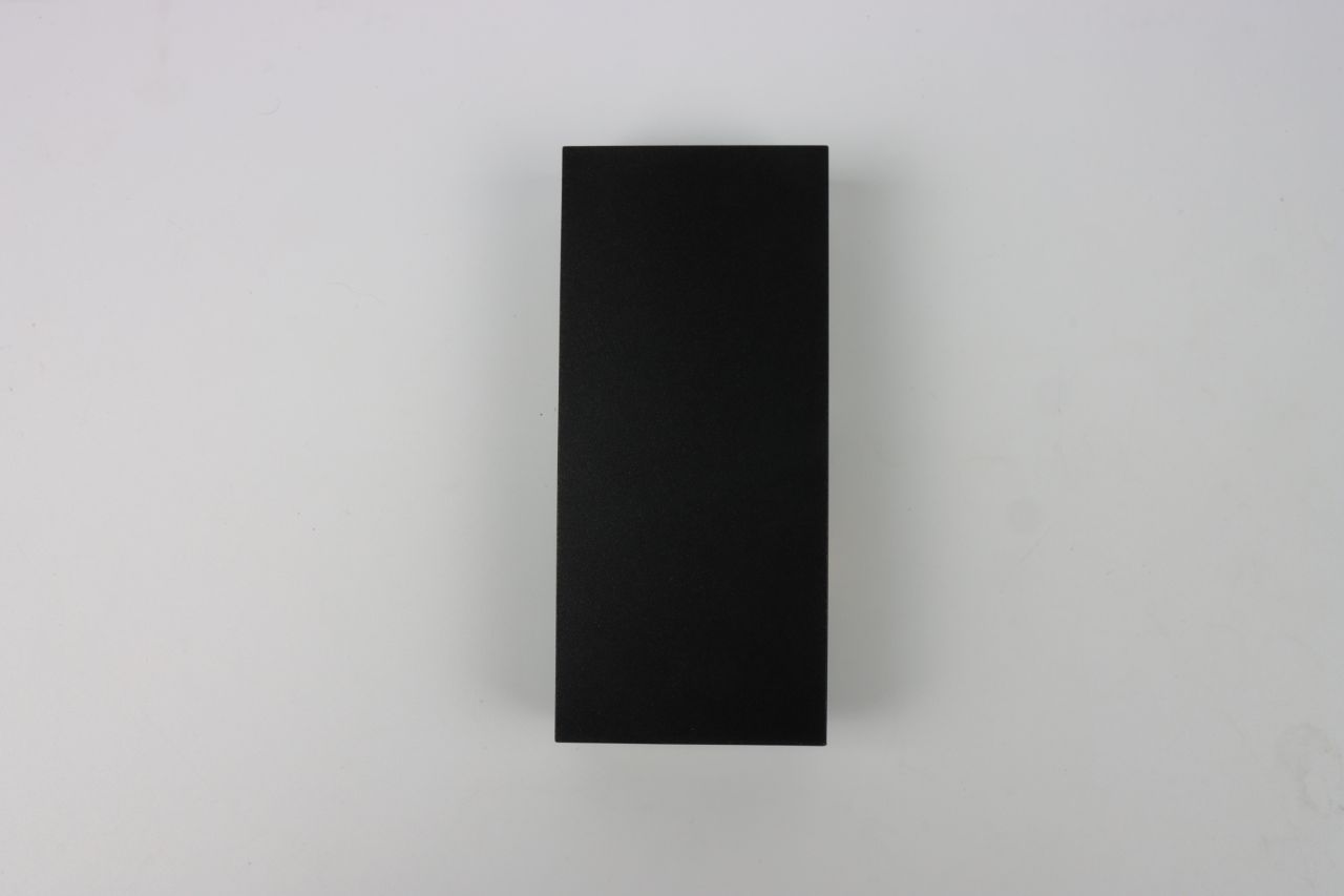

Is the back of the aluminum enclosure smooth ? Anything protruding? No pictures were shown of the back which I could find. Also, what is the recommended mounting method? I see no screw holes through the enclosure.
Hi there, good day~
Yeah, The back is as smooth as the following picture.
It does mount with screw. Here is the video, you may have a look.

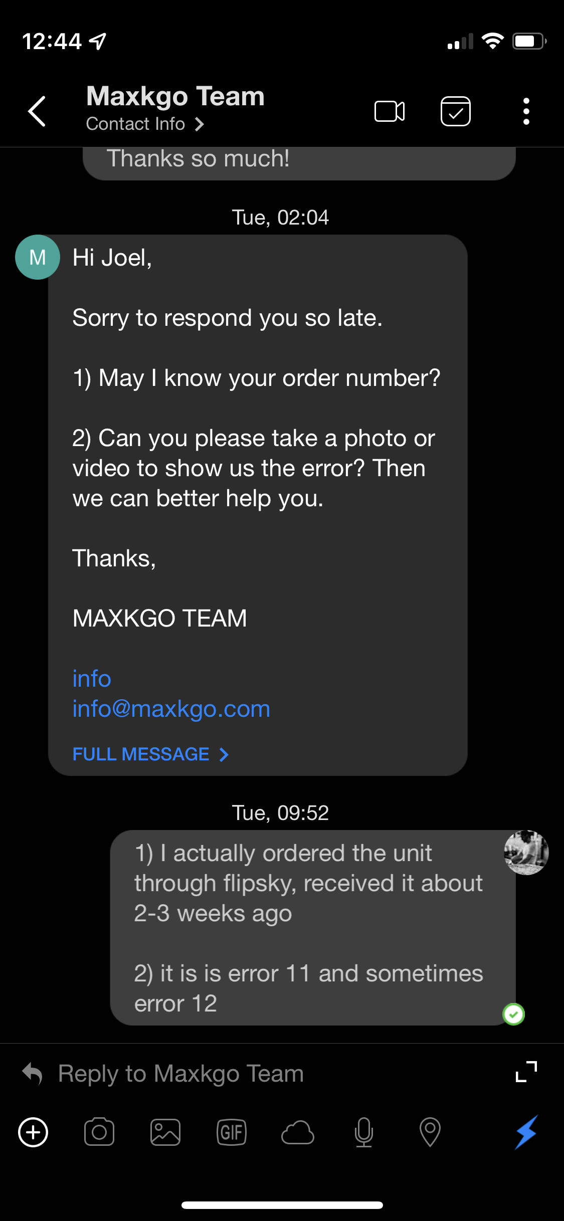

After alerting Cell hard/soft voltage with Code plug on board shipped from the manufacture 1.4, using DieBie downloaded from maxkgo web site. MAXKGO-SS BMS 12s no work anymore farking.
Great to see a pop up box message on DieBie (BMS interface OS) , upgrade FW before using. All well and great if FW .bins are included in the BMS tools. Or just the fact BMS tool communicate not seeing the BMSMINI12 ?
So I went ahead and altered Cell hard/soft after waiting for advise from maxgo a month ago and still waiting for a response. What happens next ERROR11, Bingo bango !
Like to know how you locate the correct code plug FW for the BMSMINI12 as I cant find the correct bin in MaxkGo-BMS-Firmware-master folder. Is it ENNOID SS ? as that was the first FW flash I tested followed by ENNOID 24s. ERROR code 12. Roll back to MaxkGo .bin Error code 11.
Why link github for firmware updates on maxkgo product and description page designed for DEVS and just make things simple with with firmware updates from maxkgo web site download section.

It’s like the MCU glitched after altering these settings below. Reverting to factory settings makes no difference and trying a combination of FW flashes with balancing wires connected and disconnected will not clear the fault.
FAULT_CODE_MAX_UVP_OVP_ERRORS = 11
FAULT_CODE_MAX_UVT_OVT_ERRORS = 12
