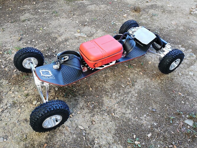

20SSS 2ST BRO : a 20S SSS inrunner 2Stage reduction build (2023 BOTY Candidate Update)
The battery box : [Turnigy Transmitter Bag / Carrying Case]

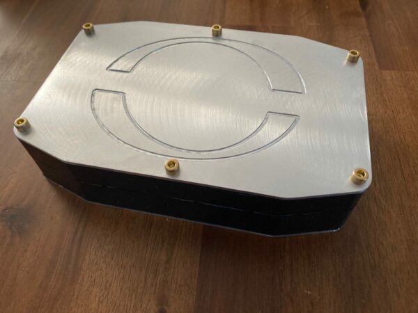

The ESC box : [OVERION Speedbox V23 & MakerX Go-FOC D100S]
The power cable harness :
Fuse upgrade :
The grip pads : [Treadmaster]
https://www.treadmaster.fr/collections/finition-losange/products/finition-losange-noire
The motors : [SSS 56123 360KV]
https://fr.aliexpress.com/item/1005005346910499.html
Drivetrain : [E-TOXX STEALTH420 with 1/15.625 2Stage gear drive and ]
https://www.e-toxx-shop.com/kontakt/
Wheels : [E-TOXX OFFSET HUBS V3]
Lipos : [20S / 4x Gens ace 5800mAh 60C 18.5V 5S1P Lipo Battery Pack with XT90 plug]
https://www.gensace.de/gens-ace-5800mah-60c-18-5v-5s1p-lipo-battery-pack-with-xt90-plug.html

I haven’t ride it yet! I wonder if I will get a better experience than with my 12S 80100 10/35 build which is my best e-mountainboard.
Its so… wide
Girth matters more than length Jesse… we know this.
That is the one Musk will use on Mars.
That has to be pure insanity. Amazing build dude.
First ride today!
Opinion about SSS 56123 inrunner high KV / high gear ratio :
Compared to my 12S 80100 130KV outrunner 10/35 build :
  • The SSS set-sup feels less powerful, less beasty and it delivers the power more smoothly.
  • The SSS set-up eats more power in the same time : 27.0 Wh/km compared to 22.7 Wh/km for the same kind of travel.
  • The temperature of the SSS inrunners was a higher than the temperature of the 80100 outrunners, that are bigger and heavier (80100 : 1960 gr / 56123 : 1330 gr).
  • A lot of ABS_OVER_CURRENT faults with the 56123 on the ESC that manage the interior wheel when turning 180° off-road : I think that because of wide hangers this wheel gets all the grip work and 280A as Absolute Maximum Current is not enough ; current is at this time from 285 to 305 A on the motor involved.
Opinion about MakerX D100S :
  • ZERO issue at 20S. I don’t have the low speed braking issue which has been reported by some folks.
  • Max current is weirdly low (43.5 A) but I was limited by the ABS_OVER_CURRENT faults off-road. I usually take 75-90 max battery amps with my 12S 80100 build.
  • The ESC keeps very cool : max 31°C (considering it’s about 11°C this afternoon).
Opinion about E-TOXX STEALTH420 double kingpin trucks :
These are the best trucks I have ever tried. I have rode Trampa VERTIGO trucks with springs or barrels, MBS Matrix 2 and Trampa IR trucks.
They have the best stability/turnability ratio ever. Turning radius is stupid short. I have to admit I may have forgotten to tighten something on the rear : :sweat_smile:
But I was yet able to go up to 50 km/h like that, without fear!
The only possible caveat is the width of them, and you have to take care about available room between two obstacles to make sure one wheel will not strike one of them.

2nd ride today :
Setting Absolute Maximum Current from 280 to 340A allow me to lower the ABS_OVER_CURRENT faults number from 11 to 1 (344.5A).
Always the same motor, in the same conditions (when turning tight on dirt).
What I don’t understand is where are the 344.5A or the filtered 152.6A on the picture!?
Setting the Throttle Curve to +10% and the thing has now more puch! :japanese_ogre:
Those E-TOXX truck are magical! It’s so easy to turn with them that I wonder if I will remain able to turn with other trucks!
