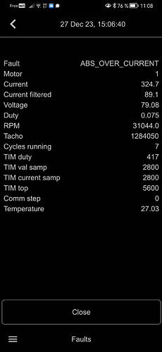

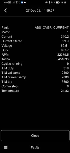

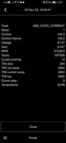

I’m a bit confused about how much I should increase Absolute Maximum Current to avoid these ABS_OVER_CURRENT faults.
This is the situation : (with another e-mtbd but no matter)
Low speed, high grip tyre, most of the weight of this wheel because of the large size of E-TOXX STEALTH420 hangers :
Setting Absolute Maximum Current from 280 to 340A allow me to lower the ABS_OVER_CURRENT faults number from 11 to 1 (344.5A).
Should I increase the Absolute Maximum Current again up to 350A? No risk for ESC considering nothing is wrong regarding connections and soldering job?
Should I set “Slow ABS Current Limit” to true?
Motor Current Max is set to 124A.
Battery Current Max is set to 100A.
YES. Trying this before increasing the limit itself, it makes a huge difference.
yes absolutely, also have a play around with turning traction control off or upping the rpm difference (thats if you have it on)
Recommend to use firmware 5.03.
6.02 is easy to have current fault.

Thanks to all of you!
Setting “Slow ABS Current Limit” to true (and in the same time lowering “Absolute Maximum Currrent” to 260A) made the issue disappear!

I’ve set “Slow ABS Current Limit” to False, because @Trampa (Frank) says it may lead to ESC destruction and saving my life doesn’t worth it. I prefer to save it a little bit so I’ve increased “Absolute Maximum Current” up to 355A.
I got only one ABS_OVER_CURRENT at 358A. It’s current spike because I can not even see such high current it in Metr log. As always : Motor #1 (never with Motor #2) ; while backside turning on rear right wheel ; never happens while frontside turning on rear left wheel but maybe it’s because of more balanced weight distribution this way. I’ll set the parameter to 380A and I think it will be OK like that.
I’ve searched a bit and read a discussion between B Vedder and Jens from E-TOXX. B Vedder admits he doesn’t have enough high power motors at his side.
https://vesc-project.com/node/97
He advises to set “High Current Sampling Mode” (Motor Settings / FOC / Advanced) to True. I have not heard of anybody testing that.
@Trampa advised somewhere to try to lower the Time constant T to 500uS and then press Calc Apply Old and write the new values.

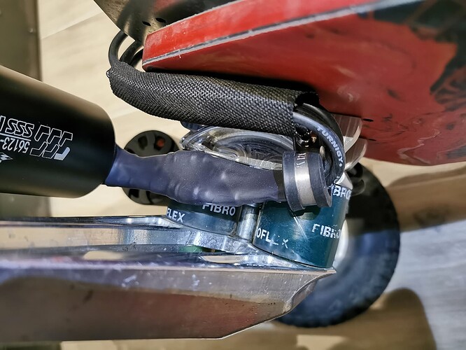

Last ride I had a phase wire that got unplugged after hitting a piece of wood, on the motor that had the ABS_OVER_CURRENT error. Maybe it was not plugged correctly before (vibrations or I don’t know) what caused this recurrent error.

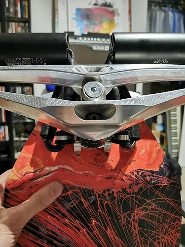

I have improved wire management :
I also had a small issue with gear drive sliding a bit on the hanger. A clamp system as used by Trampa with their gear drive is the only solution that worked with me to prevent this from happening.
