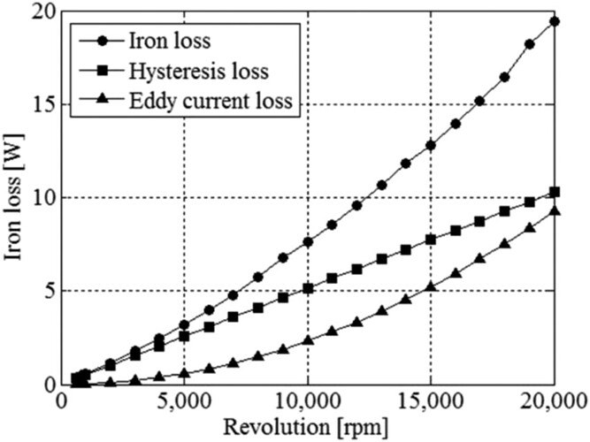

Its a lot more complicated when comparing between different motors.
But if we’re just talking about the same motor (regardless of what motor), then iron losses increase linearly with rpm or erpm. Erpm just being rpm * pole pairs which is a fixed value for any given motor.
I thought eddy currents increase exponentially with RPM and hysteresis is linear?
Yes you are right.
Copper loss also increases with the square of current, so making lots of power from a small package gets pretty difficult.
oh all this time i thought eddy current loss = hysterisis loss = iron loss.
and I thought they were all the energy lost reversing the magnetic field. which i now think is just the hysteris loss. that one i understand more than the eddie current loss. more stuff to look into.
I now think it’s eddy current loss + hysterisis loss = iron loss.
Yep and a lot of the losses come from higher harmonics which is why simulation and good design is very important to minimize these harmonic losses. The switching frequency and shape of the sine wave from the controller also contribute to harmonics and iron loss in the motor. Even the switching characteristics of the particular mosfets used in the controller has an effect on the losses in the motor. You can go pretty deep with this stuff!

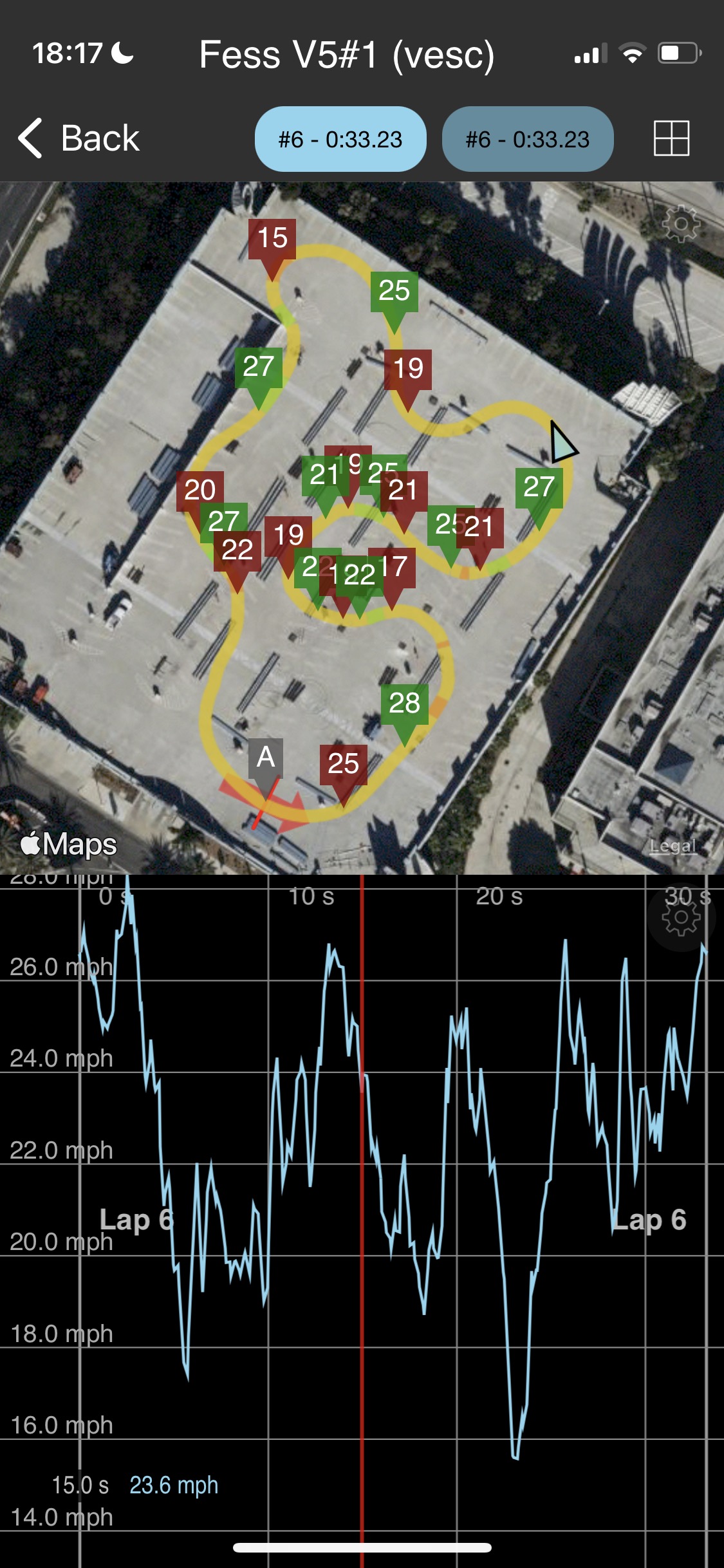

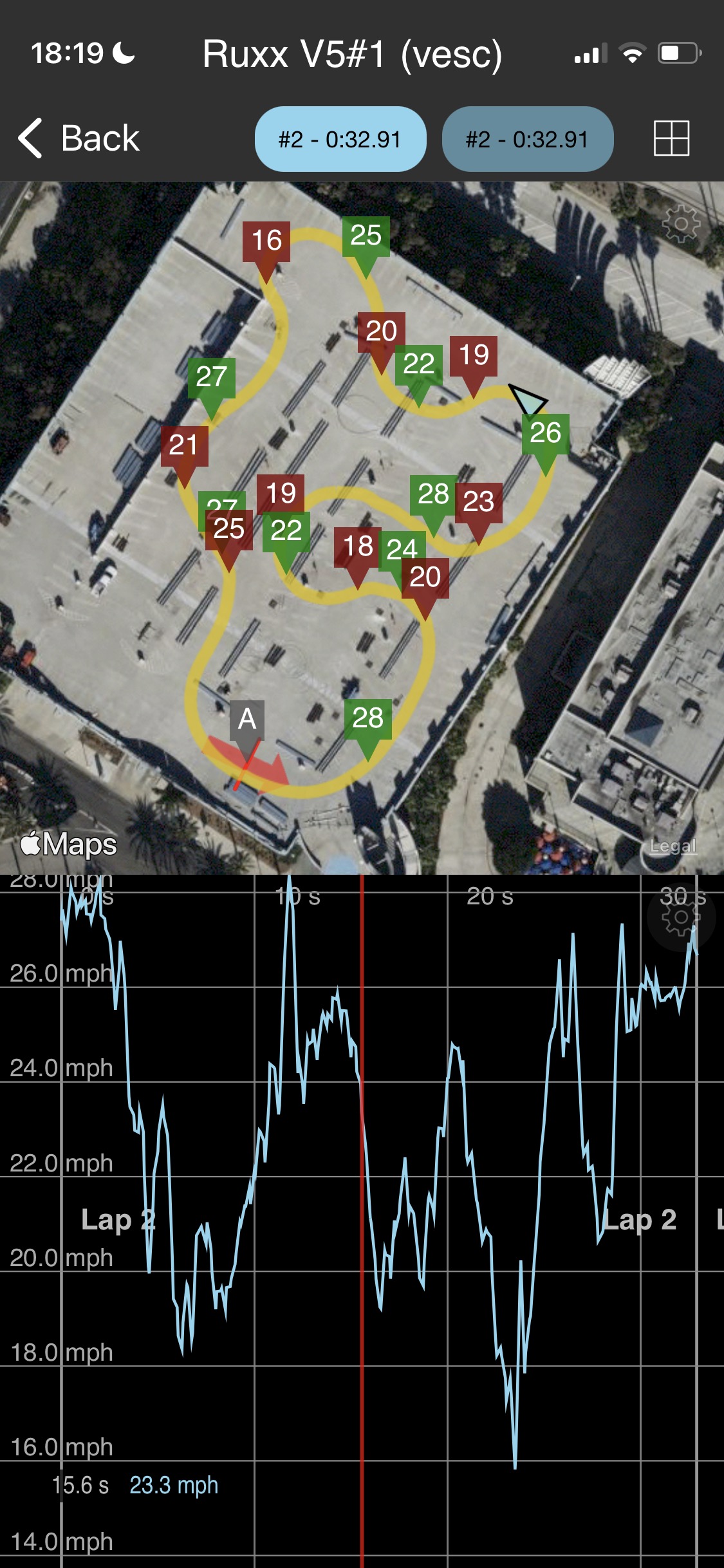

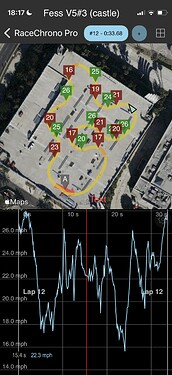

Wed 2023-10-11
another secret sesh.
course was too flowy I again didn’t get up to punching hard out of corners. maybe tomorrow at Intro2Speed.
214 max motor amps. 97 max battery. (/2 motors). but the board feels great at these paces.
runs were short so temps remained under control. < 70c
@Ruxx and @tuckjohn also rode the board. (didn’t get Tucker’s time, but we did get a time on his board)
v5#1 (vesc) fess AnkleWreacher @tuckjohn (vesc) v5#3 (castle) fess v5#1 (vesc) @ruxx
33.23 33.54 33.68 32.91

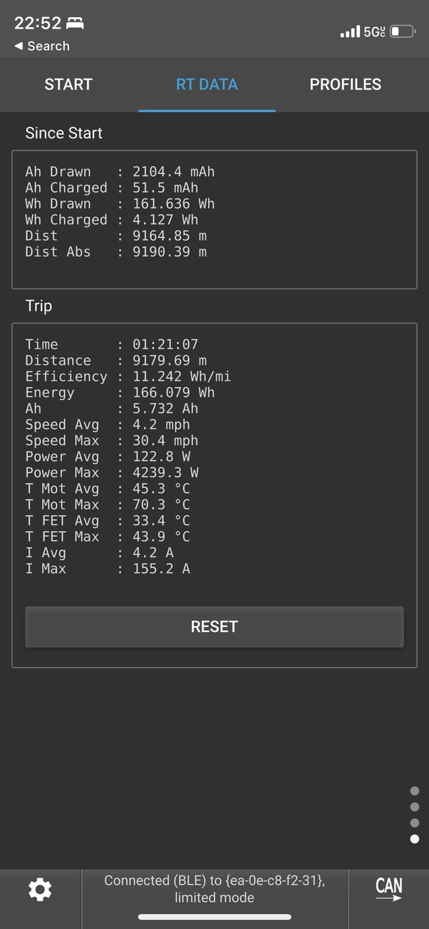

vesc tool telemetry
i haven’t used this much before. in favor of metr/robogotchi.
about 4kwatts a side max. so as i said another day of not pushign it hard enough. i feel i’m failing in this testing. but.. the board is fun. lots of fun.
I’m also confused why these two have different distance traveled and effeciencies. soemthing seems off there.
and on a broader note @HAIRYMANJACK posted to instagram story (since deleted) a 14kw power max screen shot. and we were discussing wether that’s dual or single. I thnik vesc_tool only shows per vesc numbers there so i was confused.
my trust that i understand what i’m getting from vesc_tool rt summary is low.

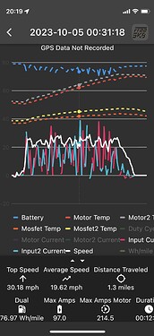

robogotchi telemetry
and the amps here (dual) on robogotchi, don’t match I Max in vesc tool real time at all. not sure what that diff is either.

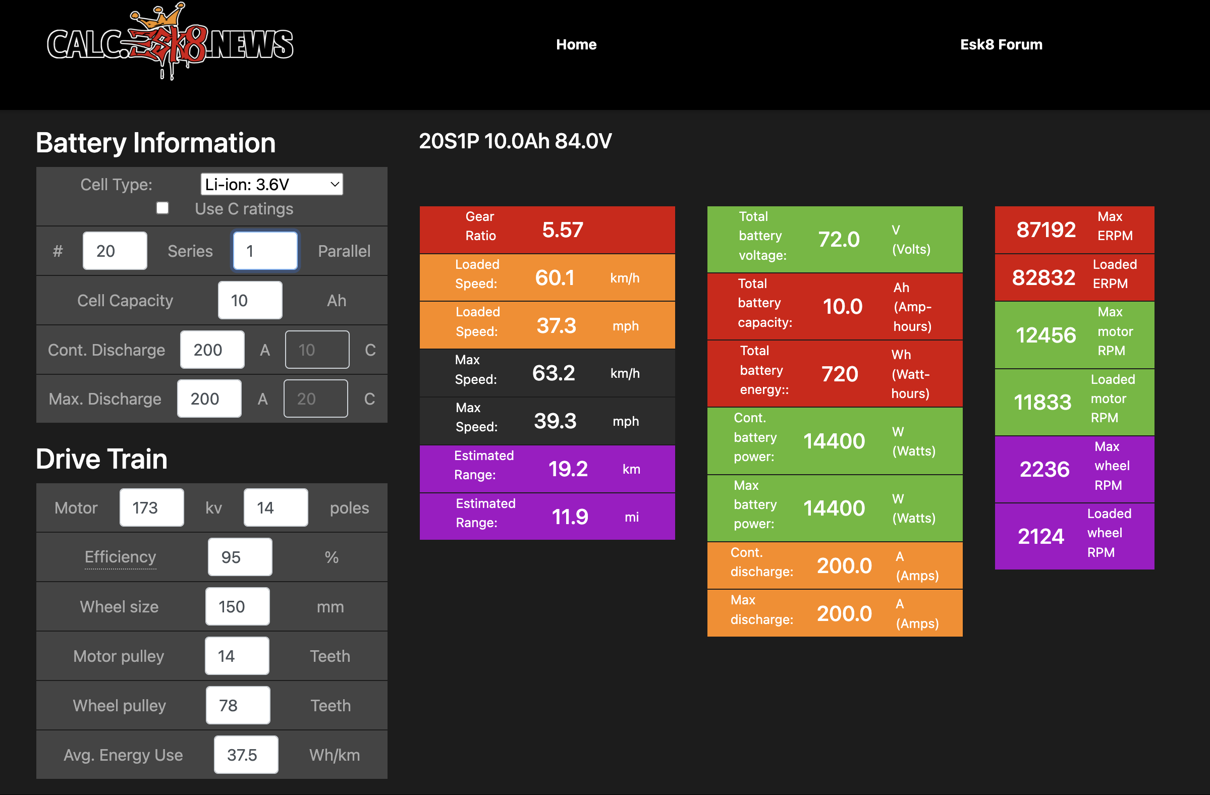

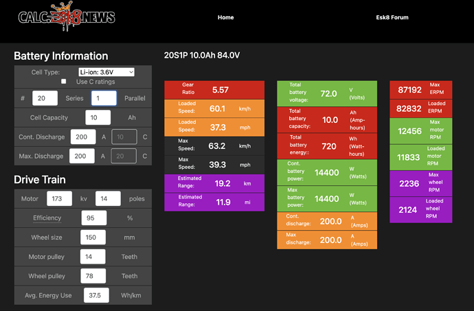

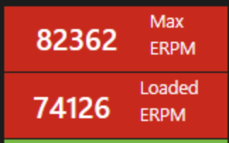

hrm, so is my setup acceptable erpm range for these skp 6385 173kvs? with respect to Iron losses? or am i in an ineffecient range for these motors? i suppose doing the no load test will help know more about that.
You are a bit high for sure, but not like completely unacceptable. The manufacturer says 12k RPM max and you are right around 10.5k loaded…this is more of a bearing thing iirk
I’m not an expert but it seems reasonable to me.
The real answer though is found by how your setup performs in real world riding:
  1. Do your motors hit 85c after 3 laps at the track?
  2. Are you getting worse than 50wh/mile efficiency?
If both answers are “No”, I think you are doing fine with regard to iron losses.

When you first do motor detection and set the wheel size and gearing, it only gets applied to the primary esc, you have to set any secondary escs manually… i assume that’s what you’re seeing there
ah, you’re mostly right. The two were different. I manually mistakenly put in 14.333 in one of them for gear ratio rather than 4.333
good catch. thanks.
